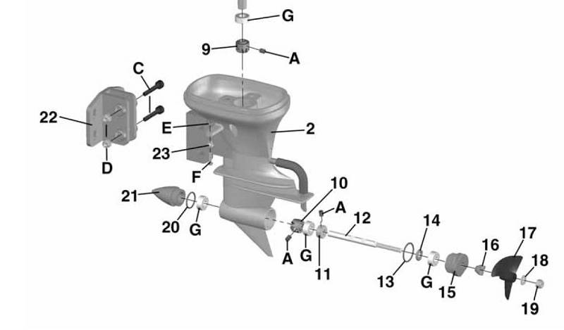

I am thinking a nitro conversion would be interesting. It would need to have a mount fabricated, and possibly gear upgrades or standard propshaft...but what size engine would you put on this?
With the lower unit in stock form I was thinking an .09? I have a throttled Cox .09 I wouldn't mind seeing in one of these. Not sure. A .15 was mentioned for comparable power, but could the lower end take having a .15 nito added? If that is the case, the Cox .15 would be even cooler.
Are the gears metal to start with or are they plastic? Would there be any type of RC Car gears around that would be steel and work good? Is the down shaft a flex or is it solid? What kind of end does it have to think of a coupler and flywheel.
It would be nice to have one on the bench to see what would fit up to it, maybe even using a K/B 3.5 propshaft assembly to start with.
Does anyone have pics of the parts or a discription of these that could help?
I wouldn't mind going out of my way to build a decent unit even if I had to customize a few off the shelf items to do it.
I think the size of it fills a hole, and I have an engine or two I wouldn't mind seeing used in an outboard.
