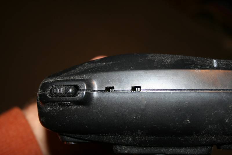

how do i reverse servos with this controller??
http://www.horizonhobby.com/Products...ProdID=PRB8040
its for my SW36 electric conversion, i installed a faster and strongr servo for the rudder, but it was doing in the wrong direction, and theres no servo reversing on the Tx...
EDIT: and get this, the description says that it has servo reversing switches, BUT IT DOESENT!! how messed up is that?[:@]

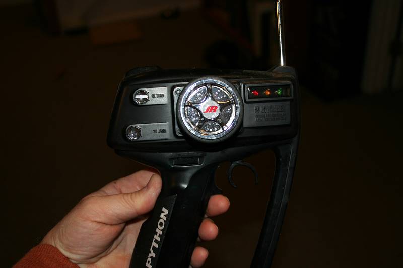

I have that radio and if you look on top of it you will see two small holes and down in those holes are two switches. You will need something very small and strong to switch them like a micro screw driver. Here is a picture of the top of mine. If you can't get it to work I will sell you mine. It will come with the radio and RX crystal and TX crystal. The receiver got burned out a long time ago and I don't use it.

already figured that out after a call to horizon....thanks anyway...
