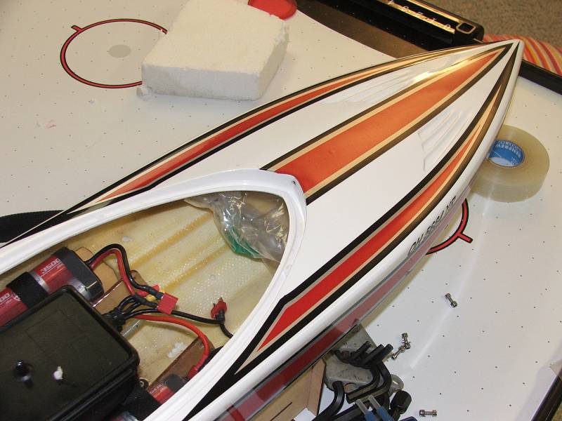

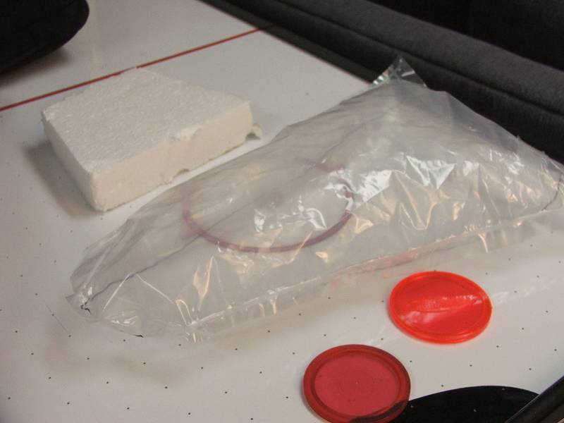

Well we have a really nice bag sealer at work, and the other day when we got a package I saw how they use bags of air as padding. No sence moving unnecessary weight. Ship air when you can. Well I think that applies to us too. This is a prototype. I think I'm going to put some peanuts in it just in case it gets punctured but these bags are pretty tough. I figure I can get at least 3x the volume up in the bow with this and with less weight. I'm going to put some seperate bags in the stern and removable ones in front of the battery trays as well as something to make the canopy float. No more sinking for me.

I would be worried about the day that you have that really bad crash and the batteries come flying forward and pop your bubble, pardon the pun
I would use that spray called "Great Stuff" it is very light and full of air. But be very carefull and do little spots at a time because it expands. Just start by spraying quarter size spots in the tip if the bow and wait till it quits expanding and then add another spot and keep going till the desired amount is in.

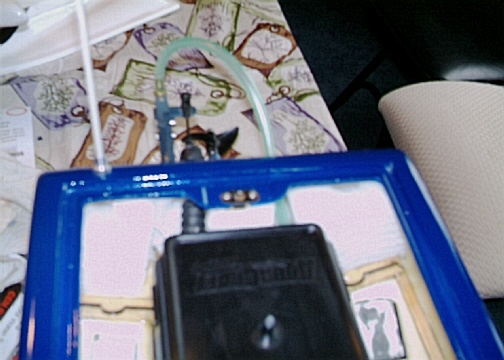

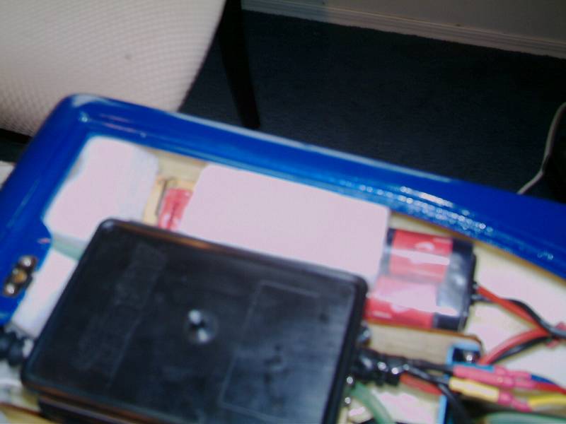

This is a good thread. It should be added to that sv owners page. I find myself looking in there a lot. Sometime I got a question but the search feature dont work so hot so its hard to find things sometimes.
I flipped the blue boat 2 times and both times water got in threw the lock. Do you guys have any thing you do besides taping the whole lock aria to keep water out? Its the only weak link now.
Here is what I did for floatation
Under the rear of the boat it just cut tightly and stuffed in.
The battery hold downs are cut tightly and stuffed ontop the batterys.
Under the top/cowl all siliconed in with 100% silicone.
Under the nose is the stock floatation.

The answer to the hole from the latch would be to epoxy it shut. Put some tape on the outside then put the epoxy on the underside, when it dries take the tape off and touch it up with some paint. I will be removing my latch also as I don't use it and I think it sucks. Besides if people are taping their hatch like they should they wouldn't need a latch.
