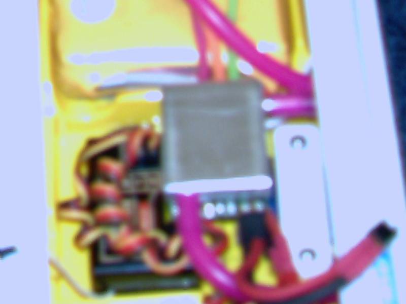

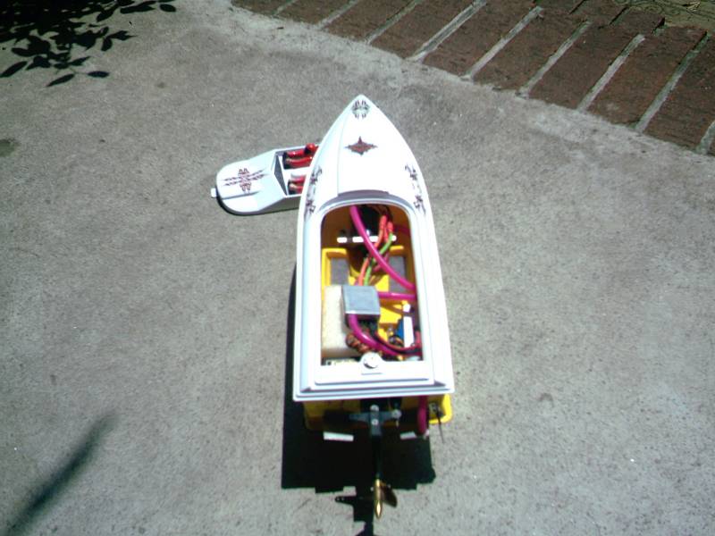

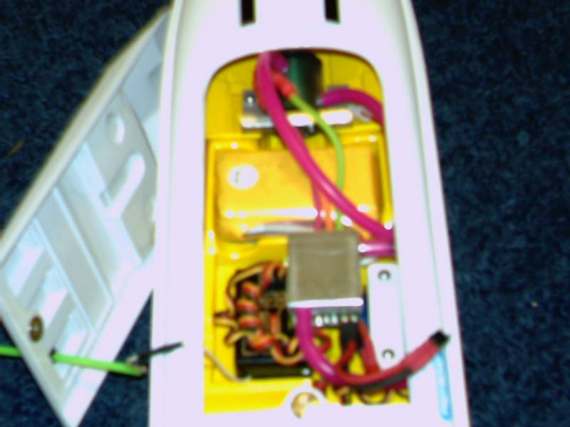

same motor 33amp cont. lots of water cooling started at 3c down to 1c I think 50mph is a little to fast

Very nice work animalnut, what motor is that and where did you get the water jacket for the motor?
Put your camera in Macro mode, those pictures are blurry

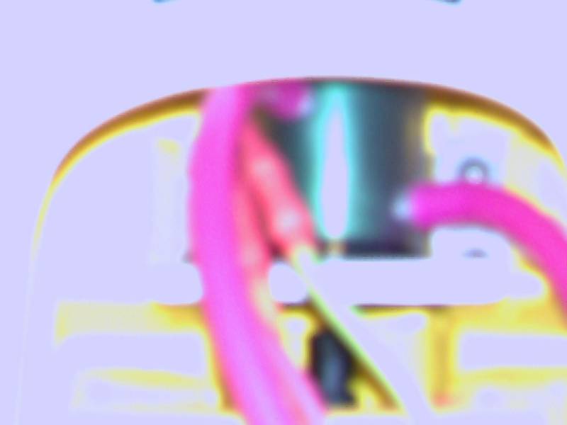

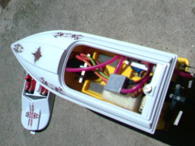

sorry about the pics but it is a6800 and the water jacket is solid fish tank tubing and o-rings and a 3c lipo will give you a high speed run that will make you nervous it just took a little time n patience but smallest and fastest micro v iv,e seen
