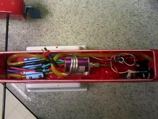

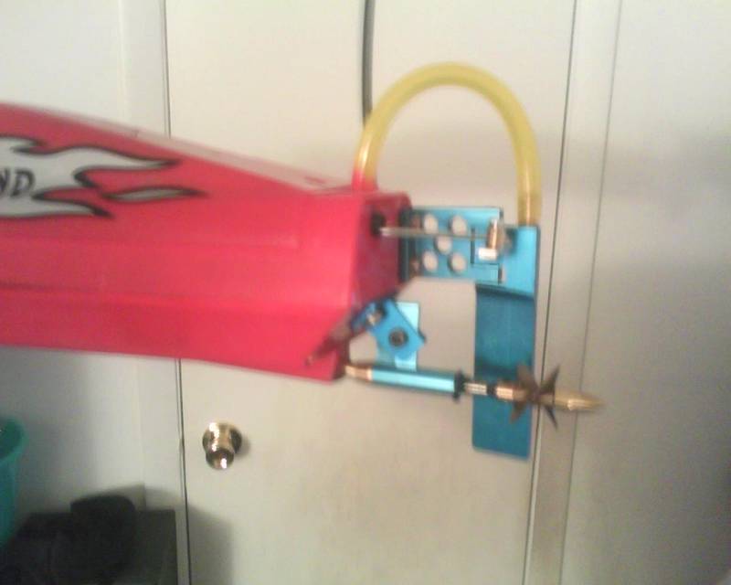

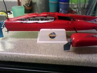

so i got bored one day..........bought a arrowwind on the bay for cheap..ran it stock for laughs mostly,then went home and ripped it apart....installed a feigo 12 s 380 brushless and a team orion captain 45 esc with supervee cooling plates installed..micro servo 3s 2200 lipo and mini cat racing micro hydro hardware...130 flex with a 632 prop stolen from my renegade..

That didnt tur out too bad good job. I hate nqd boats tho

Wow, looks pretty good.
I was gonna go for the same idea myself with an SV27 system[sm=rolleyes.gif]
Is that rigger hull strong enough?

yeah the plastic hull is strong enough, turns out it's a clone of the graupner silver bullet. Needs some serious water-proofing though - must be taken apart and all the joints siliconed. Also the stuffing tube comes out at an angle. This means that the boat bounces up and down at the rear. Either a strut or a bent stuffing tube, as the silver bullet has. Strength isn't a problem...once waterproofing issues are solved and ride-pads have been stuck on - it's quite a good intro into riggers

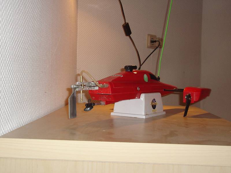

ok - so finally i got the rebuild finished. I installed a walkera 380m 3200 kv motor, 50A towerpro watercooled speed control, 4s lipo, homemade rudder and waterpick-up, bent stuffing tube (to do away with the strut), graupner turn-fin. Video soon i hope.

Default RE: brushless nqd arrow-wind
loks good man..try running it without the turn fin and see what happens..even though i show one in pictures i run it without and it handles much better.
Old 03-23-2008, 01:08 PM
Stokes
Stokes's Avatar
Join Date: May 2006
Location: Wellen, GERMANY
Posts: 273
i've run a roundnose hydroplane without the fin...and it's quite entertaining, boat kinda drifts - you've got to leave quite a bit of room for understeer. i'll try leaving the mount in and unscrewing the fin itself, it's one of the graupner flyback ones, so that's easy - worth a try! on closer inspection it turns out the prop's missing quite a big chunk....oops! hope the motor bearings are ok....
now as regards props, i tried a couple out, and here are the results:
30mm low pitch - cavitation, boat slow
34mm high pitch - not enough revs, boat slow
35mm high pitch - turns out is a left-rotating prop (the idiot! - ever seen a rigger going backwards?)
32mm medium pitch - fast acceleration, low top speed
34mm medium pitch - slower acceleration but decent top speed, as seen in the video
38mm, low pitch (eco type prop) - faster acceleration but slower top speed.
the results from the first four props make sense i think, but the 38mm has me stumped. It looks fairly different to the others but seemed to work quite well. Can't understand why boat went slower though....will try more rigorous testing to find out.
