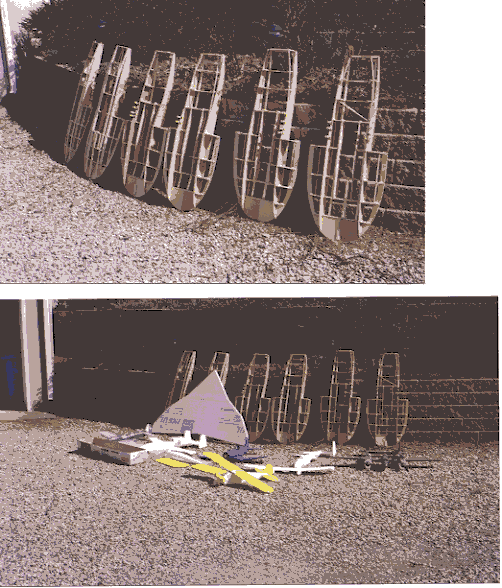

I am finally back to finishing the (6) 48" dropped sponson hydros. Hull alone is 6 lbs. I have 10 ..2.2 amp. Dewalt cells, A Novak Super Rooster ESC that handles a car battery with a 41 # thrust trolling motor easily.
How little power will a ready to run 10 lb. boat need to run surface or submerged at 20...25... or 30 mph ?
I probably will need to buy from Hobby City in China.
Money is a big problem with 6 ESC & 6 motors. I am using the seperate Octura flex drive shaft & seperate rudder setup.

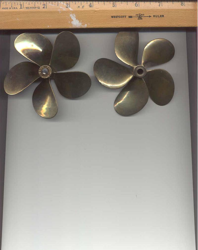

Thanks for helping out as I have no experience or anyone to go to on this size. The cells are Dewalt LIFEPO4's. Loafing at 20 C. No fires under any loads or charges.
RTR will be 10 to 11 # .
Novak is a brushed unit.
It handles accidental reversed hookups very well. 2 X.
What a flash the poor circuit breaker must have endured.
I have some Prop Shop props from England. They are 5 bladed bronzes of about 4 x 4.5" pitch.
2 lift my 72" WW II PTB in about 30' after WOT, from a dead stop. It weighs 60 lbs.
My boat experiences are useless on the hydros.....Try to post the props
