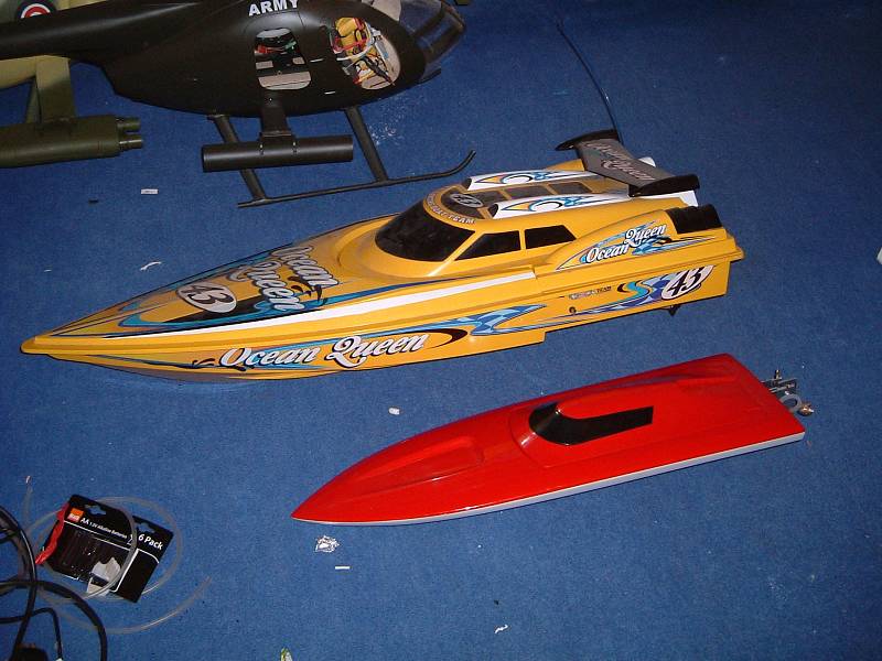

Looking for a bit of advise.
I have a light 40" plastic hull which is crying out to just see some water.
It has been drilled for an underwater prop.
What sort of rpm should i aim for?
obviously less than subsurface props.
I've lots of motors and escs and cells etc.
Aiming for about 30mph.
thanks.
Brod..

That hull looks a lot like the Graupner Giant Racer https://shop.graupner.de/webuerp/ser...2025.200&PIC=4 , now discontinued.
In order to get that hull up to speed, you'll better do some work on the hull; sharpen all training edges on the step and transom, stiffen the hull internally, as the Giant Racer hulls I have seen, were way to flexible to run reliable at the speed you're aiming for.
For a submerged drive, the 20.000rpm at the prop are a good starting point.
Motorwise you could look in the KB45 series from Hobbycity, read the customers comments to get an idea how these motor perform: http://www.hobbycity.com/hobbycity/s...hless_Inrunner
Regards, Jan.

You would be much better off closing the hole in the bottom, and using a descent hardware setup and a surface drive. It would be MUCH easier to get the speeds you are looking for that way.

Basically a surface piercing drive is faster, the work needed on the hull is about the same, so the choice is up to Brodjack.

Yes,spot on Jan,3 holes,well a bit more than holes,sortof moulded plastic underside holes.
Thats why i thought i'd keep it simple with a submerged prop.
It oriiginaly,a few yrs back,had 3- 600 size? motors and a very poor electonic speed control which didnt last long.We ripped out the electrics,the middle motor too, and fitted 2 esc's which ran very hot with 10 cells.The boat actually ran quite well,looked good too.But 2 10 cell GP 3300's didnt last long maybe about 4-5 mins.
I thought a single large brushless with a decent maybe 6s lipo would be much lighter and therefore quicker.
I'll see what my LHS has in with couplings for a 6mm motor shaft.
Is there such a thing as submerged metal props?..
I'll probably send for that big motor that was highlighted.

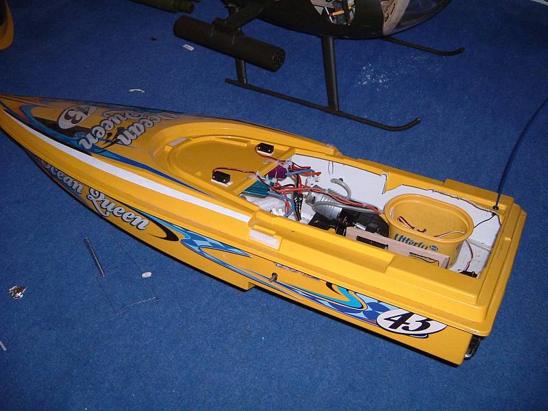

Just found an old pic of it,remember my very first boat[X(] complete with a margarine tub for radio box!
The boat surprisingly stayed dry inside.
I think i can do better now
Brod..
Brod..

Keep in mind these KB motors are rather amphungry, so a 'cheap' 6S Lipo is out of the question.
Also watercooling is a must, not a tiny aluminum coil around the can, but a fullsize coolingjacket, covering the entire can.
These can be bought, or home made, I have a 'tutorial' and some pics, showing how I go about it.
I wouldn't go for metal props as yet, find the right size and pitch by trying some Graupner K-series twobladed props, I know, these are officially surface piercing props, but I've been getting good results with them, as they are much stiffer than the plastic ones.
Start with something in the 37,5K, 40,5K size and work your way up, keeping a close eye on the components temperatures.
J.M. has a valid point in the surfacepiercing suggestion; as the hull is stepped, it will draw air under the boat.
As the suggested powerplant will allow the boat to run a lot faster than stock, the aircushion under the hull may become a problem when it reaches the prop and rudder.
If you use an K-series prop, the propulsion may not even suffer a lot, unless there's a massive amount of air drawn underneath, but the steering will.
Some time ago, I've been running a 30" stepped hull as a motor testbed, with a subsurface prop (Ø 40mm). On 12 cells and a 700 motor the speed was quite ludicrous, and the steps worked fine and left my rudder standing in a pocket of foam, behind the prop. My input from the transmitter was ignored completely as the boat raced towards a brick wall..., only a substantual reduction in speed, dropping the hull off the plane, gave me back steering control, just in time to avoid a collision.
Quite a heartstopping experience...
I expect your 'rather distinctive' step will have the same effect, so beware. (My testhull was polyester, quite solid, your ABS hull will disintegrate on impact...)
Making it a surface piercing drive would avoid such steering issues. (but would require another KV, aim for 30.000 rpm for such a drive)
This one would actually suit: Keda KB45-11L 1649kV 70A Brushless Inrunner, at 85% efficiency on 6S would be around 30.000 at the prop.
