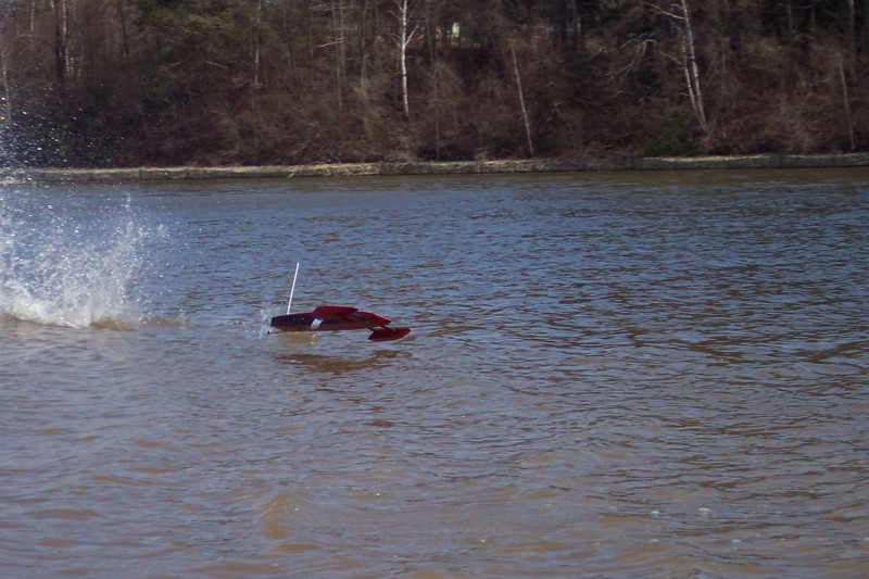

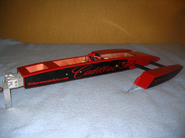

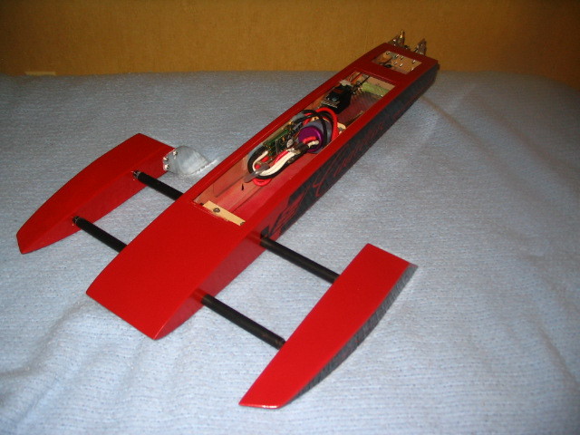

Old 01-04-2009 | 09:18 PM
Joined: Jul 2008
Posts: 690
From: , MO
Default RE: pics of the Rigger Insanity
Or it looks as if you have the mini rudder on it.
Jake

Old 01-04-2009 | 09:24 PM
CadillacDTS2001's Avatar
Joined: Oct 2005
Posts: 6,449
From: Tottenham/Orillia, ON, CANADA
i might have a mini rudder. I am not sure. I pulled the stuff out of a drawer ! LOL
but they will all work.
i just use a standard servo for the rudder. nothing special
