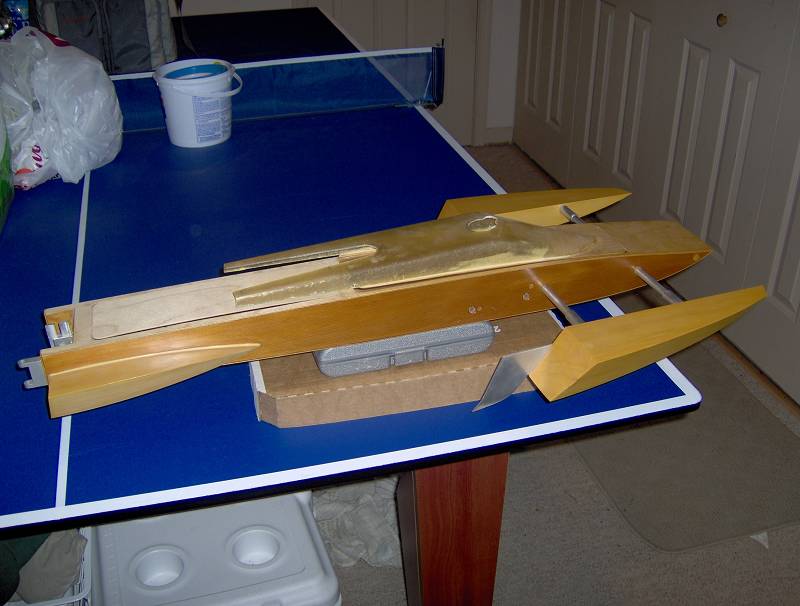

detox, I used Z-Poxy to seal the inside of the tub...on the outside, I will be applying 3 coats of sanding sealer. I am a painting contractor and have been finishing wood for years and this stuff seals and sands very nice. Much easier to sand than Z-Poxy. Next I will prime, spot fill, sand, prime, sand and then if everything looks ready...paint. Here's pictures of my Avenger/Spider that I sealed the same way...

Default RE: pics of the Rigger Insanity
Hi Jake,
You're stuffing tube seems to have a sharp bend in it. I guess it will work out ok though. I tried to keep mine as straight as possible with just a gradual bend to keep the friction down to a minimum .
