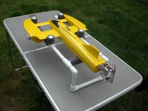

My first run with my new Octura Y535, I made some new rear sponsons because I think I needed some more lift before the prop upgrade. I think I need to take off the rear sponsons because it looks like it has to much drag still. Just give me some opinions of what you guys think I should do. Thanks, Chris

Show us a pic of what you added please and maybee we can see what the drag issue is..if they dont have a very sharp front edge they will def slow things up...and definatly get the prop sharpened and balanced..theres a thread in general boats or maybee speed nitro that will show you how to do it yourself or take egneg up on his kind offer....
Ryan you said your electrics are significantly heavier? than your nitro's??I would have expected the oposite...if so and im not doubting what you said I agree with all of it by the way. there is a distinct balance differance from O/B to I/B and yes a coresponding differance in rear sponson shape and size and I totaly agree an O/B rigger will not be competitive..comes down to weight and drag doesnt it??? anyway why are the electric riggers running so good with no rear sponson or ride pad if they are heavier??? doesnt make sense to me..you would have to move everything far forward to get descent lift off the back and that should weight the nose down to bad..or are the front sponsons on the electrics oversized to compensate?? all i have seen seem to be pretty large front sponsons....enlighten me please?
Egneg are you running a high lift prop on it? nice boat by the way love the color

On my 2s1p rigger, my lightest electric setup most comparable to my old .18 powered rigger- weighs 3lbs 2oz. Weight at the prop is 4oz. The prop has to lift 4oz of weight in order to lift the rear up. That is due to c of g placement. The strut is a flat bottom hydro which also aids in lift.
I custom build or setup my riggers so that the battery packs CofG is placed ahead of the Cof G for the boat. This means a heavier pack will bring the hulls CofG closer to the front.
In order from front to rear placement of the electrics is as follows
Batteries
ESC
Motor
Radio/Servo
On the nitros I set them up as
Fuel Tank
Engine
Radio.
When the tank was empty CofG would change rearward. The pipe/motor/radio equipment would weigh the hull down in the rear also effecting CofG. Not sure how they currenly setup nitro riggers but thats how mine were setup.

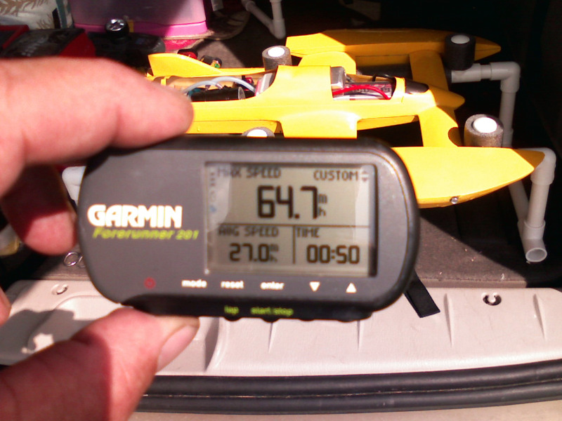

Just for reference my old .21 rigger weight around 4lb 7oz with fuel. My current 4s rigger will weigh in around 7-8lb. Still in building stages but these are the realistic weight goals. A well setup .21 should do close to 70mph. My 4s hull should be able to exceed 70mph.
Ryan

Ok you are doing exactly what I thought you were doing to get these to run like they are and as I thought about it Ifinaly had to admit my thinking on the battery packs as being lighter than the nitro engine and fuel was wrong...I understand better now how your getting the back end up without ride pads or even sponsons...I still think a simple small ride pad with the strut coming out of it his little rigger would fly and do away totaly with the rear sponsons..anyway thanks ryan for the info
