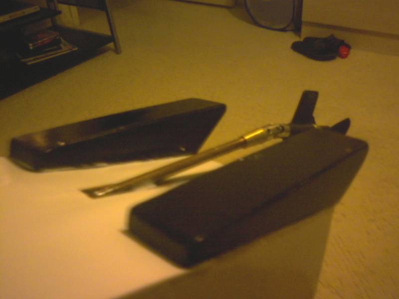

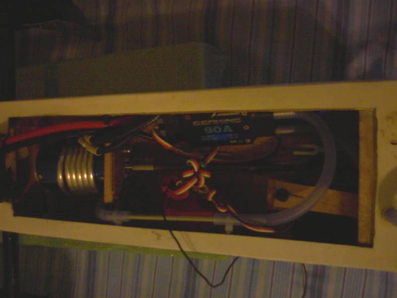

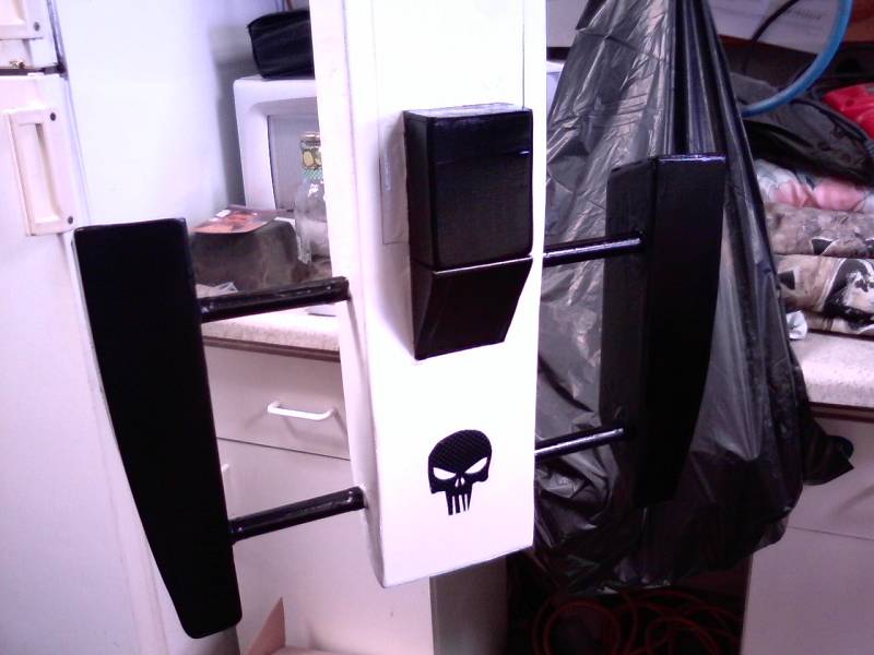

Today I just tested out my new outrigger that I built and I am having some problems with it not coming out of the water. It has a watercooled XL-5 and a Trinty 12t Speedgems extreme motor, and I run it on a 6-cell NIMH. My prop is 31mm not sure of the pitch. So the problem Im having is when Im in the water and give it full throttle it kind of drags in the water instead of skimming across the top. Any help would be very helpful!!!!

Need to see bottom of hull..and better side shot so we can see the angle the outdrive is at in comparison to the tub and sponsons....looks like the boat is built heavy in the close up of the transom looks like alot of glue and hevay paint there..wha t does the hull itself weigh???

Its very light, its made from balsa wood and the sides are made from panel board. The heaviest thing in the boat is the 6-cell NIMH. I also have the pitch of the strut set to the positive way so the nose gets up out of the water, but its not working. I wonder if it is adjusted to high so the thrust isn't strong enough. Im not sure, I just got into boats a few weeks ago so please work with me.

RE: Problem with Outrigger?
A couple of quick fixes that might help.
1) Change the angle of the prop shaft to be parallel with the bottom of the hull, maybe even slightly down by about one degree.
2) The rear sponsons need to be planed/sanded off so that the front edge meets the hull without that huge step in it.
The rear edge height should be level with the center line of the prop shaft ( after you've levelled the shaft.)
3) The center of balance should be about 1/2" behind the trailing edge of the front sponsons.
Move the batteries around to achieve this.
4) It's best if you can keep all edges of the front & rear sponsons nice & sharp, not rounded off as they seem to be at the moment.
This reduces a lot of drag.
These are just basic starting points & can be fine tuned a bit after you've got it up & running.
With a bit of work I'm sure you can get this little rigger to perform.
Hope this helps a bit.
Paul.

my cousin told me to hack off the rear sponsons and see what happens!........ the boat actually gets up and out of the water now!.. still have to mess around with the strut to get it dialed in, but im in the neighborhood.... thanks and i'll post the results .

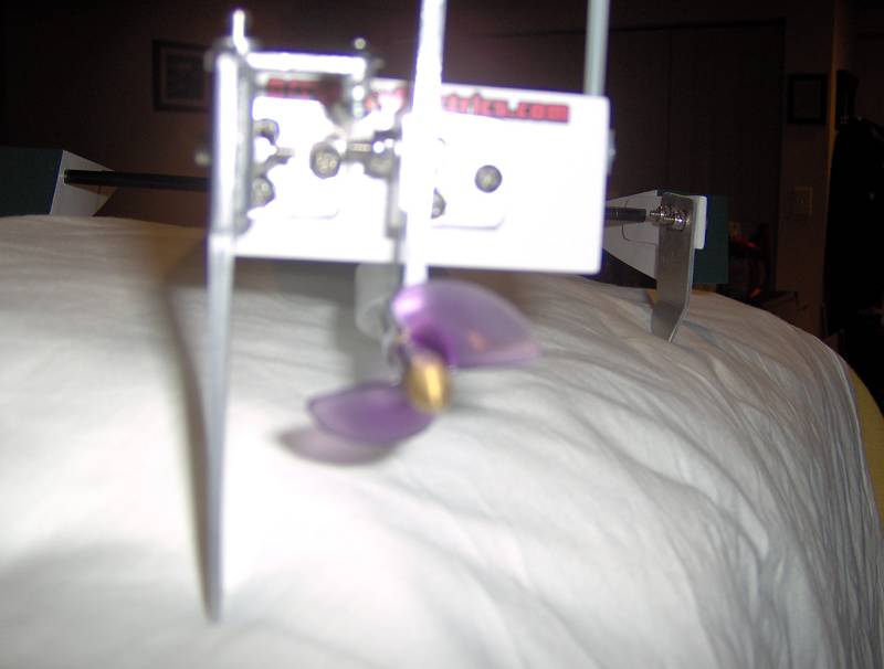

You DON'T need rear shoes or a ride pad on your boat! You also need to get rid of your outdrive and add a strut instead. Either a wire drive or flex will work for a shaft (3/16" stubshaft stepped down to 1/8" to run smaller props).

DUDE a plastic prop?????seriously???????im trying to get this guy good advice so he can get some speed out of it....you CAN NOT be seriouse about speed and run a plastic prop..thats for play not for race or speed...they flex to much...all that aluminum hanging on the back adds alot of weight wouldnt it be better to have a small lightweight piece of wood on the bottom with the stuffing tube mounted in it and a small rudder on the back instead of 5 inches of hanging heavy metal??? go read all the threads on here about riggers dont take my word for it look for your self all these people cant be wrong...and I havent said anything they arent going to say.........I have a theorie about why your eelctric rigger runs descent without any rear sponson or ride pad even with all that heavy metal action on back you have save dso much weight with the ellectric motor and battery esc combo it just plain doesnt need as much flotation to get it up..But what would it do If it had just a little extra lift on the back???? you should just play with that and see what happens..your riggers look nice by the way did you build them from plans or a kit??
TRX I picked up a rudder and strut thats perfect for these small electrics from a guy on e bay...joechung I think is the name of his store Ill check and make sure I bought 2 rudders and a strut from him for a 1/2 a powered nitro boat very nice stuff and very resonable as well..also another guy on e bay top secret boats they have realy nice hardware of differant sizes but kind of pricey...Ill go snap a couple pics and post em here for ya...later!!!

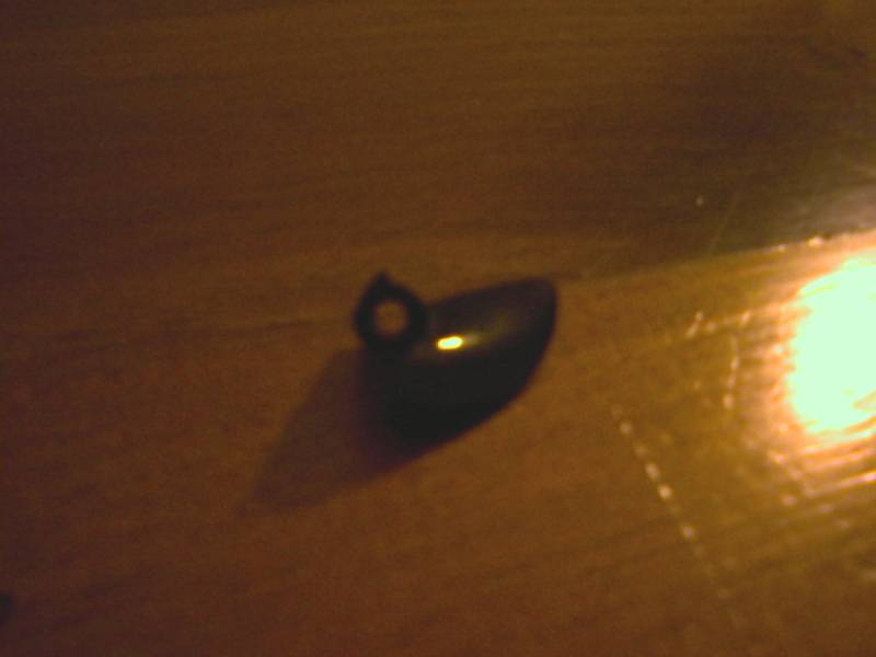

I finally got some time to test out my rigger with my brushless setup and it screams. There were a few things that went wrong during the run. I not sure when it happened but when I went to take my boat out of the water and move to a different spot I noticed that the turn fin was missing. I must of hit something when I was going. I also broke my prop today, do you guys thing it was the high RPM that made it explode or does it look like I hit something? Anyway it was a good run, I lost alot of speed once my prop broke, but it was still pretty fast even with one blade. Thanks for all you help so far!!!!, Chris
Join Date: Jul 2005
Location: Hamilton,
ON, CANADA
Posts: 5,522
Received 6 Likes
6 Posts
If you have prop damage bring the hull in before it causes strut damage due to out of balance. Sounds like power may have busted the prop. Change to a metal one. They are cheap enough if you can follow directions given to balance them.
