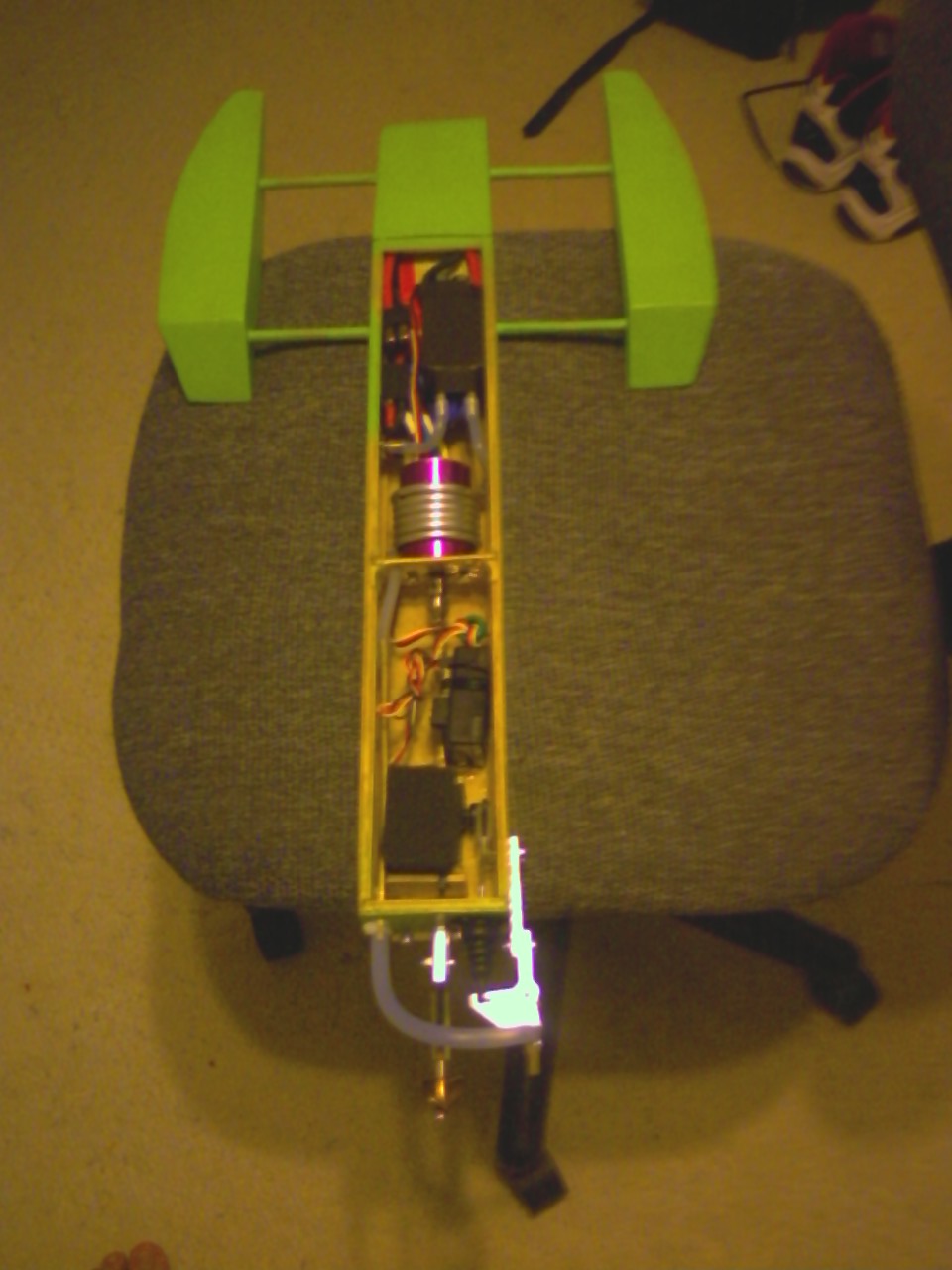

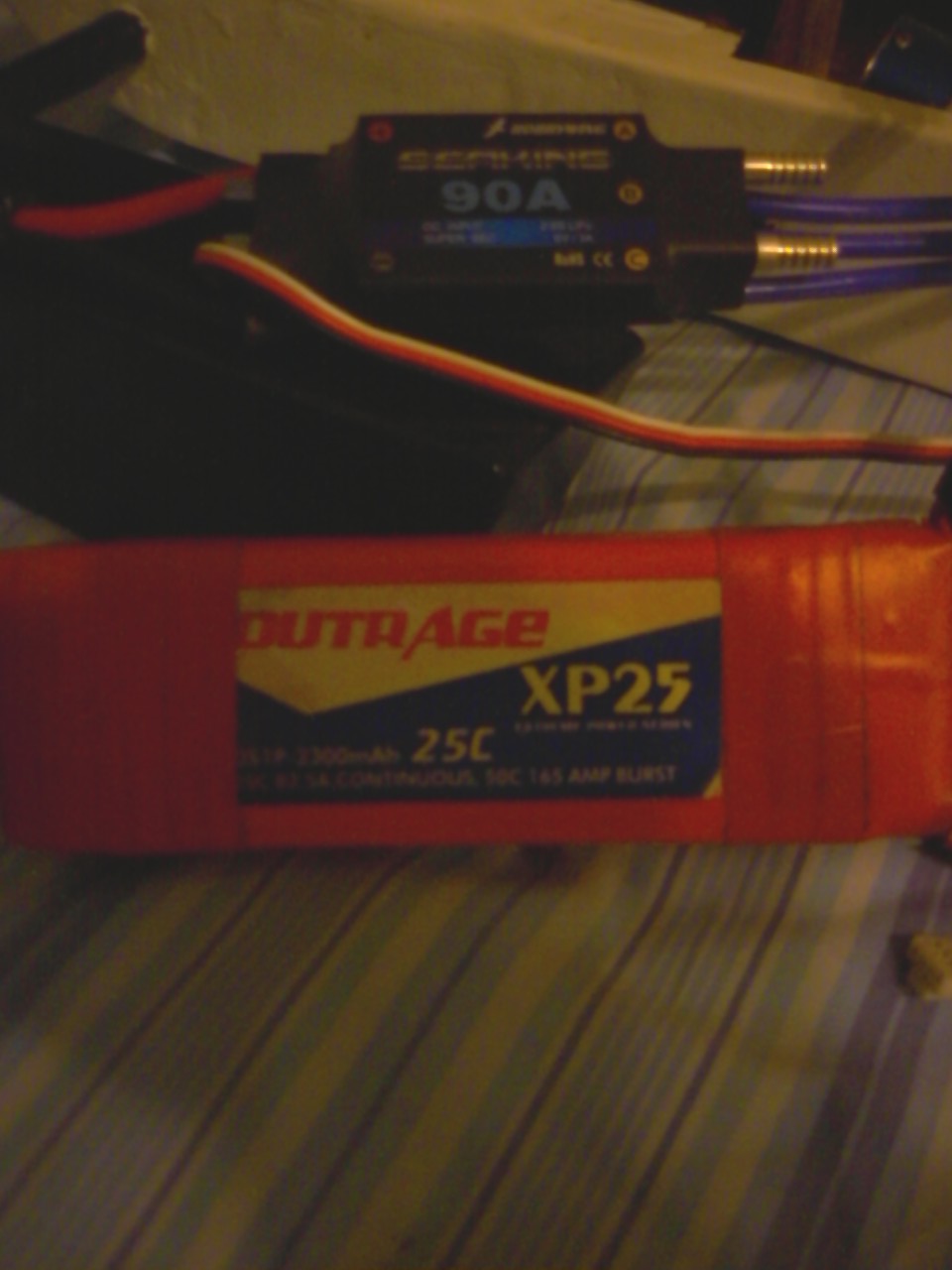

This is what I have done so far, I just picked up my last part today and am ready to do a dry fit of everything. I have all the wood sealed with thinned epoxy inside and out. My set up is Feigao 540 10s, Seaking 90a ESC (been having problems with the lipo cut off so ordered a Novak smart stop), 3s 3300 mah 25c lipo, Proboat 31mm prop. I hope the first run goes really well. Any comments you have or anything I should change just leave a post.
Thanks, Chris

Thats about 45,000 rpm [X(] !!! whoa... just check temps often on first run. Do you have any 2S packs to try first???
Those are SAW rpms...
31mm prop is good for the hull but, 45000 rpm... ??? no idea... might snap on you if it's plastic...
Bring fishing rod with a tennis ball for boat retreival... regardless of setup...

I thought the 540 10s had a kv of 3549 ?? On 3s that's only ~35000 rpm under load

3549 x 11.1 nominal is 39393.9 rpm Fully charged 3S is 12.6Vdc 3549 x 12.6 = 44717.4 rpm This is SAW rpm You can run, just be careful.
Now 8.4Vdc 2S fully charged, 3549 x 8.4 = 29811.6 ... A nice rpm where you can use a few different props.
You could always get a new motor like a 380 12L 2,408 RPM/Volt 1/8" Shaft.
If I knew your boat was the size it is before you bought your motor, I would have suggested a 380 can.

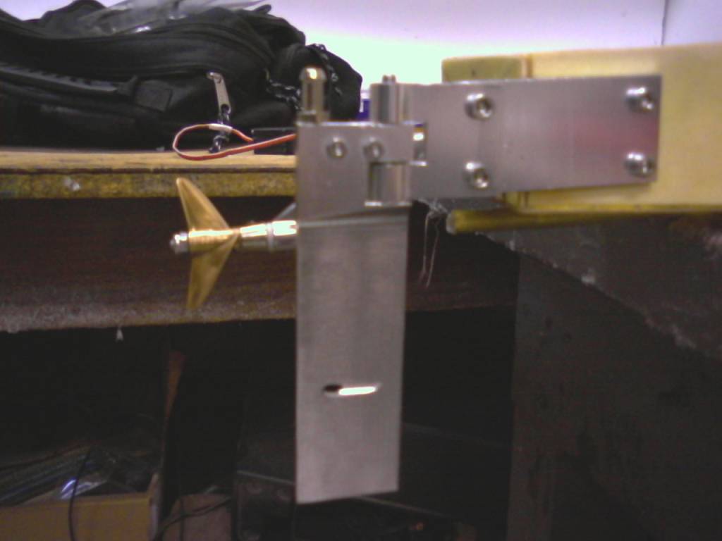

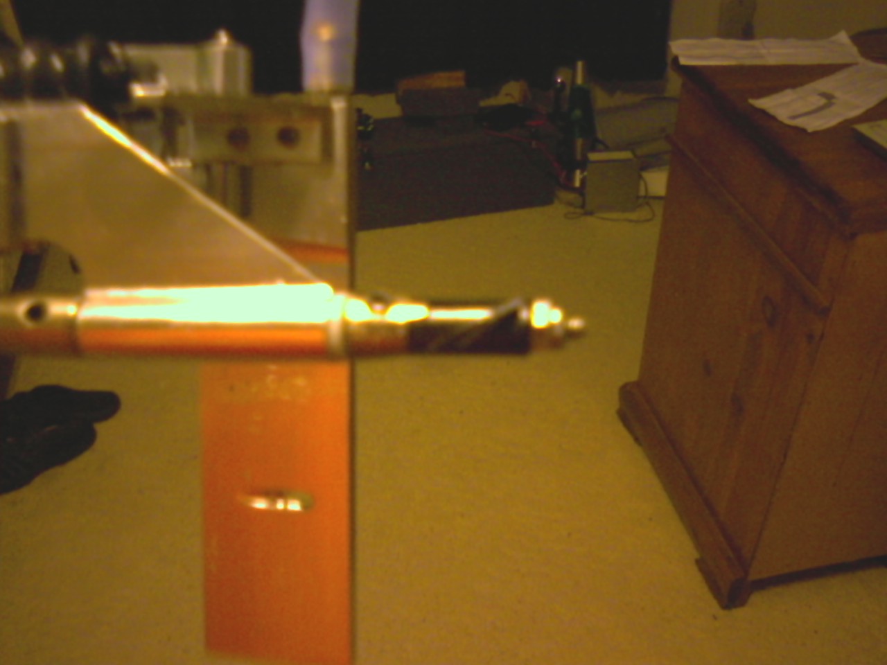

Just installed my running hardware, its from the boat The Widow maker I hope the strut will work. I have my servo mounted and stuffing tube installed, I just need a new flex shaft. I had one but I tried to cut it with side cutters and it started to fray and it came undone. How are you supposed to cut a flex shaft? After I have everything dry fitted I will start the painting process and I hope it comes out nice because I am not the best painter but we'll see.
Thanks, Chris

I just use strong scissors. (Clippers) Then I file down the end, solder it, then file it again so it's smooth and won't unwind.

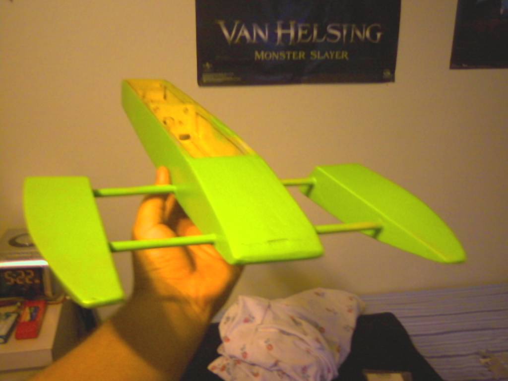

Just painted, I still need to clear it. I don't think it came out as nice as I thought but it will look good on the water. The paint really shows where I needed to sand, but its too late for that. I am too excited to see it run so that is why I am going really fast with it.

Have everything installed, just need a flex shaft.
