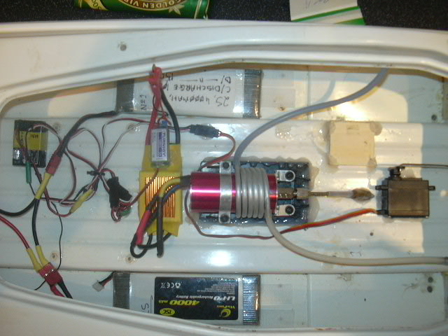

i use a 12XL 1400kvin my 30" cat on 2x 3s lipo and it shifts, well it did before the rx gave up (at home thankfully while testing range) so ordered a 2.4ghz setup and waiting for delivery

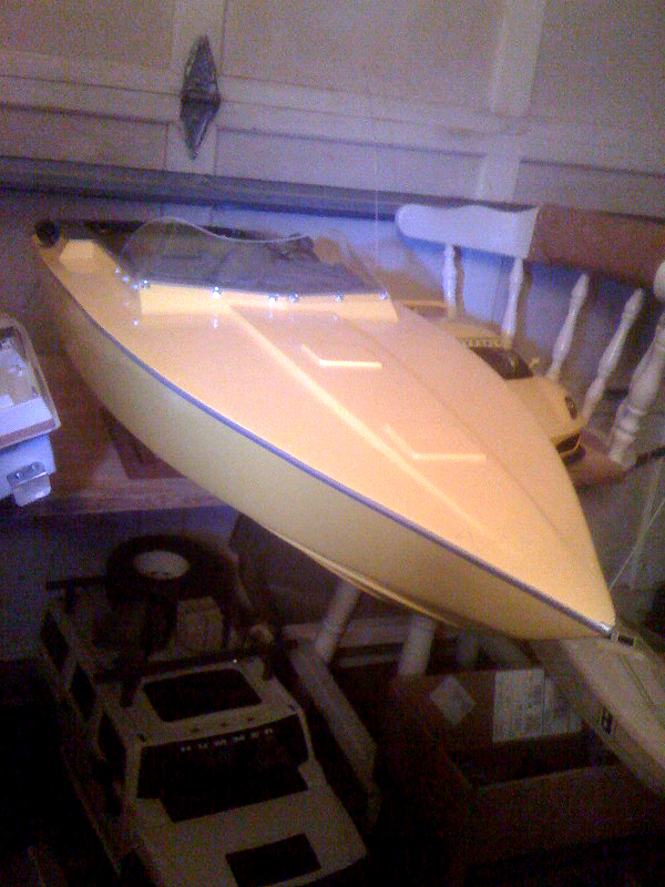

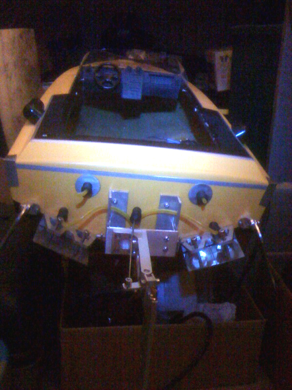

any pictures of that setup?
Old 01-03-2010 | 12:41 AM
rebuilder's Avatar
Joined: Jan 2008
Posts: 1,917
From: Ark, AR
Default RE: kb45 setup
yep

wow does that rudder sit low!
Old 01-03-2010 | 01:32 AM
rebuilder's Avatar
Joined: Jan 2008
Posts: 1,917
From: Ark, AR
Pic is deceiving...................................I'm beginning to wonder if you have any slightly positive comments in ya...............pickin me to death.?

i got the kb45 12xl, 1400kv in my 30" cat, aint had her on the water yet as its still freezing cold here, from what i have read (and on the motor mod) i'm going to remove the shims and see what happens, but my speedo does get rather warm, its a pentium 100a esc
Old 01-03-2010 | 05:05 AM
Joined: Jul 2009
Posts: 890
From: clevedonsomerset, UNITED KINGDOM
i knocked the rear plate of the can (hold the motor in your hand and just tap the shaft with a hammer) when the magnet assembly comes out, you have 3 brass shims at the rear and 2 brass shims plus a nylon thrust washer at the front, take 1 shim from the rear and replace with another nylon thrust washer, put the plate back on and tap it home (lining up the shaft with the bearings)
On the bench, it runs a bit cooler so the next step would be to drill out the plates for ventilation
its a shame the shaft is'nt longer so you can put a fan on the end to draw heat away along with the watercooling jacket
