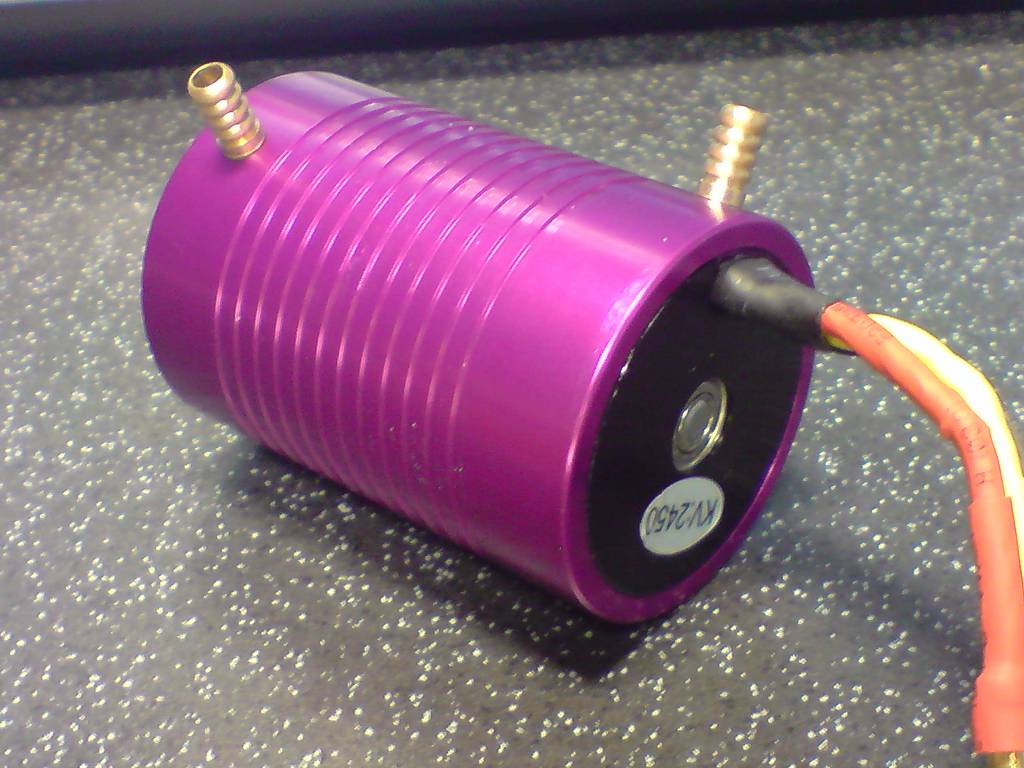

heres the motor for the 4s version of the hor 25, its 60mm long look at the coolerits the same length

thats completely different to the one i have, its 3/4" the length of the motor, has 1mm clearence between the motor and the inside of the cooler
