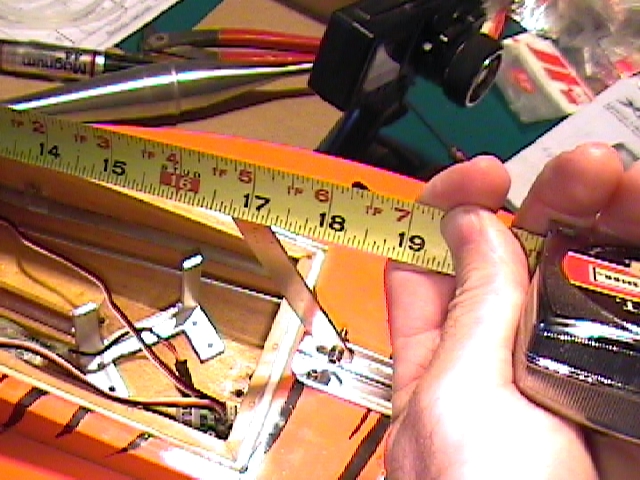

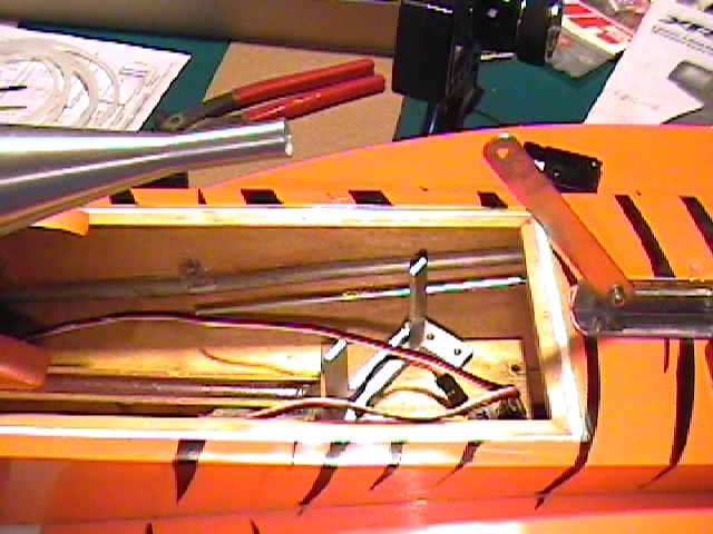

Here is what Im talking about pipe too short.

ORIGINAL: unclecrash
What is the distance from your engine glow plug to that mounting bracket that you show in your picture?
My O.S. 91, when set up with a "pipe length" of 12.5 inches, has a total length of 18 3/4" measured from the glow plug to the very end of the pipe. The pipe is a AA muffled 80/90 from Al Hobbs.
Just noticed your pipe is not muffled. A muffled pipe might get you the length you need...

ORIGINAL: Blackout
My O.S. 91, when set up with a ''pipe length'' of 12.5 inches, has a total length of 18 3/4'' measured from the glow plug to the very end of the pipe. The pipe is a AA muffled 80/90 from Al Hobbs.
Ya my pipe was suppose to be an unmuffled pipe 18in bought from Al Hobbs I have an email in to him to return it. Its not right he sent me a chopped pipe that only measures 14in total pipe length. I even asked him what the length was of the pipe before I bought it.

The pictures I posted I was showing Mike AKA Toyota Truckin how I got a bum pipe 14in and he said it was 18in from Al. Maybe he made a mistake I don't know. Im waiting to here from him.

Hey dave, if you end up keeping the pipe an add on muffler should put it right back to the mount, OR make a longer arm to reach back to the pipe I wouldnt move whats mounted the hull looks like its in very nice shape I wouldnt bugger up the hull with plugs unless its a last resort, work on your deal with al to see what happens before anything

Good news Al has sent me a message that he made a mistake and will be putting the 18in pipe in the mail. And then after running it I will add a muffler on it to save my ears
