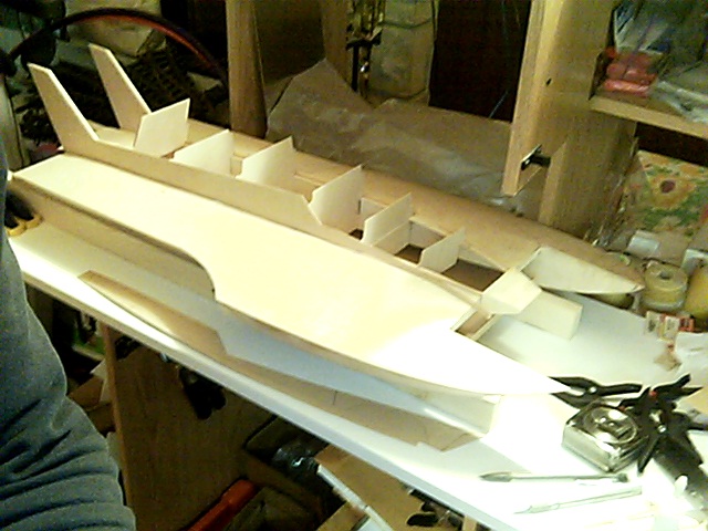

After several weeks of urging by other members of both this and another forum, I finally gave in and ordered a Dumas 20 sized Pay'N Pak kit and, rather than build it, decided to use it as the basis for a totally redesigned boat using nothing from the kit in the build. Upon opening the box, I found the usual Dumas garbage die cut 1/8 mahogany framing and the 1/16" birch skin. Unlike most of what I've bought from Dumas years ago, it was all surprisingly flat. I punched out the framing from the supplied sheets and went to work dry fitting the frames. Needless to say, I found little changed from when I built this boat back in 1982 except for the addition of 1/8" glue blocks added to the inside of the sponson insides. I decided right then that there was no way to make this into a boat that would meet my requirements so I began remanufacturing and reworking the parts into what I felt was going to be a much better boat. I've attached a picture of the dry fitted frame so you all would know what I started with

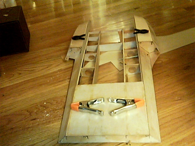

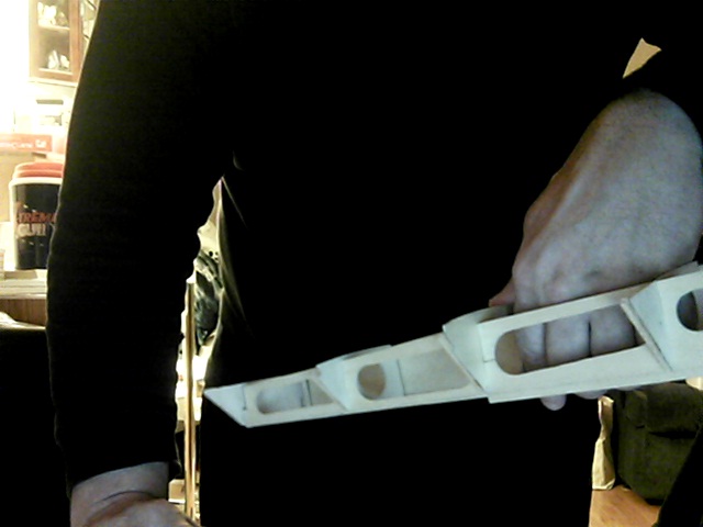

My first changes after tracing out the sponson insides onto 1/16" birch was to change the bottom of the parts. Knowing the kit was designed around a Veco .19, I felt that the boat needed to be able to handle the power of a newer engine design. I picked the Nova Rossi .21 5 port to rework this kit around, requiring a wider boat that packed less air than a stock kit would. To this end, I decided to move the bottom break aft from the sponson transom to frame 6 as recommended to someone else by Grimracer if I remember right. This had the effect of changing the bottom angle forward of the break from 10 down to 5 degrees as well as moving the primary pressure point of the bottom further aft, helping take weight off the prop at speed. After drawing the new bottom profile onto the the part, I decided that to decrease the amount of air under the boat it would be advantagious to remove some depth from the sponson bottom. I decided on an arbitraty amount of 3/8" to start with and drew that onto the part. This now cut into the factory air trap, requiring a redesign there as well. Taking my cue from a Roger Newton color sheet for the 1973 Pak, I scaled down the shape and drew it onto the sponson inside, including the air trap extension back to the bottom break. After removing all the now not needed traced part outline, I started looking to the transom. Here I had to add length to accomodate the transom to keep the boat at 30". I added enough material to allow the part to extend flush to the outside face of the transom and again removed the factory lines. I now realized I needed to make one more change, the height of the sponson inside at the transom. The kit has an incorrectly arced top, not the flat top of the full sized boat. This required reshaping the top of the sponson inside so that it still had a slight curve and yet matched the height of the engine bay wall. With all the outside changes made, I cut the redesigned sponson insides from the ply and set them aside while I worked on the transom. This was an easy rework. I allowed more space for the engine and pipe using a 180 degree header, totaling 4" of width. I then decided to widen the boat further for better handling, adding to each side of the hull an additional 3/8" for a total increase of 1-1/16" up to 8-13/16". To get an idea of how the new design compared to the old, I now made a widened frame 1 and dryfit the parts of the frame. Seeing that everything was looking good, I cut lightening holes in the sponson insides and frame 1. I decided at this point to take another page from the Roger Newton play book and made some additional frames, NONE HAVING THE COWL INCLUDED. I also deleted the center part of several of the frames to clean up the inside of the engine bay. I had to change the bottom of the sponsons due to the new depth and in so doing, the left sponson retained the stock diheral while the right sponson now had no dihedral at all. After getting these parts finished, including the new bottom profile and engine bay walls, I dryfit the kit and reworked frames to get this set of pictures.
I learned on my first boat to preplan everything and make allowances for changing as you go as every boat starts out one way and ends another. That's one of the reasons I hate kits is you can't easily make changes without having to fabricate new parts. I figure if I'm going to need to make new parts, I might as well remanufacture the kit. Here are some intermediate pictures I took to show how I've preplanned the build. The first two pictures show how the width was changed as well as where the engine will be located. The third shows the framing with some of the frames still needing to be finished.

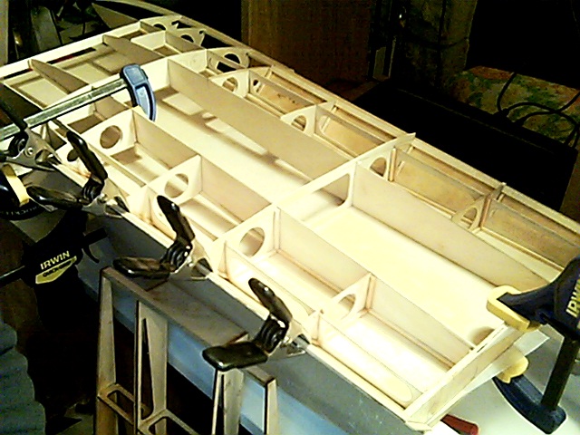

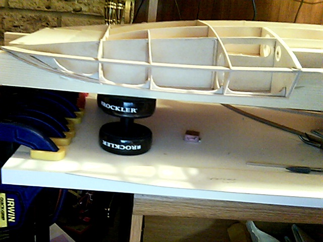

After making frames 6 and a pair of frame 7s, I decided to start assembly. I installed glue blocks to the bottom of the sponson insides and engine bay walls as well as the inboard end and bottom of frames 7. To keep weight down in the afterplane, I made frames 5 and 7 out of 1/32 ply rather than the 1/16 ply everything else except the transom was made from, it was 3/16". In the end, I ended up puting both sponson insides, both engine bay walls, the transom and the previously mentioned frames 6 and 7 together using West Systems 105 resin and 209 hardener while at the same time installing a resized and cut aft bottom. The bottom was installed to keep the hull square during the rest of the build. When the epoxy had cured, I added glue blocks to the frames for attaching the nontrips as well as adding frames 5 with it's glueblocks. The glueblocks were all installed at 45 degrees to match the angle I used on the ends of the transom as again drawn on Roger's plans. I included a third picture showing how the frames were clamped together taken from the kit build I ended up doing for the wife(build is being documented in another thread)
The next step was to install the redesigned sponson transoms. This turned into a two step process. The first step was to get the locations of the glue blocks required to support the front end of the nontrip panels. Knowing the nontrips are set at a 45 degree angle, it was a matter of computing the location of the bottom end of the block. This worked out to 3/32" above the bottom of the boat due to the thickness of the nontrip panels. After the glue blocks were installed, the sponson transoms were attached with epoxy. The catch here is to make sure the transoms, especially the right one, is at 90 degrees to the sponson inside. To those that have never built a sport or scale hydroplane, this is one of the most critical parts of building the boat. Since the skid fin is mounted on the right sponson transom face, any deviation from square will affect handling or must be compensated for when setting up the boat later. It's better to get it right from the beginning and not have to worry later.
With the framing all installed, the outside top corner of the cross frames were notched and a 1/4X1/8" spruce glue rail was installed to the top of the glue blocks with the wide face out. It's important that the rail be high enough to extend above the finished height of the nontrip panel as this will be the surface the deck is epoxied to later. At this point, the nontrip panels were installed with epoxy and left to cure. In the second picture, the air trap and the extension are clearly visible at the base of the nontrip.

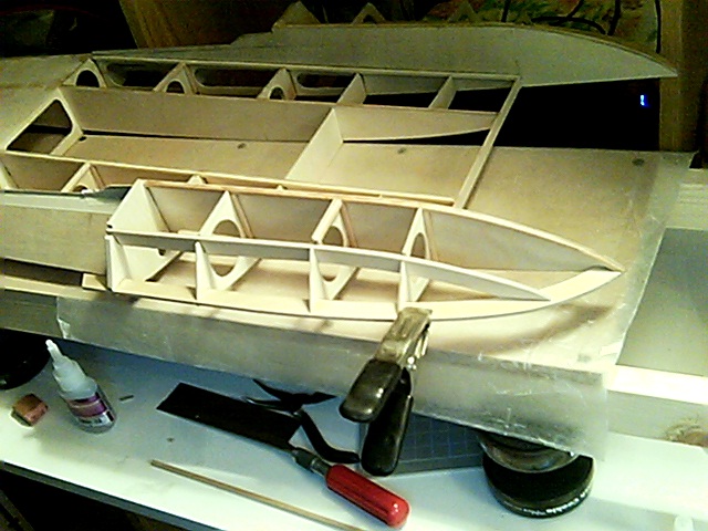

With the sponson transoms installed and secured to the nontrip panels, I now turned to the sponsons. A 1/8" square spruce glue rail was installed to the inside the bottom edge of the sponson inside. Frames that were not finished previously were now finished, including the addition of lightening holes and epoxied to the sponson insides and engine bay walls with 1/8" square spruce glue blocks. I made two partial frame 2s from 1/32 ply, again to cut weight, while the previously completed frame 1 and now completed frame 3 were fabricated from 1/16". Frame 3, like frame 1 that was made earlier, extended across the full width of the hull, adding rigidity to the hull where it was needed most, in front of the skid fin. With the frames now mounted, the sponson sheer rails were fabricated from 1/8" ply and installed. Once again, I had to deviate from the directions with how the sponson chines were done. The directions said to "glue on the 1/8" mahogany parts into slots on the bottom of the cross frames, sand the sheers and chines to match the angle of the frames and attach the sponson side". To me, the sponsons need to be built heavier than that so they won't fall apart. To this end, I cut out two sponson chines from 1/8" ply and epoxied them into place. I then added a 1/8" glue rail and attached it to the outside of the chines to increase the strength and gluing area. Another glue rail was added to the inside to increase the area to attach the sponson bottom. A 1/4X3/16" glue block was now attached to the outside of the sheer/chine joint and the sheers and chines were now sanded to give them parallel gluing surfaces and glue blocks added to the outside edge of each frame. Since the chines were now heavily overbuilt, I removed a considerable amount of ply above the glue blocks using a Dremel tool. A final sanding and the sponson frames were now ready for skinning. At this point, I got away from woodworking and into set up. Rather than fight around the skin later, I machined a skid fin bracket and installed it using machine screws and blind nuts. I also installed threaded inserts into the bottom inboard corners of the sponsons as well as the bottom left corner of the underdeck area through the boat's transom. I'll stop here for the day and continue tomorrow. I have several boats that need building and a couple that are being reworked so...................................

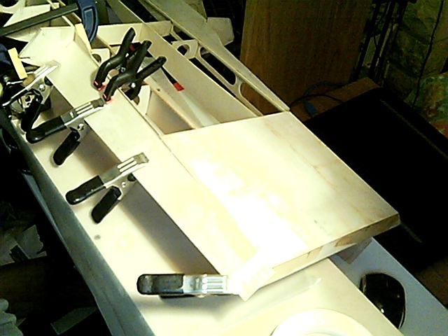

The cowl and bow blocking has probably been the hardest part of the build. The cowl build started with fabricating a cockpit rear panel, part 7A in the kit. Tracing this part was not possible due to the wider width of the engine bay so, using dimensions from the kit supplied part, a wider one was fabricated. I then traced around the tail doublers and lower cowl sides and cut them out of 1/32 ply. To get the tails to the desired width up to the back of the cockpit, I fabricated a framework using 1/8" thick spruce stick stock with widths of up to 1/4" to fill out the tail and sidewall thickness. The vertical tail frames were then sanded to get a scale like taper along the rear edge of the tails. The precut skins were then glued to the inboard side of the vertical tails. The tails were then glued to a false floor that comprised the deck between the tails as well as the cockpit rear panel. To get the front of the cockpit width, I again turned to the Newton color sheet as well as pictures of the full sized Pak to make the new part 5A. I then glued a 1/8" square piece of stick stock to the outside of the tail framing, cockpit rear and the newly fabricated 5A, tapering the rear to get the right angle to the cockpit side. New frame upper halfs were fabricated using the height of the kit parts but with the widths adjusted to the wider engine bay. I now moved to the front of the hull and fabricated a nose cowl bottom block, adjusting the width and shape to match the wider profile and attached it to the front of frame 1. Before going further on the cowl, I added 1/8" glue blocks to all the vertical and top edges to assist in holding the skin. I now installed the lower cowl sides from tail to the front of the center nose block. I next attached glue rails along the top of the cowl frames on both sides to attach the cowl top and upper cockpit sides. At this point, the boat was starting to show that it actually was going to look somewhat like the Pak from the kit.
At this point, I attached the top of the cowl from the nose block to the top of frame 5A. After installing glue blocks to the upper vertical sides of the engine frames, I installed the upper cowl sides from nose block to the rear of the cockpit. The ledge panels were next installed from bow block to tails, giving a smoother look than with a stock kit build. Since the front of the cowl was glued to the deck, I coated the inside of the cowl from the bottom. I left the center of the cowl frames bare as that area is to be removed. I next laid out cut lines using dimensions listed in the kit directions and cut the cowl, removing the rear section that covers the engine and stock build radio box location. I next removed all of the excess material from the cowl frames and sealed up the remaining bare wood. With the cowl now completed except the wing, I installed the forward bottom. The left and right bow blocks were then shaped and installed. The outside of the boat was then coated with West Systems except the center of the bottom. This was left bare until the engine mounts and stuffing box were installed. I next fabricated a wing in the same manner as an airplane wing. Using the wing dimension from the Pak color sheet, I cut a piece of 1/32 ply to 12X3-1/2". I next installed a leading edge made of 1/4" square spruce stick stock. I followed this with a trailing edge made of 3/8X1/8" spruce stick stock. Using the wing tip shape from the color sheet, I cut 7 wing ribs from 1/16" ply and sanded to the rough finished shape. At this point, the wing top was sanded to get the correct airfoil EXCEPT the leading edge. I next attached the wing top skin and, after the glue cured, sanded the leading edge to shape. I didn't attach the wing at this point as it was still unsealed. I also still needed to round the front edge of both tails. This was the boat's configuration when I took the boat east. The picture on the right shows the boat as it was in Grand Rapids Michigan

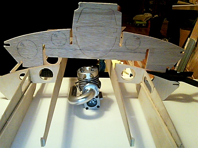

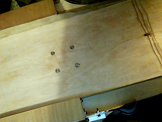

To locate the holes through the bottom of the hull for the retaining screws, I took the 1/4" drill bit and used it to make a pilot dimple in the template. I tacked the template down with a couple of drops of CA and ran a small drill bit through the template and the bottom. I next removed the template and fabricated a pair of doublers from 1/8" plywood, securing them to the bottom of the boat with a line of CA down the middle, followed by weighting them down to cure.
Once the CA had cured, I back drilled the bottom and doublers with a 5/32 drill bit and followed that with a 1/4" bit. I next used a coundersink and bevelled out the holes on the bottom and inserted four flat head screws through the botton, securing them with the Humdinger rubber inserts. The last step(so I thought) was to install the mounting plates and engine onto the rubber mounts. It was at this point that I realized I had a problem What I found is in my rush to get the boat ready to go, I forgot to consider two things when I cut the plates:
1) The pressure line to the right side tank and how far out it would protrude
2) The width of the wide part of the pipe
The first one wasn't a big deal, just trim the plate until there was room, no problem....... IF I WAS AT HOME AND HAD MY MILL TO WORK WITH!!!!!!!!!!!!!!! It took over an hour with my limited tools to get the plate cut back enough to clear the pressure tubing
The second turned into a real problem. I cut the pipe so it would telescope over the header for easy adjustment later.......forgetting that the carb barrel extends out as you open the carb. This gave me two choises, smash in the side of the pipe and hope it still worked or leave the pipe long enough so the carb didn't reach the pipe. This was a no-brainer, the pipe stayed long.

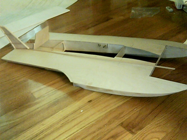

Over the weekend I was able to get some work done on the boat. I resealed the bottom and right nontrip on the outside of the hull as well as the inside of the forward bottom panel. In the process, I epoxied in the through bottom screws so that they are sealed in as well. While the epoxy cures over the rest of the evening and overnight, I'll be working on the engine mounts so I can install them over the next few days. I'll post pictures later after I get more of the rework done
