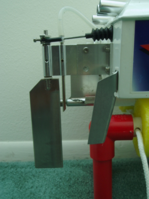

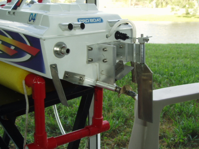

I HAD THE SAME PROB WITH A THE CAP LEAKING PRESURE OUT... SENCE I WAS AT THE LAKE ALL I COULD FUND WAS THE PLASTIC OUTTER LINNER FOR THE NEWSPAPER.. I CUT A SQUARE OUT AND NOW WORKS GREAT. ALSO ADDED A QUICK FUELER TO THE MAIN FUEL LINE. NO RUDDER PROBS YET! ONLY THE THE FLEX SHAFT BREAKING AT THE BEGIN OF THE STRANDED WIRES...

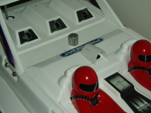

Default RE: shockwave 36 problems

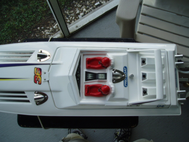

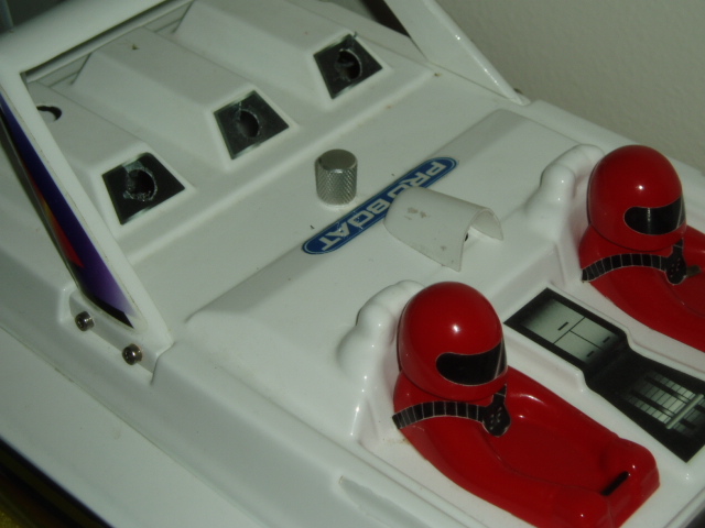

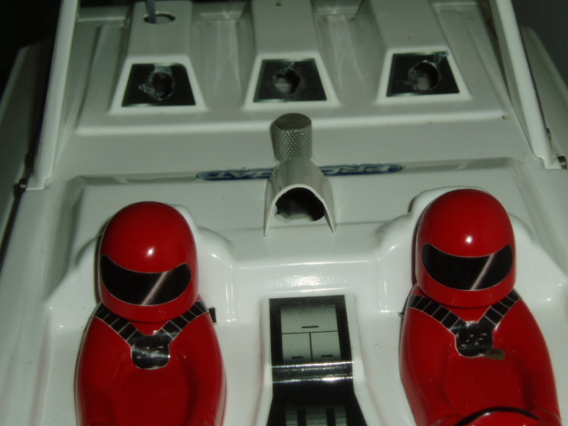

I broke 2 rudders in a row to the advise of other and chage the linkage to a beefier one , I also removed the bottom screw holding the rudder now if i hit somethig it just kicks up without braking, I also installed a air scoop on top of the engine in between the drivers that way more air gets to the more and that = more speed and more power out of turns.

little less than a 1/4", keep it greassed, and let some air inside the hull use vents like this

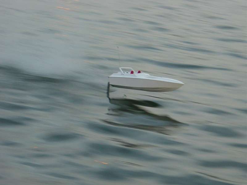

my sw36 screams, sound's like there's a major prob somewhere with yer friend's boat. THe SW comes with a prather 230 and the boat runs great with that. some people say it goes faster with the 235, but the 230 is just fine. Did he break in in properly? THe HSN should be between 2 & 2.5 turns out. Have him start from scratch with the tuning.
here are some pics of me and my buddy's boat. I think they are pretty dang fast...and as far as sitting low in the water at speed, take a look for yourself
(pardon the blurriness, the pictures were taken close to dusk)
