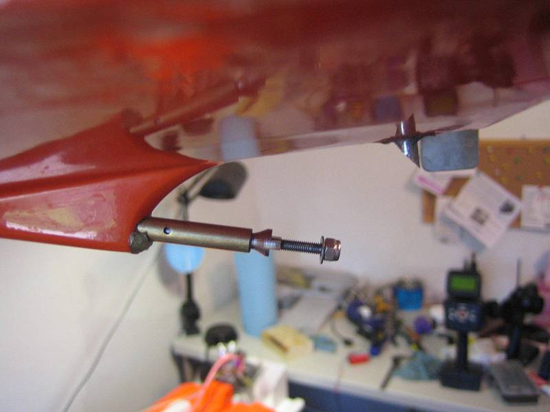

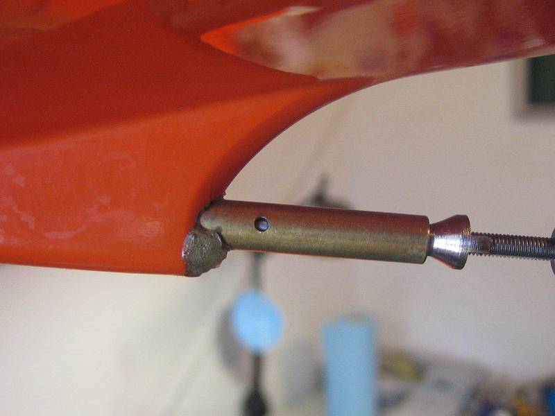

i'm not particular with greythunder but maybe this will help u, i drilled a hole in the shaft tubing in my nitro hammer and it helps a lot, before the water will suck up everytime i run but not this time..i also used it for oiling the shaft coz it's hard to reach inside with hammer set-up.

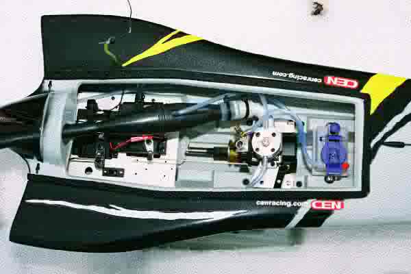

Check the head bolts for tightness.
As you can see in the shot below, I pulled mine off and rotated it 90 degrees as I don't like the idea of having the water inlet over the top of the carb.
It still has to be something inside the boat that is allowing the water in as to why I'm thinking the head or coolant lines if it's only getting water in while running.
