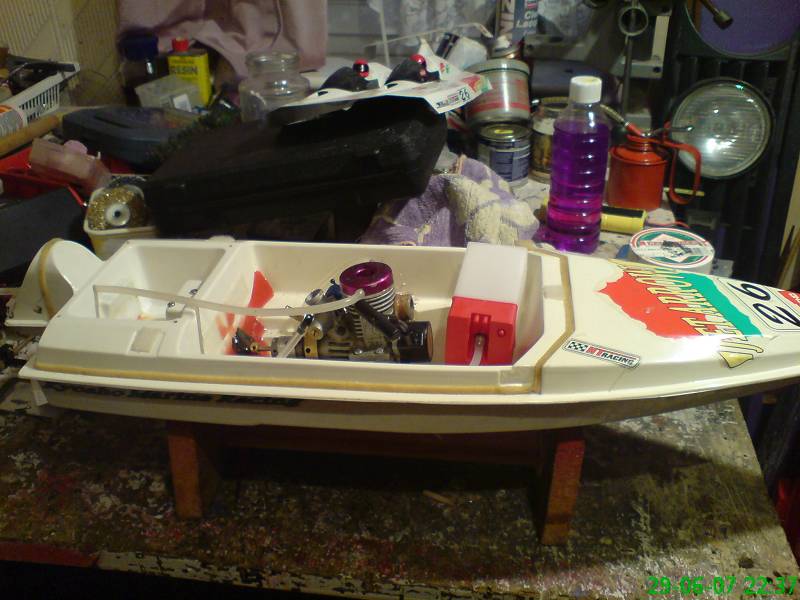

Hi Im making a new boat I have a small 2 foot kyosho jet arrow now the problem I have is when i give it full power just get tons of spray at the back the boat not go any faster so tried weighing down the back keep the prop under the water still the same thing should be going like a bat out of hell too lol got a 3.5 in it with a tuned pipe

What prop are you running?
Get pics of the transom...

If you're running the stock prop, that could be most of the problem.
That's a lot of engine for a little hull as I wouldn't have gone over a mild .18 in there.

Like Ron said.You shouldve ran a.18.+ a right prop does help. That.21 will be an over kill on your boat plus that small plastic hull isnt going to handle that big motor to well=self distructed, If that boat was bigger like 28-30 inc would work. The motor could go back about 1/2-1" to for weight factor.

a 3.5 in that small boat?,,, thats like in the old days ( ron will remember lol" putting a hemi in a vega. remember those ron? lol i do.its like the old saying.. " if big is good,,,,, bigger is better" lol not always tru...for a boat that sized, ron and joesy are right a .18. or maybe a .15 or a good running .12 with a good prop..

I'd try a 42mm prop using that engine and give the hull a decent toss forward when you are launching it.

I believe the CG for a deep vee should be 29% of length. As measured from the back.

A 34mm prop is way too small for a .21 Use a bigger prop.

hi Ryan it is a 3.5cc thought a 34 be perfect !

3.5cc (.21) size engines run at least a 41mm prop. I run a 44mm on a mono with a .21

37mm minimum but usually you'll find something in the 40mm will do the job.
