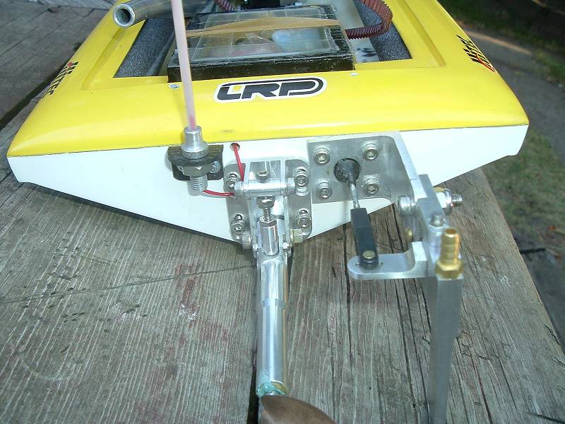

http://www.auctiva.com/hostedimages/...0,0,0&format=0

surface drive system.

Stinger
http://www.offshoreelectrics.com/pro...os-stinger-str
http://cgi.ebay.com/Adjustable-sting...QQcmdZViewItem
http://www.rumracingproducts.com/pro...d%20strut.html
Sean

Are they needed for smaller boats?
The boat is 930mm long (3 foot)
Also, what is the difference between facing the prop up or down? (positive/negative thrust angles?)

They're made for various sizes of boat and yes, I've used one on a .12 mono and now my gas boat. If the stinger is long then it has to be raised higher than the usual struts.
Here's an excellent thread on them: http://www.intlwaters.com/index.php?showtopic=23589

And, my boat now, the prop sits 8cm back from the hull on an outdrive system that the prop turns with the rudder
But that part there wears out way too quick so I want to change it over to a fixed prop setup
Should I aim to get the prop sitting about 8cm from the hull again with the stinger?

Does this outdrive put your prop below the hull?? Or coming out of the back of the hull (transom)??
How far behind the hull that the prop is placed, changes how the boat will ride. I do not have enough experience to know what happens at different length though.

No the prop comes out of the rear of the hull not under it.
So the prop is basically level with the bottom of the hull

Kind of like this........
