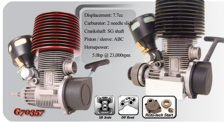

Where can i find a water cooling head for a .46 nitro motor? I have no idea where to find one i looked and didn't see anything. The head has six bolts in it.

What temp should the motor run with a water cooled head? I may have someone make me one for free.[sm=lol.gif] The motor is a .46 7.7cc 5 hp 20,000 rpm

What kind of 7.5cc engine are you running that is making 5HP?

Yes, you've got cylinder diameter, head volume, bolt pattern and a host of other things to consider as not just any head will bolt on.
Five HP at only 20,000 RPM sounds more like advertising hype from the manufacturer. Even an old K&B .45 will turn 23-25,000 RPM but not the HP.

sounds like the one from cen. thats the only 7.7cc that i know of with that clamed hp .

Yes it is the cen 7.7 motor.

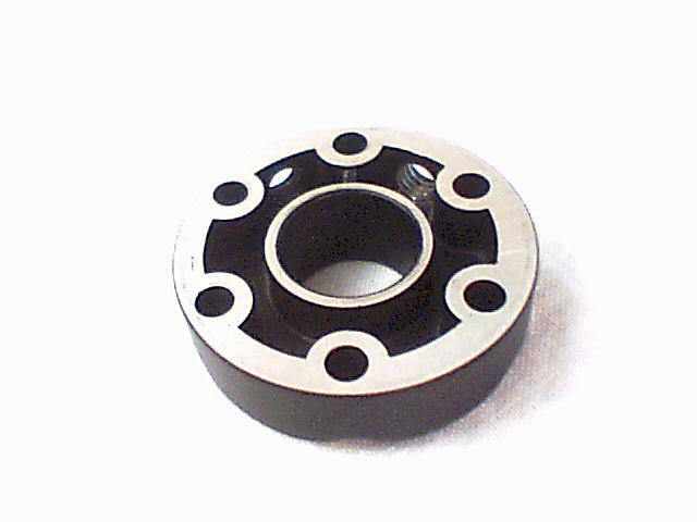

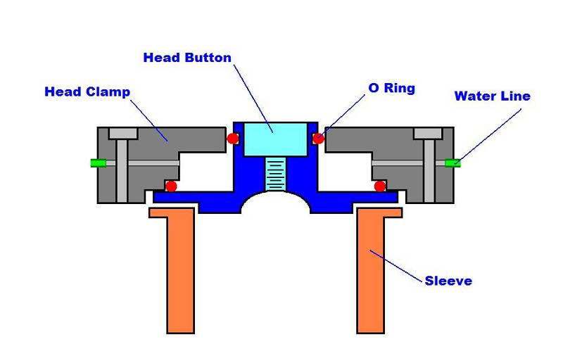

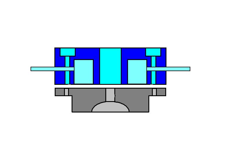

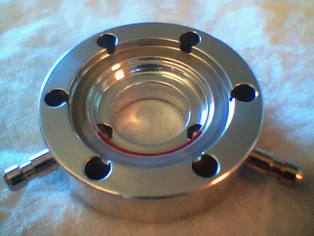

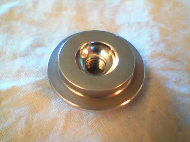

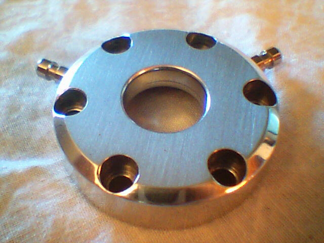

jetpack's Avatar
Posts: 2,477
From: Hobart, IN
Default RE: Cooling head?????
ORIGINAL: lildude2599
Just looking for where the water runs through it. If anyone has one can they send me some pics of it so i can see how it is made?
This is a Webra head and jacket. It is more fancy than most but contains O-Ring seals where others do not. You would most likely have to make the head button instead of reworking the original head.
The other kind is more simple to make and probably could shave the original fins off the top of the head to make it flat across, saving as much as the glow plug threads as you can.

Old 03-12-2008 | 05:53 PM
lildude2599's Avatar
Joined: Dec 2007
Posts: 500
From: Norco, LA
Thank's jetpack that's what i was looking for. Now i can show someone how to make the head i need. I tryed to explane to them how to make it and they did not have a clue. Now i have some pics they can go off of.
