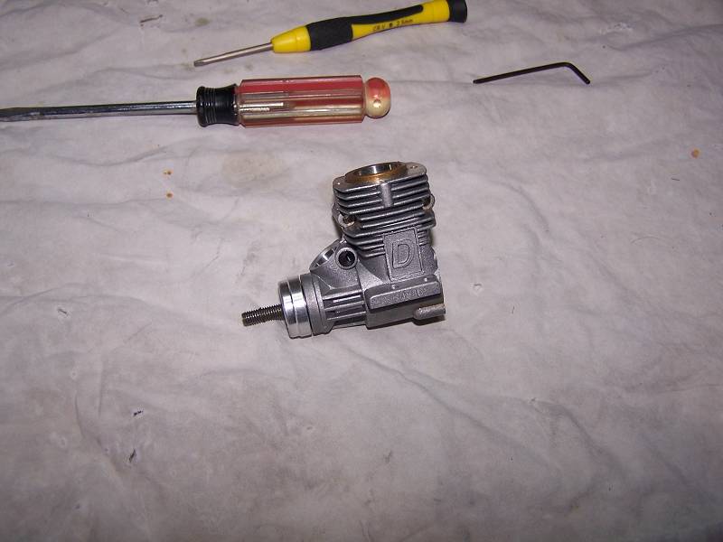

I have a Dynamite-15 i have torn apart except for the Crankshaft and Piston, I don't no how to get them out. Sure would love some help? Thanks

I assume you have remove the back plate.
pull the sleeve out, than flip engine upside down and carefully rotate the crank to bring the piston at TDC.
Slide the con rod of the crankshaft pin and the piston with the rod will fall into your hand (make sure your hand is there).
push on the crank to remove it, sometimes they slide right out and sometimes they can be a little stiff.

If the sleave is tight (often when they are in there for a long time & the piston/sleave is worn out), slide a zip tie through one of the ports while the piston is BDC and poistion the head of the zip tie so that when you rotate the crank the piston pushes the sleave up & out of the case. if that doesn't work you may need to put it in the oven for a bit to warm it up enough to let it slide out.

Good point dicko.

Thanks Dan,Dicko i'll give it a try and yes i have the back plate off. Sorry to post such a DUMB question Thanks again for your time guys.
