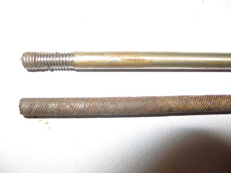

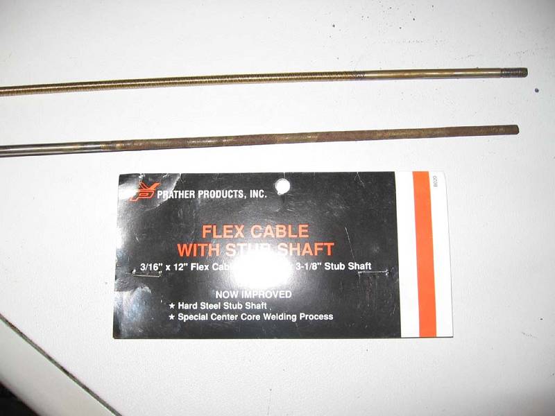

Hey guys
So I am in the process of refitting my TC31
I purchased a Prather 8020 flex cable which I believe is correct apart from trimming for length
However when I went to give it a test fit not only does the drive dog not fit over the stub shaft but the cable itself just will not go anywhere near fitting the stuffing tube.
The stock cable fits snugly.
I realise I need to grind a flat section down for the drive dog set screw.
What am I missing here?
Do I need a new teflon liner or what
Cable packet reads as follows 3/16 x 12 flex cable with 3/16 x 3-1/8 stub shaft.
Thanks for the help [8D]

i have a tc 31 also,i haven't changed the cable but i heard that the stuffing tube and teflon liner are a freak size. that may be the problem.

Just an observation, or may be my eyes are lying, the cable you recieved seems to be larger than the stock cable
by 1-2mm.

Nobody noticed yet that the bottom crust rusty cable is wound the wrong way and the upper one has issues also like it's missing a strand of wire.

Ron its brand new so I would hope not.
You mean round the wrong way as in the picture,yes I know.
I do know which way it goes in the boat
Yeah I realise the Thundercat/Shockwave cables are the same.
The problem is I need some thing longer than the stock cable as the boat is getting an OS46 which needs to sit a little further forward.
Hmmm well I guess I just try another brand in that case.
I would have thought a standard size was par for the course.

Try a Hughey B-6666, you can cut it to the length that you need.
Aeromarine also carries nice cables that you might be able to get easier in NZ.

Yep cheers got an Aeromarine on the way.
Hopefully that will work otherwise I guess its new stuffing tube time.
Was hoping to avoid that
Old 07-15-2009 | 01:55 AM
Joined: Apr 2009
Posts: 37
From: , NEW ZEALAND
Default RE: Thundercat 31 Flex Cable
All is well the Aeromarine fits nicely for future reference
