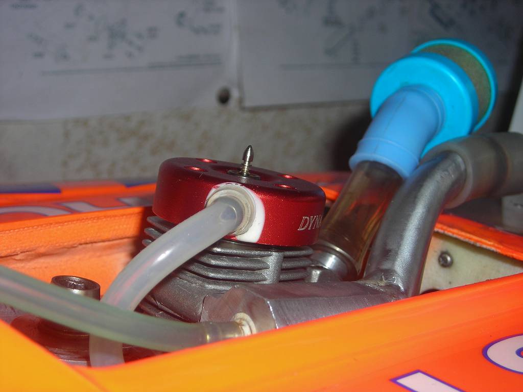

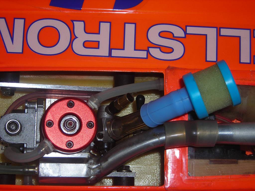

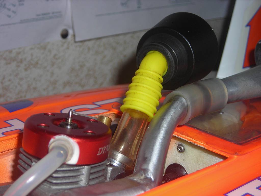

I have not been able to run it yet but I have done some modifying. I have added an air filter element in order to help keep water out of the carb. I know that it isn't necessary but it should help keep the carb dry. The black air filter assembly actually has no actual filter in it but is there more or less as a shield. Hopefully I can run it in the next couple of days and check everything out. My buddy just picked up a new Vegas Duece and is dying to go break it in and wants me to go as he has never had to break in a nitro engine. Maybe I'll bring my Elam and do some testing. Does anyone have any bad experiences with adding an air filter? Thanks guys for all of your help.
P.S. - Hopefully the pictures upload. In the pics are a few different air filter configurations that I am thinking of running.

forgot to add these pics!

should be fine i mean they run just fine in a buggy or truck with air filters. the only thing is that most people willcomplain about a boat not really needing one since there is no dust or dirt on the water. the way i figure it, a little castor oil on the filter will stop the water scince oil and water dont mix, i plan on using one on my boat.

Those were my thoughts as well.
