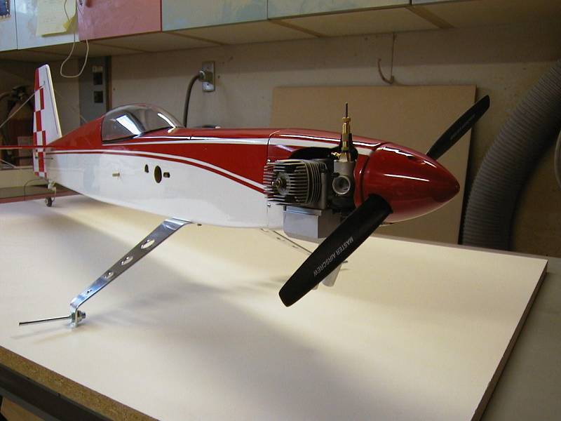

anyone got any pics of their engine mounting methods in SSE's? i have the ARF and am about to the point of mounting the engine. I am putting an OS .55AX in it. i was gonna wait to do it last to help get the balance right without adding any weight, but it seems that even at the lowest point i can mount it with the supplied engine mounts the carb is gonna be way above the centerline of the fuel tank. not so ideal. i could mount it sideways, and that would fix that problem, but then there is a bit of an issue with throttle linkage, not to mention cutting out the side of the plane for the head. so if any suggestions and pics are out there, thanks for the input.

If it is way above the tank center perhaps you should think of an inverted mounting. Your throttle linkage would be the only change other than new holes for the mount. No cutting of the airframe needed, not to mention a clean look to the top of the airframe. The other option would be to move the tank mount to lower the tank.
Either way you may want to use a 3 line fuel setup (uniflow), because you may have a problem any way you mount other than the sidewinder setup you mentioned.
There are several threads by guys whom had made extensive mods to the SSE on RCU perhaps they can better answer your question. I have an SSE kit that I intend to put together next week while on vacation ,and am going to use a OS .55AX on it inverted. I will probably make up a cowl as well rather than use the stock "cheeks" on it.

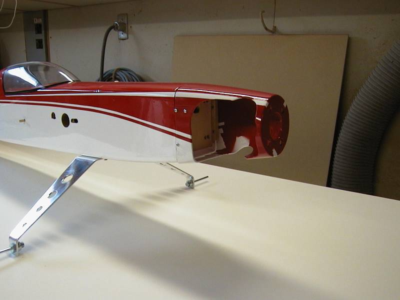

I mounted mine sideways and did a custom FG cowl. Engine is a ST .45 with a Pitts muffler. It seemed to fly much faster than other SSE's that I've seen. Probably the result of better streamlining.

I had a SSE ARF with a Super Tigre .45 mounted int he stock position. It ran very well; no problems at all. I wouldn't hesitate to mount it just like the instructions show.
I also put the same engine mounted sideways in a kit built SSE. Maybe I built the kit lighter, maybe it was the streamlining from the cowl or maybe it was the carb position but this SSE was noticeably faster using the same prop and fuel. It also had a Macs muffler on this plane, maybe that was a factor too.
One problem both SSE's had is prop clearance with the stock gear. I was running 11" props. With the .55-AX you'll likely be running a 12". This means even less clearance. Order some taller, stronger gear from tntlandinggear.com or someplace similar. You'll be glad you did.

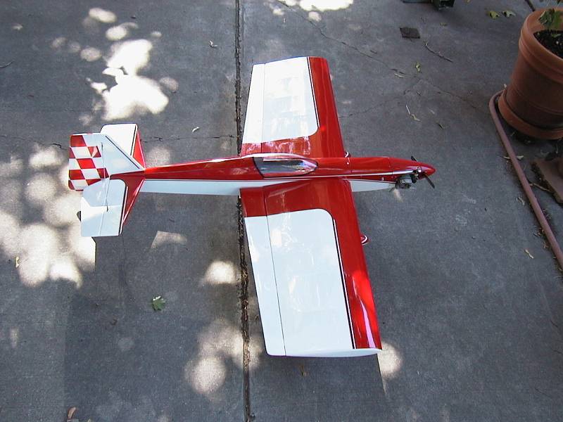

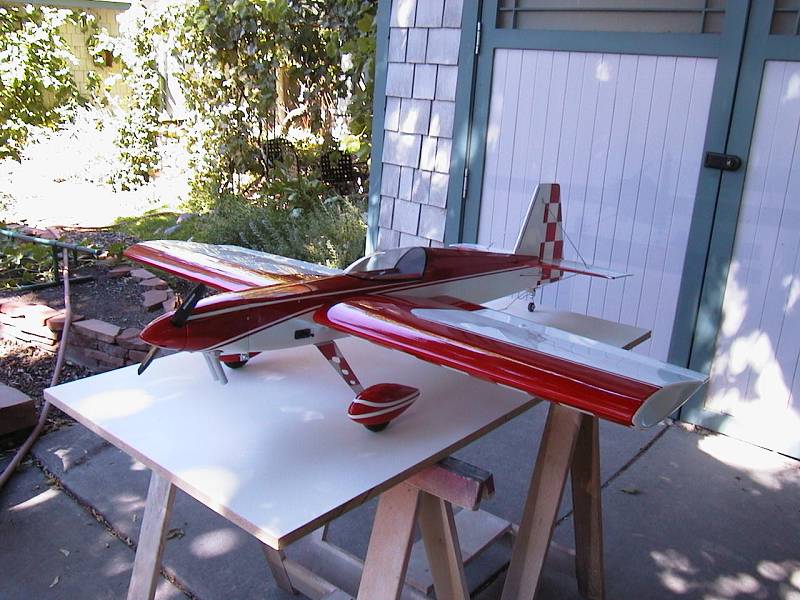

Speedlover, Here's a photo of the whole plane. Unfortunately, I biffed it on the first flight of the season. Totally destroyed the plane except for the tail section. I have another to build-hopefully this winter. I liked that plane so much that I will probably always have one in the fleet! Troposcuba-congrats on getting the wife back!

What size spinner did you use? I had a 2.25" on mine and built a balsa cowl. the curve it had to make to meet the spinner always looked a little goofy to me. Yours seems much better.

Spinner size was a 2 1/2". Larger might even be better.
