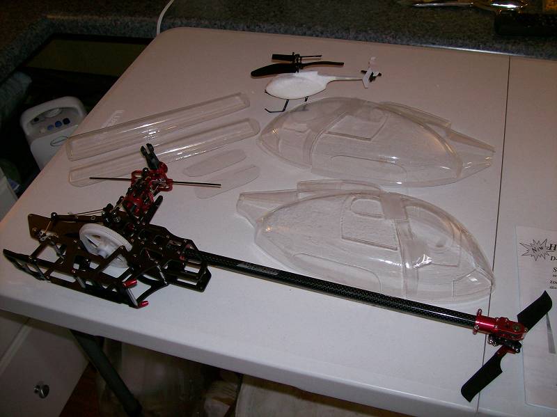

Does anyone know where you can get RED blings parts for the Trex 450 SA. You can find blue anywhere and I have seen a few with RED but I cannot find any. In particular I am looking for RED bump resistant landing gear, tail boom stabilizers with RED links, and the hardward bag with RED bling instead of blue. Can anyone help.!!!

Do you mean red like this? If so, these are not Trex parts. They are X400/MX400 parts. Although, www.helihobby.com sells Trex parts in several colors, so you may find some there.
Brian
