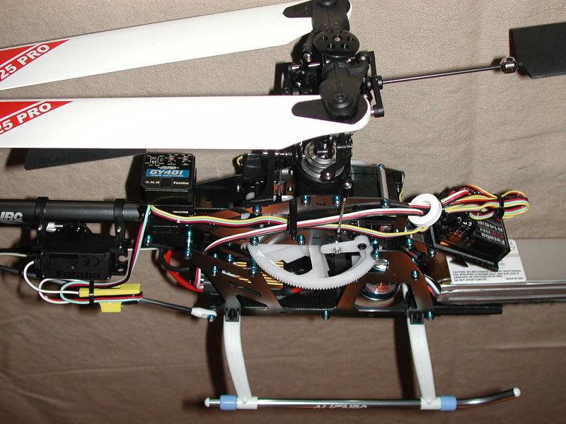

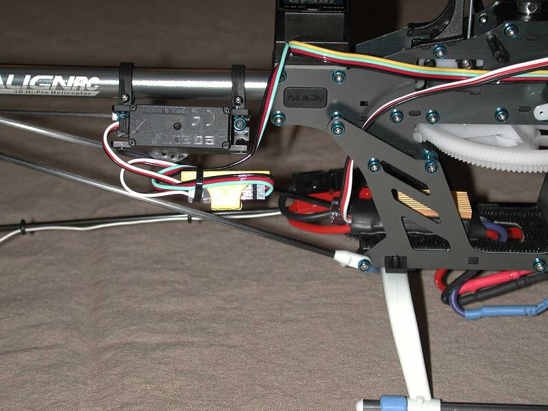

Does anyone have any pictures of their 9650 mounted on the stock align servo mounts. As I have mine it seem to be creating a pretty severe angle on the tail push rod. Thanks, Joe

Here is one from a guy at my club. I just finished mine and had it test flown and it is setup the same way. Hope this helps.

Heliproz makes a real nice set for $14.99 that fit the 9650 perfect.I purchased mine thu Dee Tee Enterprises

I would put the Gyro under the boom, and move the servo to the other side (port).
Otherwise with a boom strike it get real expensive quick.

I cut off the horizontal tabs on the servo, and used the vertical tabs. It lined up better that way.
