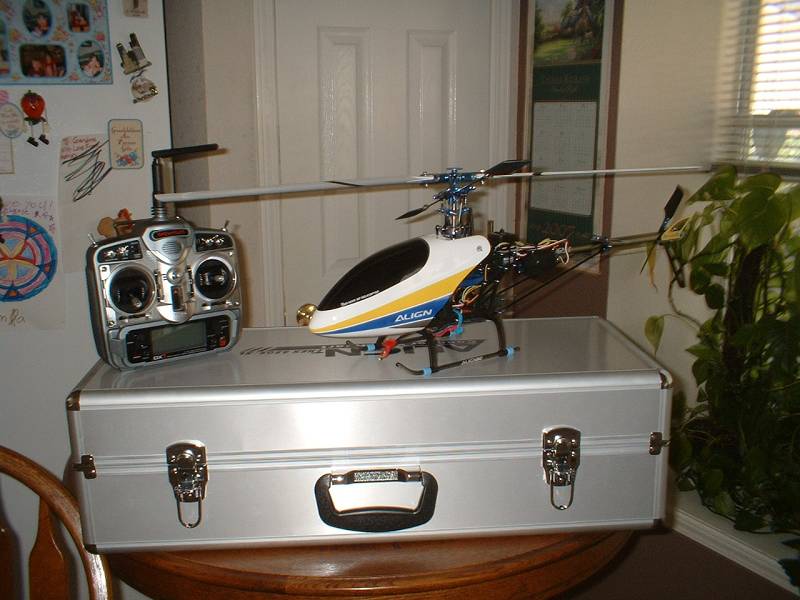

I have a 450 V2 and am using the HS65MG's on all but the tail they run about 30 bucks each but really are worth it. Do not skimp on servos it will cost you in the long run. Mike
