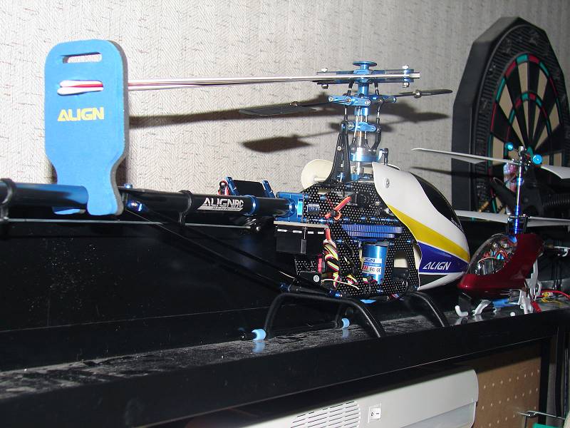

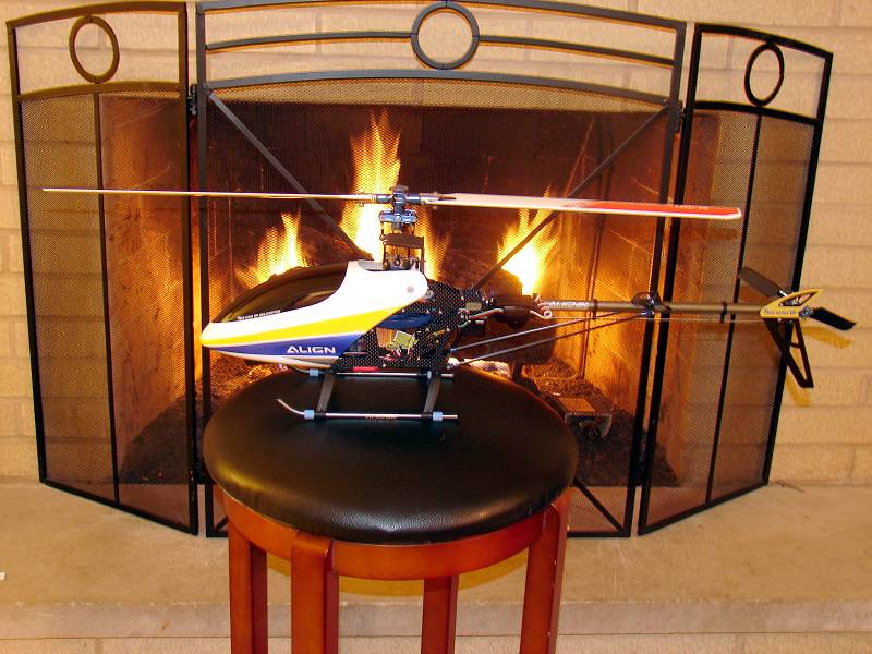

Last night, I FINISHED MY BUILD!
Yes, I am finally done! It has taken me almost a month, but it is finished!
I cleared my final hurdle last night. I plugged her in after programming teh ESC and she would spin on the ground uncontrollably. [
] Luckily, it was an easy fix: reverse the gyro direction! I did that and now, the tail is rock solid!
I took a video clip of spinning her up and doing a couple of tentative hops in the garage last night. The audio on this clip doesn't do justice to the incrdible sound coming from this Heli! There is a LOT of power there! [8D]
http://s215.photobucket.com/albums/c...t=c6ecf0e9.flv
So, this officially ends my TREX 450 V2 build log. From here on out, I will post questions, pix and video under separate topic headings. I hope that you have all enjoyed the ride and that this was beneficial for some of you who may be on the same track as I. If you have any comments or questions, please feel free to continue to post here, but this will be my last build post.
Thank you to everyone who posted here. [sm=thumbs_up.gif] Your input comments and suggestions have helped me finish this beautiful Heli!
Here are some pix for you to enjoy.

Congrats BryFlyGuy67!
Is similar. I find the sim's controller too sensitive even on low rates. I havn't hooked up my regular transmitter yet.
I don't see the Align stickers on the canapy.
Did you ever use that 16oz claw hammer I see on your work bench on TRex?

I think you will really enjoy flying Rex around.
In my 1st real crash the canapy was damaged pretty good. Epoxy fixed it up pretty good and that is the canapy I fly around with - just incase
For show I use the original canapy (a new one) with stickers. This winter, I am going to try out my artistic ability and air brush the crashed canapy.
