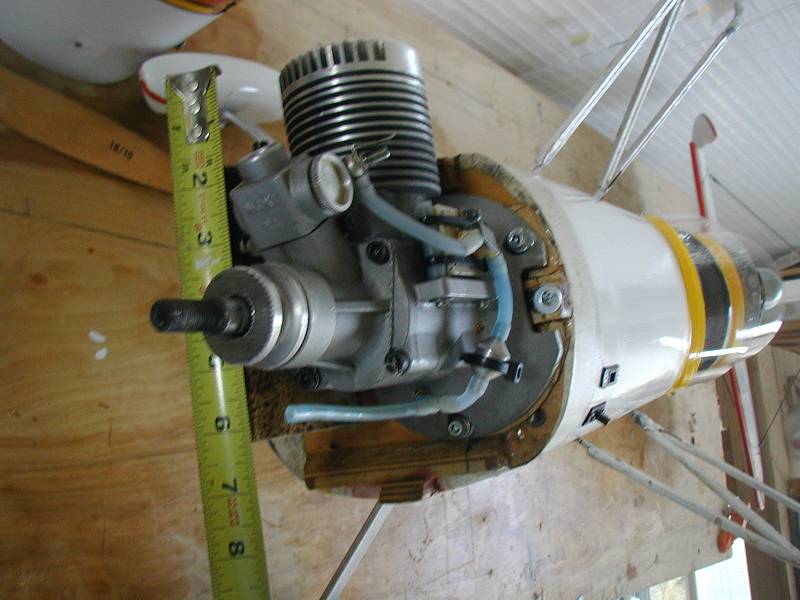

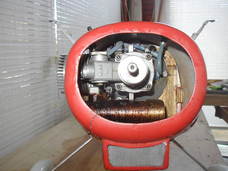

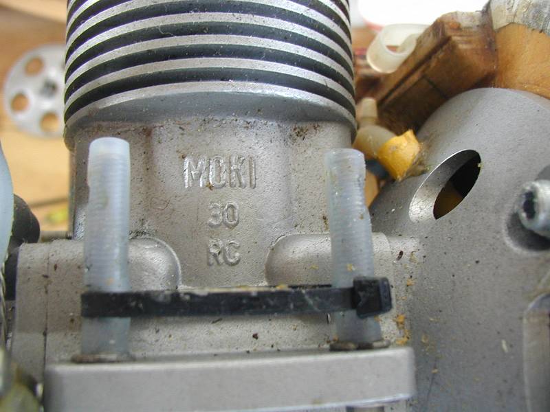

I need help, I just picked up a used plane with a big Moki on it. I am not sure what size it is though, I think it may be a 1.8. The side says "Moki 30 RC", so I figure 30cc = 1.8. Am I right?

As the Wasp said, yes you do have the Moki 1.80. What's interesting to note is that while mine too says Moki 30 RC on one side, the other side says Moki M 180.
