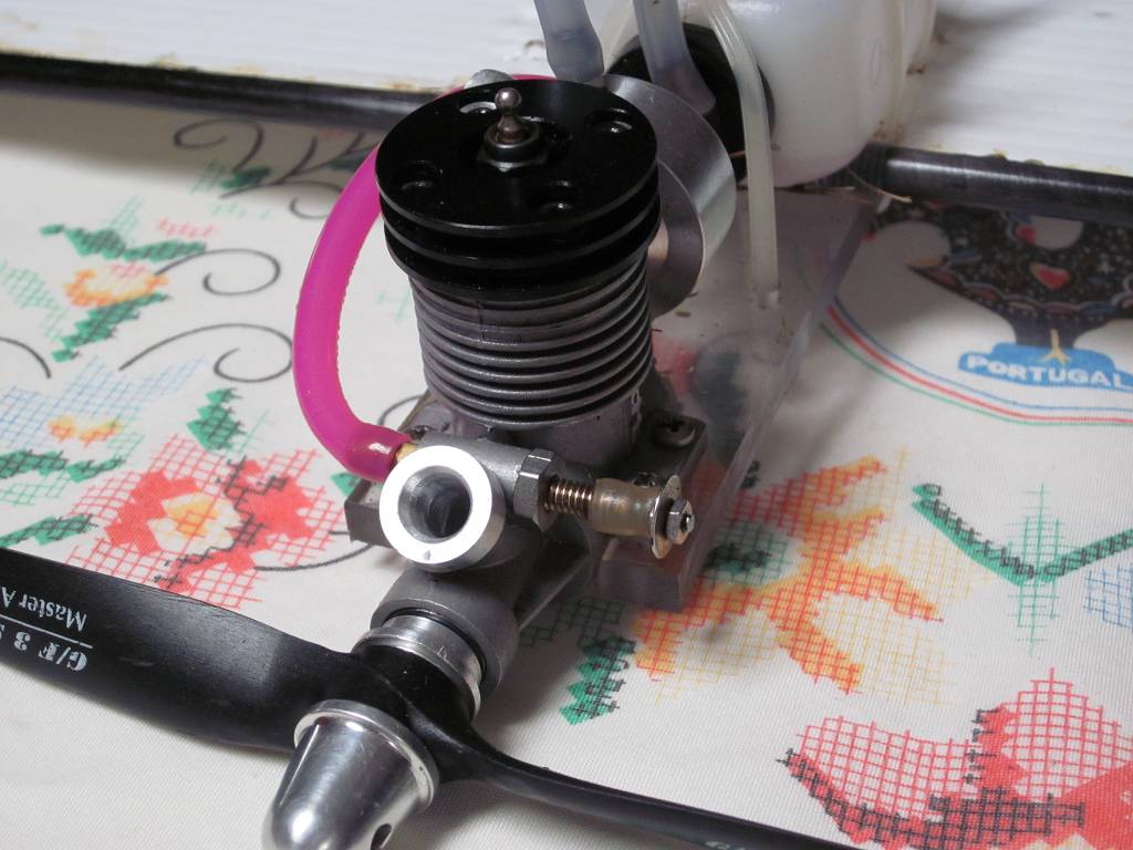

OK since at least two other people like these motors I will put some pics in. The one with the black head is the .15 (.135) I made a header to use a pipe too.
