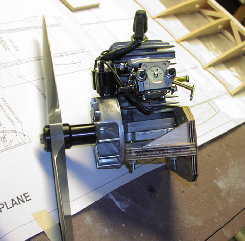

Thanks for the tip on the Homelite 33cc. I picked up a chainsaw, model 3314, at Home Depot this past weekend for $109. It took one afternoon to make the conversion. I took the prop hub off my Ryobi (which I could never get to run properly) and it fit right on. The Homelite 33cc started right up and ran nice and smooth with good power. I can't wait to try it in the plane I'm working on.

I didn't weigh the engine without the muffler. It's about 4# as is with the firewall mount that I made from aircraft ply. I'll be using the stock muffler with a pipe braized on to go out the bottom. I haven't opened up the muffler to see what's inside. If there's any baffles I'll remove them. I can use the stock muffler cuz there's tons of room inside the cowl. I'm using the engine in a BUSA Fokker Tripe. I ran it on the test stand with an 18-6 prop, but I'm hoping I can use a 20-6 eventually. If the plane comes in at 14# or so this engine should haul it pretty well since they fly well with a G23. I want to put in a smoke system and do some aerobatics with it.
I ran it with the prime bulb removed and the hole plugged. I closed the choke and put my finger over the carb and cranked it through a few times. It drew the fuel up the pickup tube nicely. It started after a few more flips and idles just fine. I don't know if I'll bother with the prime bulb or not.
I wish I had known about this engine before I converted my 25cc Homelite leafblower engines. There was more cutting involved and I ended up buying the bigger carbs at $40 a pop. The 33cc already comes with the bigger carb so it's even cheaper to convert plus the power bonus.

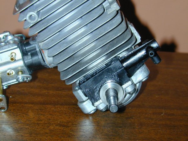

I just removed a 33cc Homelite chainsaw engine and want to convert it. I have a few questions for those who have already converted these. First, what is the black (plastic?) piec that fits over the top of the rear (clutch end) bearing. It has a tube with containing a rod with longitudinal ridges (like a long gear) that meshes with threads like a worm gear surrounding the clutch shaft. What is it? Can I cut the long part off that sticks out to the side?
Also, does anyone make a muffler or velocity stack that fits? I am pretty good with my hands but have no machine tools or metal fabrication experience. (Lots of woodworking)
I heard today that chainsaw engines don't take thrust forces well because they use needle bearings. Is this a problem for this engine?
Any help would be appreciated.

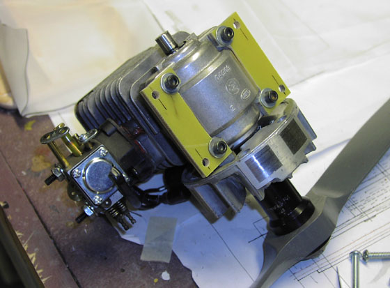

I removed all that stuff from the back of the engine and I cut off the clutch shaft, leaving about 1/2" sticking out. You probably could cut it even shorter. Here's a picture of what it looks like, including the mounting tabs I made from 3/16" G10 board.
I don't know if there's any problems with the needle bearings. "rev" has been using these engines for a few years. Maybe he can comment on them.
Jim

Jwc , That is the automatiic oiler for the chain. Tmoth is right just remove it. Make sure when you cut the extra pice off the lower case haft leave the ridge to keep the bearing and seal in place. I have not had any problems with the bearings. ( and I put them through alot of hard use.. I wounder if the chain oiler would make a easy way to add a smoke system??
