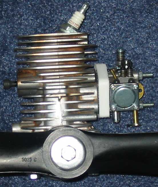

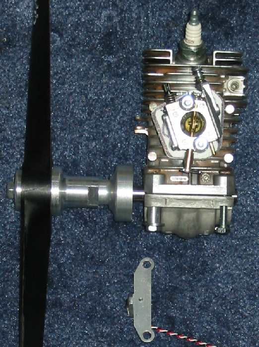

Hey Guys,
Heres a couple pics of my 42cc in process of converting.
Using CH "bolt-on" ignition....super easy.
Also made a carb adapter to rotate for straight shot linkage.
Enjoy!

Very nice looking. I am contemplating if I should continue on my conversion of the 46cc because I wont be using it for my Extra. I may end up just selling it.
