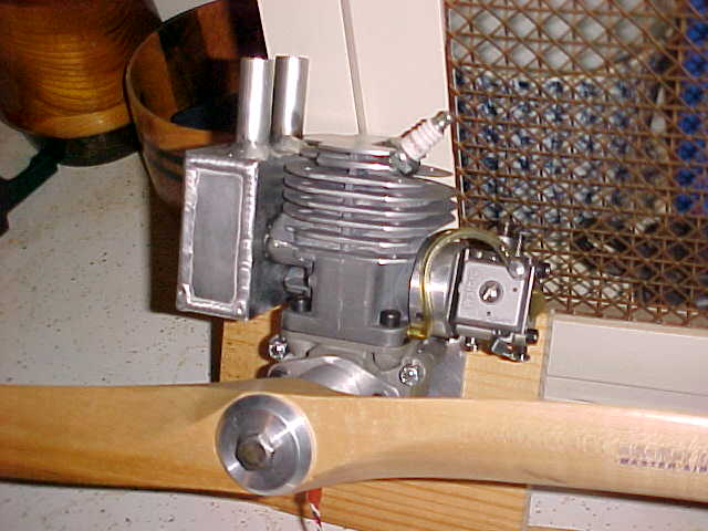

OK Guys, here's the latest motor project. This motor is actually a little stronger than my 46. On the stock muffler it's turning a Zinger 18x6-10 at 7500rpm, the MA 20x10 at 6870rpm. With the Abel muffler on it it's turning a Pro Zinger 20x8 at 7560rpm and the MA 20x10 at 7360rpm. One finger, one flip starts! Love those electronic ignitions.

The 42 was from a Poulan Pro 260, I picked it up at Lowes last winter for $89.95. Basically, you have to modify the Hanger Nine mounts a little to fit, make a prop adapter, design and fabricate some kind of mount for the pulse switch (pickup sensor), find TDC and install the magnet in the right place so it fires at 28* BTDC. C-H makes a bolt on conversion kit for this line of engines if you don't have the skills or equipment to make the parts yourself.

flipflop, I'm surprised your 42cc is running stronger than the 46cc. My 46cc (Pro 295) is not broken in yet, and I was already getting 7000+RPMs with a MA Classic 20x10 on the stock muffler and CH Ign. I'm sure once it breaks in a littler more, and I put on the Abell muffler, it will gain a few hundred RPMs.
I'm liking my Poulan very much and looking to get another to put on my new Sportsman Aviation Super Decathlon. The 46cc might be a little too much power, so I was thinking about either the 42cc (Pro260), 38cc (Pro220), or even the 36cc (Patriot). What's you take on these different ones?
My impression is that these other Poulans don't weigh any less than the 46cc. Is this correct? If that's the case, I'm thinking why don't I just get another 46cc? Your opinion?

I used the 42 in the saw for 5-6 tanks cutting up a huge oak tree in my frontyard, never ran the 46 in the saw, so the 42 is probably just broken-in a little more. You're right, there isn't going to be hardly any weight difference between the 36 through the 46. I haven't actually compared part numbers, but I think the Patriot though the 42 all use the same crank (never looked at the 46 crank) The 36-42 cylinders appear to be the same with different bores. The 36-42 motors are physically smaller than the 46, about 3 1/8 wide at the mounts compared to 3 7/8 for the 46. My 54 and 60 are both lighter than any of the smaller ones since they don't have to use the hanger nine mounts.

Does the Poulan "42" have standard muffler mounting specs? For say a Bennet or other?
Jimmy
Old 01-29-2003 | 11:42 PM
Posts: 424
From: Naples, TX
Default Poulan 42
I sent one of my stock mufflers to Mr. Bennet a while back so he could make a pattern, I imagine he still has the specs. Abel mufflers can also fix you up.

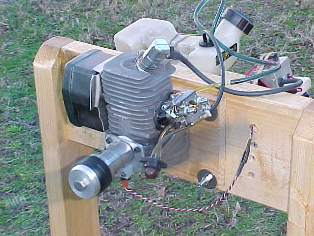

On the 42, is there a way to make a bracket to hold the stock MAG in place? Maybe build somthing to come off the mounting rails at 90 degrees? Or bolt a flat plate to the front of the case behind the flywheel? ..... Or would it just be best to order the $189 CH conversion kit? Can it be converted to CH cheaper? I.E. just get a 15 dollar prop hub and mount my own magnet.

I drilled and tapped the holes for the plate to hold my pickup sensor in about the only place possible, there isn't much metal down there. If you do decide to try to fabricate a bracket to hold the mag, keep in mind that you'll have to locate the mag in the same place that its mounted in the saw. If you plan on centering the mag on the cylinder like most engines, you'll have to get a different flywheel or remove the keyway from the stock one and set the timing yourself. Too much trouble for me.
The C-H coversion is the easiest. Do you already have an ignition? Saw out the center section of your flywheel, turn it the same diameter as your prop hub, and mount the magnet in it.

CH hasn't tested the 42 yet...so they are sending me the 33cc version full conversion kit prop hub, igntion, sensor mount. I can use on my 34cc motor if it doesn't work on the 42).
Is the 42 a different cylinder than the 33/34cc?
I may need to somehow make a sensor attachment bracket like yours... Do you think I can do it without a bunch of machining tools? Basic dremel, drill press and hack saw?

I'm running the SynchroSpark on mine, sure makes starting easy. I haven't done a 33/34, but the 42 looks the same as my 36 and I imagine the smaller ones are the same. Sure, the backyard mechanic tools would be all you would need to make a sensor bracket like mine, but since you're getting the full C-H conversion, it all should just bolt together without you having to make anything.

I'm using the SynchroSpark on mine because I've been using the same ignition testing engines up to an 81cc Huskey. The 42 uses the same 8mm crank as the smaller engines so the C-H prop adapter should be fine. No carb adapter needed. I would think the 54 you're looking at would be worth that much as long as it has good compression. But Poulan replacement parts are resonably priced, I got a new cylinder, piston kit, and front seal for mine for $101. the 54 makes some serious power, here's a shot of mine with a 22x10 scimitar on it.

The Poulan 33 conversion kit from CH is EXACT match for the 42cc as well.
I haven't fully re-assembled my 42 yet...but the bracket and bolt patterns for the 33-42 are the same....IT WORKS!
If anyone happens to talks to the guys at CH, let them know it works.
PS. The CH machined parts are beautiful too. Both flywheel and prop hub have notches to slide a wrench right on them for tightening....smooth!
