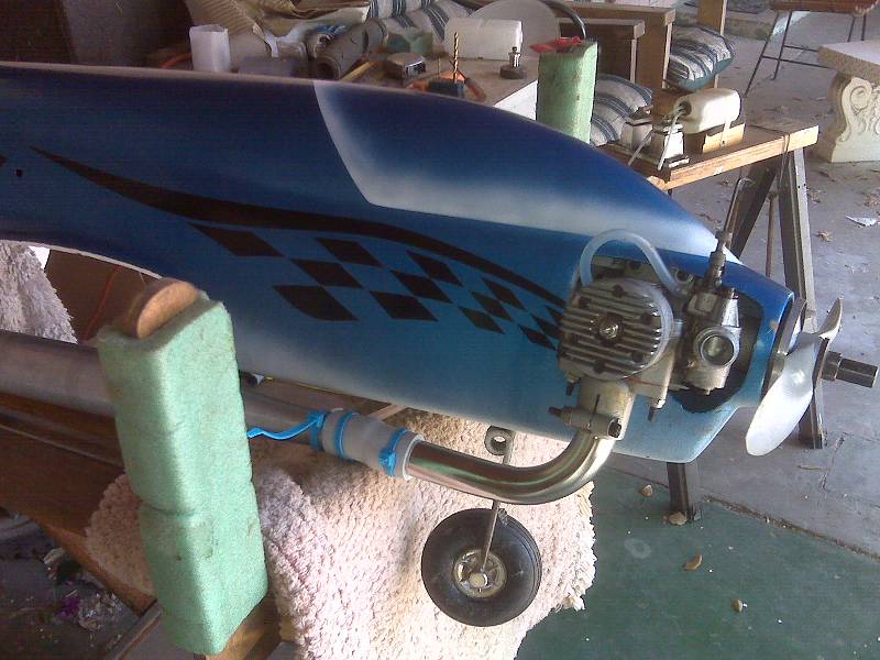

12x7 apc 15%cool power os #8 plug 11,900 rtf ST header modified to fit OS bolt pattern, im sure ill get a couple hundred more rpm with the right header....on this header meant for a Super Tigre, doesn't quite line up to the exhaust port, restricting it a bit
what numbers can i expect on an ideally setup SF 61 and pipe wih a 12x7 APC? my figures seem very low

Old 04-23-2009 | 04:13 PM
  #31
DarZeelon's Avatar
Joined: Apr 2003
Posts: 8,913
Received 6 Likes on 6 Posts
From: Rosh-HaAyin, ISRAEL
Default RE: os 61sf
ORIGINAL: MetallicaJunkie
12x7 APC, 15% Cool Power...
MJ,
Give it fuel with some castor oil...
Lest CruelPower will show you what it's really worth...[:'(]
Also, with the tuned pipe, 15% nitro can be borderline high...

ill go up in prop size, i have an 11x10 apc to try...The pipe im using is a macs muffled pipe if im not mistaken, its close to 19 inches long... im gonna have to order a macs long header for the OS 61, ............ for those of you that have tuned them.....How much would i need to cut off from a brand new macs header,to be in the optimum range?>
Ill try an 11x10apc during my lunch break tomorrow, its getting too dark to get any good tach readings

I'm using the Mac's 10cc long stroke quiet pipe and my header is cut to 5 3/4"
I'm getting 12,337 with the APC 11x10.
That should make a fair benchmark for your tests.
David

thanks, i tooks my pipe off to make some measurements, and noticed there a was a pretty big chunk of silicone couple that stayed behind from a previous accident, that could explain why my engine tured off on me a few times for no apparent while trying to get some tach numbers
is that how you measured your header ?(see attachment)

ok with 11x10 i got 11,860, im gonna order a macs header, i have a feeling the misaligned st header is robbing me

i got new macs header in today, and to be on the safe side i cut the header to 6 inches, measurement taken based on the method Macspro.com uses and got 12300 peak, and backed down to about 12100 or so. Next i need a new set of bearing, it sounds very rough, almost like a coffee grinder. This was one of the engines i brought back to life after many years in storage.
