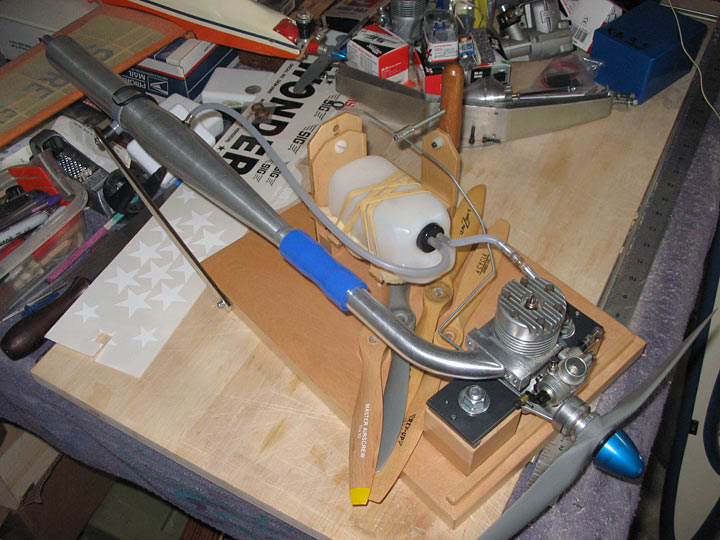

I'm hoping to run mine with the pipe and a 12x8 today or tomorrow.
I'll take some tach readings.
David

looks good.... i plan on running mine as well, i finally got around to putting the finishing touches on the bird the SF is going into..... i cut about one inch off the stock length header, hopefully ill get it to sing higher ill be using a 12x6 xoar/jfx black prop..
any new numbers, with yur set up?

13,300 peak w/ 10% @ sea level with a 12x6 xoar nylon and 1" cut off the header. Does hat sound about right, this is my first tuned pipe setup i have tached

MJ, I ran my SF w/pipe for a short while, but I didn't take any tach readings. I can't really do a lot of running on the patio, so I need to take the engine to my field. I cut my header to 6" which is what Macs recommends for this engine. But, I extended it a bit with a longer Aerotrend blue coupler. I'm using the 10cc Long Stroke quiet pipe #1062. Anyway, it really sounded strong with an APC 12x8 and as I tune the length I'm sure it will get better.
I think you 13,300 sounds good. It will probably go up as you shorten the header. However, I think this engine was intended to be propped around 12,000 or so. I'm setting mine up for a 12x8 or 11x10 (they turn about the same) and I hope to get close to 12,000. I'll be very happy with that, if I get it.

I finally tached my SF .61 with a Mac's long stroke quiet pipe.
APC 11x10, Powermaster 5% nitro: 11,630
I cut the header to 6" as the Mac's site suggests. I haven't done any serious tuning yet.

I ran my SF with its Mac's 10cc long stroke quite pipe again today. This time I surpassed my target rpm of 12,000.
Temp: 67°
Powermaster GMA 5/22
OS #8 plug
APC 11x10
12,128
1.6hp
8.72lbs. static thrust
Calculated prop speed is 99.8mph. This setup is extremely quite. Below 1/2 throttle it's not much louder than a 4-stroke.
David

I cut another 1/4" off and I think I'll stop there. Length of my header is now 5 3/4" and Mac's web site suggests 6" for this engine.
Temp: 70°
OS #8 plug
APC 11x10
12,337
1.68hp
9.02lbs. static thrust
This is probably about the maximum power this engine will produce with this prop. Going up to 15% nitro would add a bit, too. Though, nine pounds of thrust is a lot for an 11" prop, and the calculated speed is 101.5mph.
