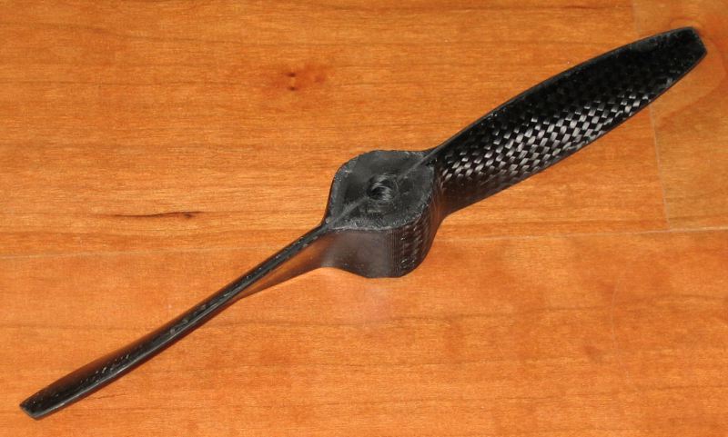

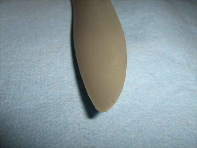

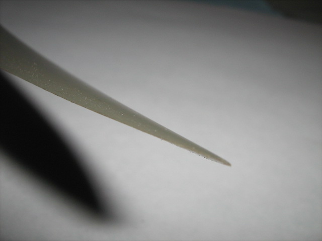

I hope the prop images below clear up what I meant by 'chopped'...
If the blade tips are 'reworked' well enough, the prop should behave like a production prop, with a high pitch-to-diameter ratio.
As to the last statement; I did not mean a shortened prop. Not necessarily.
I meant any prop that has a high pitch-to-diameter ratio; whether a production unit, or one like you had modified.
Until the 'vortex' builds up, the blades in their entirety are stalled; producing a lot of turbulent air and noise, but very little thrust...
With props that have a pitch-to-diameter ratio, which is high enough, this vortex may never build up in static, or slow flight conditions.
Only as flight speed is increased dramatically, does the prop begin to 'blend in' with its surroundings, becoming much more efficient.
See the full size Mustang, Hercules and Bear and notice the dramatic pitch at their blade tips, in high-speed flight...
At take-off, the pitch they all use is much, much flatter...
