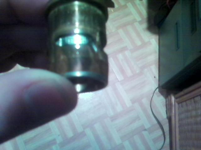

The reason for not putting a mirror polish on an intake port is so the fuel mixture will not strike it and adhere. If the port is slightly bumpy it makes for slight turbulence that keeps the fuel in suspension.
However eliminating sharp edges and unwanted bumps will give up a lot of horsepower. I do it all the time.
Ihave a ported and polished Thunder Tiger GP42 that runs awesome. Of course Ihave never seen a Thunder Tiger GP42 that didnt run good.
Ileave the inside of the liner alone but make some slight mods to the outside. Ever see an Irvine liner? has cuts in it like the RC car guy engines.
I will try to find a photo.

Here is an Irvine liner, factory as far as Iknow.
ID:	1375430   Click image for larger version

Thats not the OSterised version is it?
Old 02-10-2010 | 12:28 AM
jeffie8696's Avatar
Joined: May 2007
Posts: 5,299
From: Muscatine, IA
Default RE: Evolution .60NX with Jett Stream Muffler
Nope, never even seen one.
