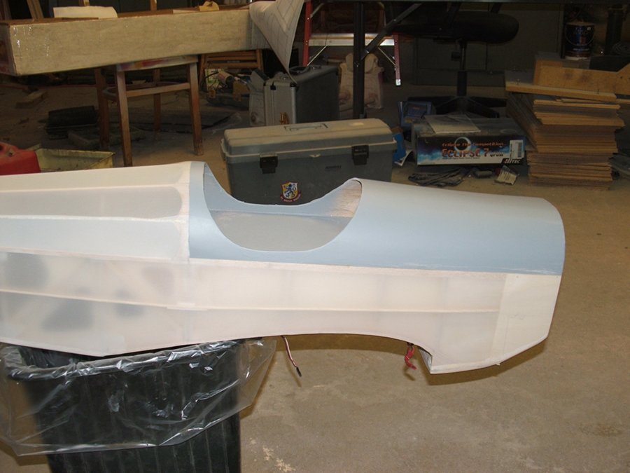

I am trying to replicate the appearance on a full scale SW at a local airport. Most of the weave has been filled on the fabric portions. I have replicated the metal portions with fiberglass - see the photo. So I was planning to use the baby powder to fill most of the weave and keep the weight and number of coats down. What do you think?

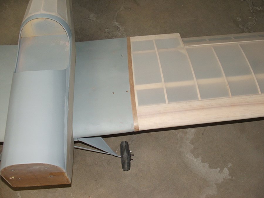

On my Spacewalker, I used Solartex. The weave was filled, in the same area as you have in primer, with epoxy finishing resin.
By spraying 3 color coats, using no primer, I found the weave to be nearly filled. In areas where the trim color was added, (3 more coats) the weave was completely filled.
You may find that Solartex will be an easer solution to your problem
