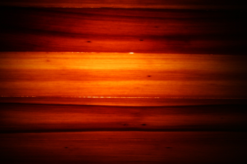

I'm looking for a way to trim plank sheets so they match up well when glueing them edge to edge to make wing or fuse sheets.
If I use a straight edge to trim each edge the blade will often tilt and I don't get a 90deg edge. Depending on the grain, the blade sometimes rips the wood away from the straight edge. If I stack two sheets this problem is even worse. A balsa stripper will give me a 90deg edge but the edge needs to be straight, and I want the two edges to match.
I'm sure there's a clever way to do this, but I'm not clever enough to think of it.

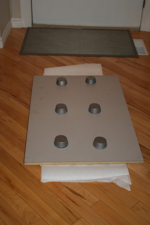

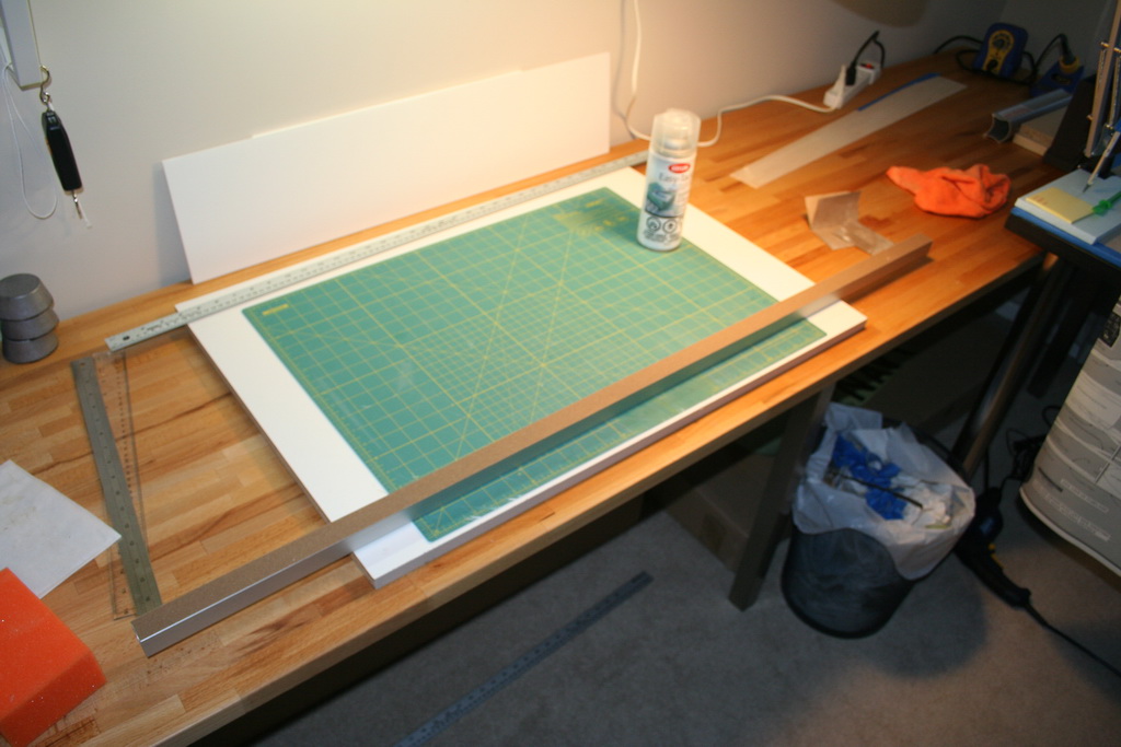

Thanks a lot for the help guys. This is one of those topics that I could google all day and not find an answer to. After an excessive balsa dust in the home fiasco this weekend (sigh) I was hoping for a solution that didn't involve sandpaper but I picked up a 4-foot 1-inch square aluminum tube, spray tacked some 150 grit paper on one side, clamped it to my bench and used some smooth foam board to raise the balsa a bit and make it easier to slide back and forth. Works perfect and stores away nicely. The only improvement would be to build a grip to hold the balsa down firmly as documented in the airfieldmodels link above.
Gap-free sheeting finally. Thanks again!

That's the method I was trying to remember skeeter - no sandpaper! The #11 carbon steel Swann-Morton scalpel blades and handle I got yesterday should cut like butter through two sheets at once. And now I can go ahead and cut the 1" sq tubing into 2" and 3" lengths to be filled with molten lead to serve as weights on my new 4'x7' 5/8" tempered glass bench top.
