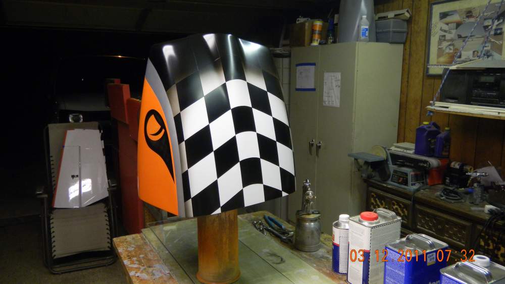

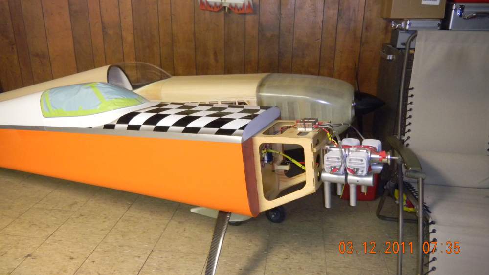

The only thing I want to know is how you paint all that checkerboard. ??? Do you put down the lighter color first and then spend the next six months to a year applying individual checker masks? Use frisket and cut in place? What's the secret?
Old 03-13-2013 | 04:24 PM
  #52
sensei's Avatar
Posts: 2,829
Received 17 Likes on 15 Posts
From: SAN ANTONIO, TX
Default RE: Painting with auto paint questions
LOL. I sprayed all the white base coat first, then I made aluminum templates by hand, then I placed wide hard backed 3M masking tape down on a piece of glass and cut all the checkers, placing them in position one by one, next I sprayed all my black, then I carefully peeled all the tape checkers only and fogged a touch of black around the edges, next I peeled everything, cleaned and clear coated. Here are a couple pictures during the base coat.

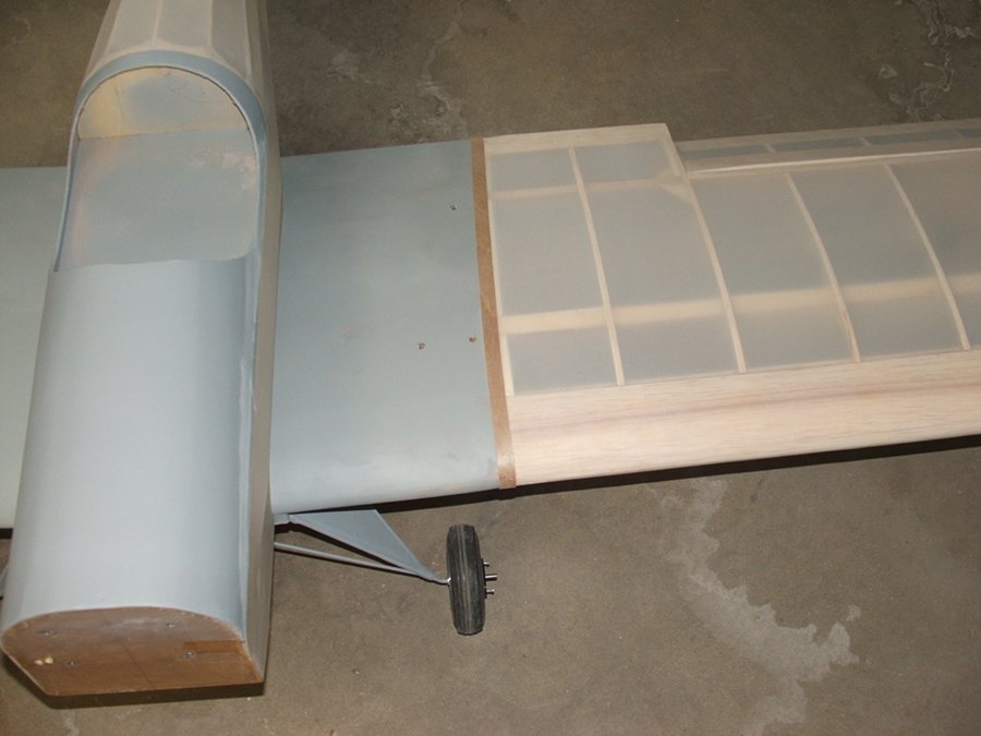

The open bay areas, I cover with Stits covering system, the sheeted areas I cover with 3/4 oz. cloth and Minwax oil based urethane, I then prime fill the entire airframe as I would an all composite airframe and prep for topcoat.

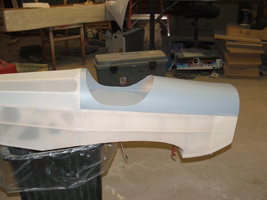

I covered my Spacewalkers with Solartex, a similar product to Worldtex.
I sealed the weave, in areas that were simulated metal, using Minwax Polycrylic, and then primed them. Open bay areas were not primed, just painted with the color coats.

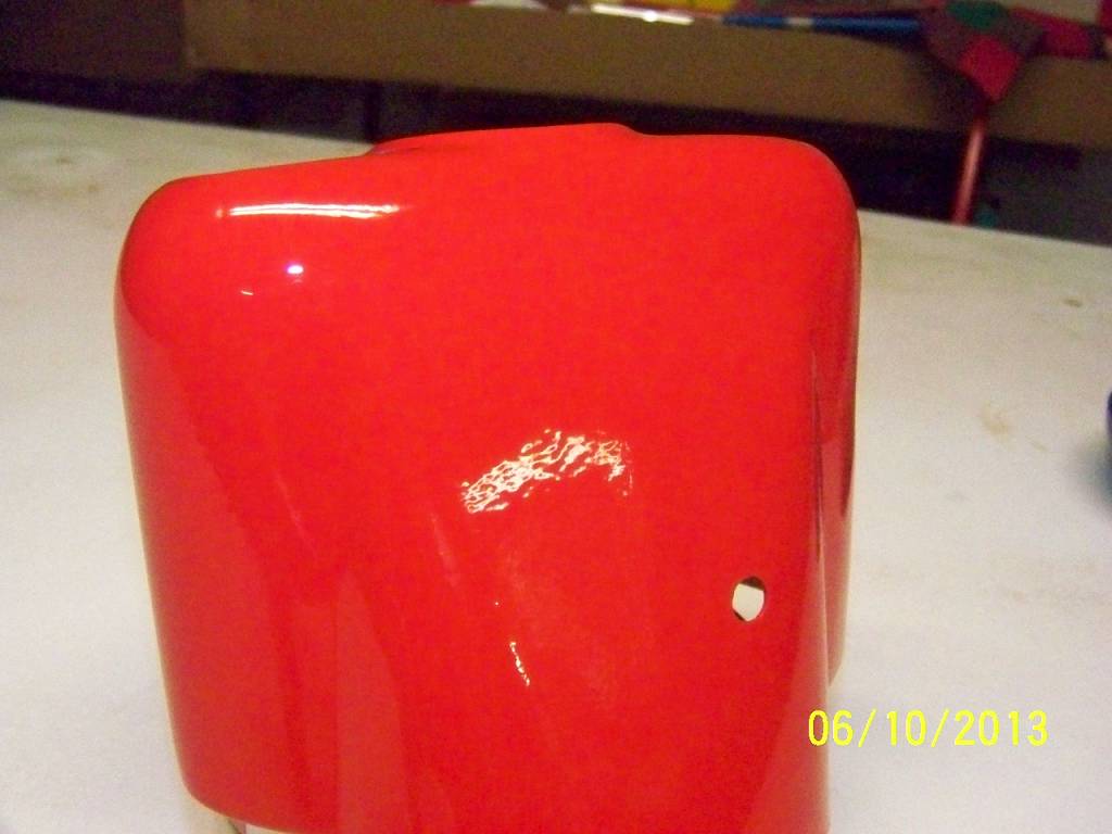

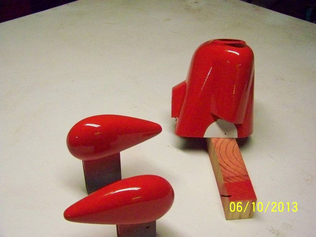

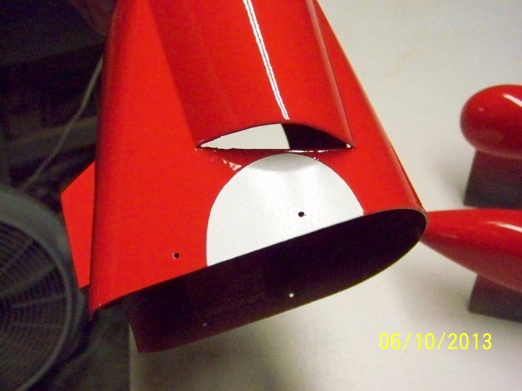

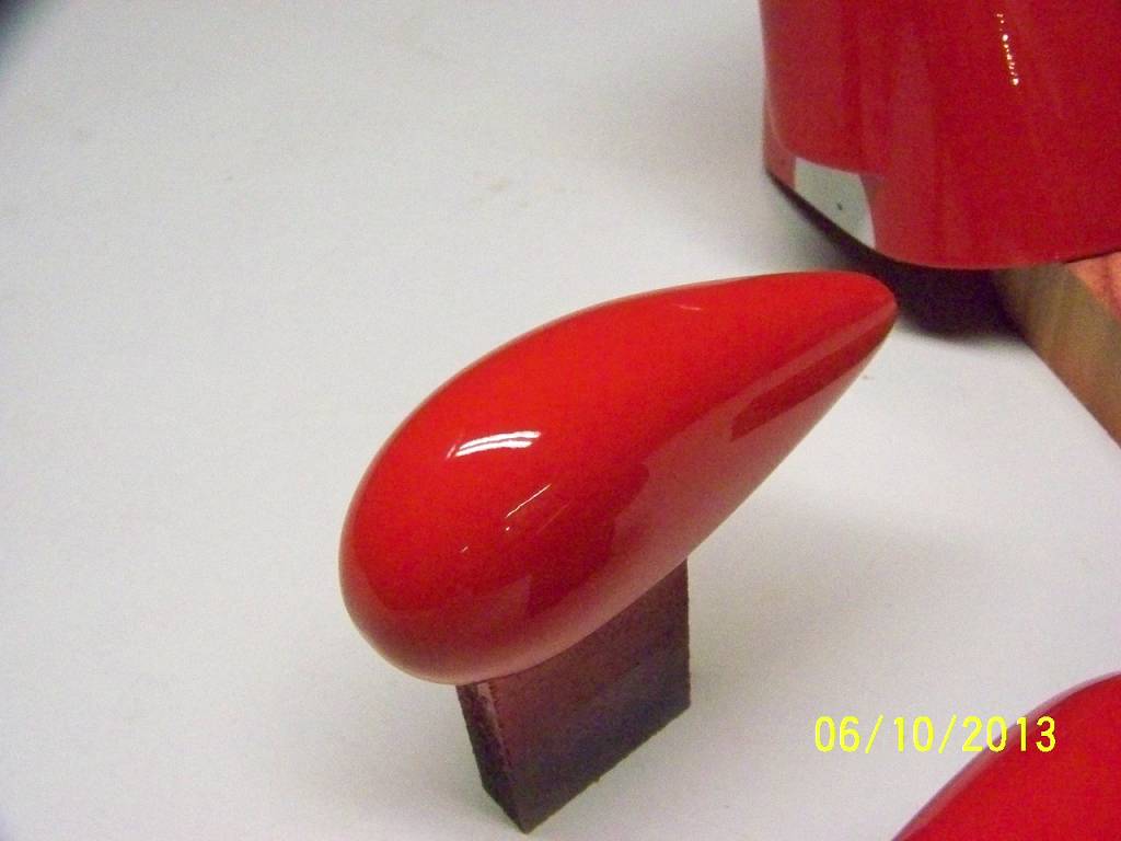

Well I finaly got around to painting my cowl and wheel pants today. It was a lot easier than I thought it would be. One thing I figured out real quick was that a little goes a loooooonnnnnnnggggggg way. I mixed up 6oz of color following the manf. instructions. After the first coat on everything I was sitting there looking at my handy work, patting myself on the back when I looked over at the Preval sprayer. There was less that a 1/2 oz gone. After 3 coats there was still 4.5 oz left. I vaccum sealed it in a pint mason jar. I then proceded to do the clear coat, appearently the first time didn't sink in. Again after 3 wet coats I still had 3.5 oz left over. Again I vaccum sealed it in a pint mason jar. I hope my wife doesn't find out how I used her new $300 vaccum sealer.
I think it went well. It took me a couple of coats to figure out the difference between a wet and a dry coat. Dripping off is wet, hehe, maybe too wet. Oh well, you'll never see the runs at 60 mph.
How long will the extra paint and clear last sealed in a jar?
Can I spray more clear after it has cured? When I finished I spotted a potential mistake. The cowl is red and white. I painted the white first a couple of months ago then masked it off and that is how it's been sitting. My intention was to paint the red then peel off the masking tape before I sprayed the clear. That didn't happen. Can I spray another coat of clear later? I know that when I peel off the tape there will be a ridge line where the tape was. I would like to wet sand the ridge line and spray another coat of clear after everything has cured.
The Preval sprayer worked really well, I figured out it's better to have enough sprayers for each color and the clear. Now that I've seen how easy painting is I believe I'll invest in a paint gun and compressor.
I'll post some pictures later after everything has dried and can be handled.

A couple of pictures if they'll load. My camara does not seem to like red too much.
The temp in my shop was 72 deg. and the humidity was 65%.
