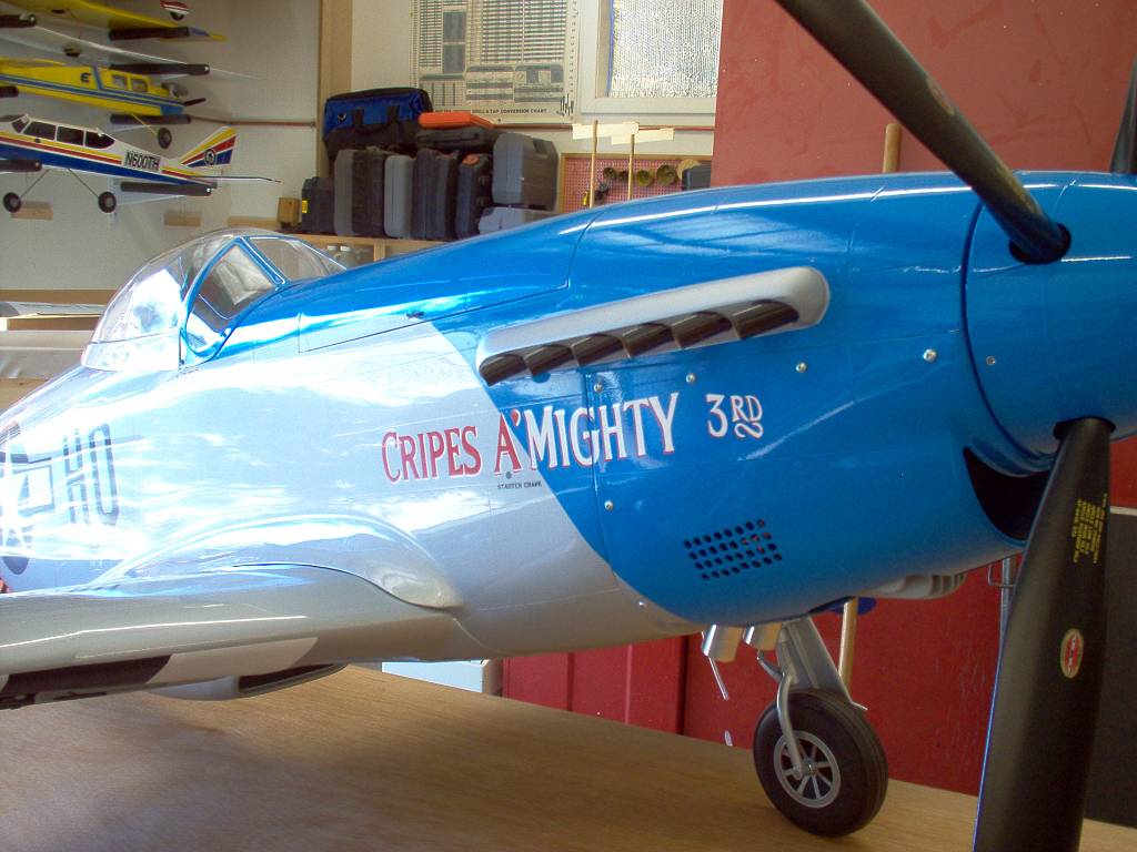

Have you thought about using latex exterior house paint? Roy Vaillancourt of Vailly Aviation has a whole write up on how to do a latex paint job. The good thing about latex is .. you have several chances to get it right. If while painting you mess up, just use a wet sponge and wipe off the paint and start over. With auto, it may look better but you only have one shot to get it right. There is no wiping off and starting over. You could wait until it dry and sand it off. Another good thing about latex, you could finish painting a plane in one day or just a few hours depends on your scheme. The clear , some say should go on when the latex is fully cured which takes about a week. But in terms of looks latex painted warbirds look fantastic. Do a search and you will see, and it is a hell of a lot easier to paint than auto paint also minus the smell.

Sparky you need to keep it as simple as you can because of lack of any experience. What I have to offer is a simple and inexpensive way to get a quality paint job from a beginner, it's a good way, not the only way. You are on the right track for the glassing and you could also use nitrate dope to put the 1/2 or .75 oz glass on and fill it with dap light weight spackle, it sands nicely and is lighter then resion. Primers I use are grey Dupli-Color high build for starters, most of which is sanded off and followed with Dupli-Color white sandable primer which I wet sand with 600 grit for a beautiful surface which will accept any paint. Vacume it well and wipe down with a paint Prep solvent prior to the color coats.
Dupli-Color Has base coat colors in spray cans with good color selections, called Perfect Match $7.00 per 8 oz. can and it goes on very smooth, easy for the new guy and experienced as well. It is compatible to most clear coat automotive paints which are fuel and chemical resistant as that is what you will want to finish with. An automotive supplier will help you with the right clear coat, get an economy clear coat and save money, they do a nice job. Keep in mind you will need a spray gun HVLP is great for this, most cheep guns will have a 2mm or larger tip where as a 1.2 to a 1.7 is desireable and air pressure 10 to20 lbs.
If you have the compressor, filters, regulator and right spray gun you can do a nice job. Clear coating can be challenging for the new user but it's doable even for the beginner. Regardless of what products you use I wish you well. Leroy

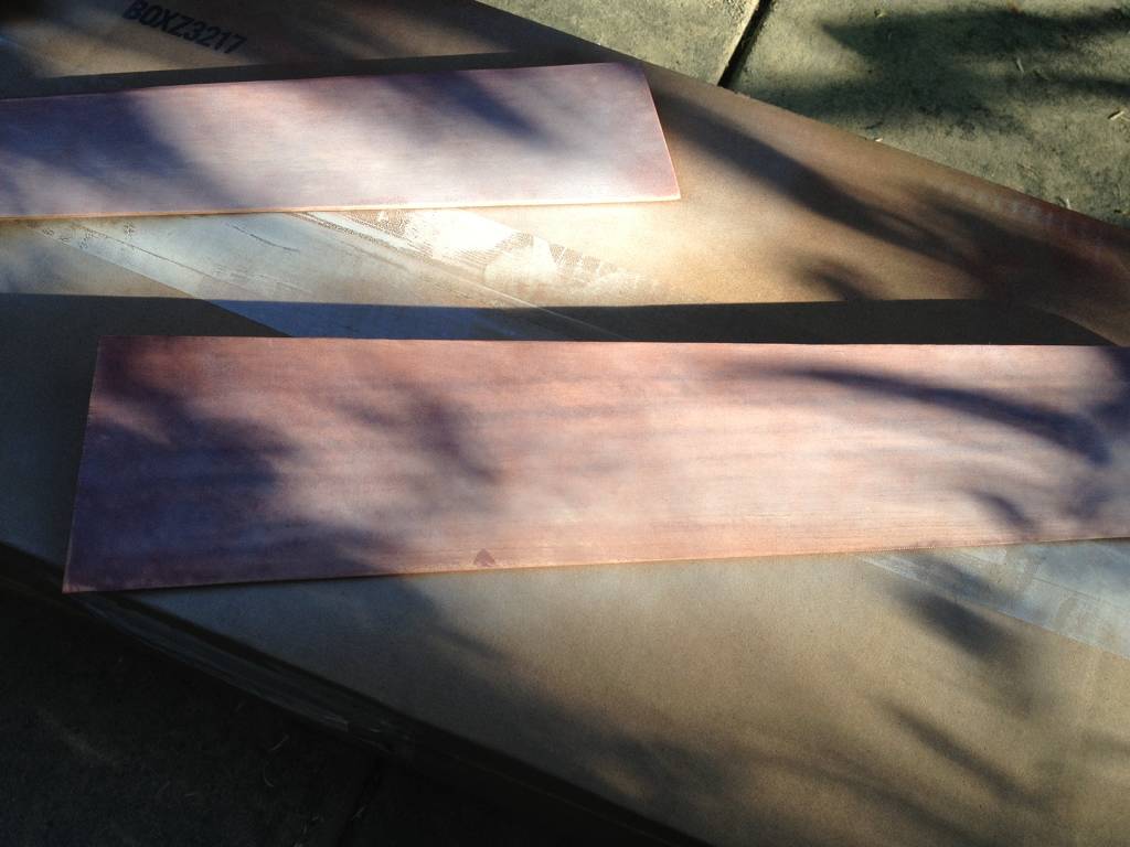

Leroy... I've run into an issue... I'm using the DupliColor high fill primer (as directed). 3 coats, 10 minutes apart, wait an hour and then dry sanded with 220 and then wet sanded with 400.
next day I put on 3 coats of sandable white primer... it looked terrible. did not cover welll at all... I wet sanded most of it off. The resulting surface is highly polished but a mix of the ruddy red from the highfill primer and white streaks from the second primer.
do I paint on that?
DupliColor Ford Blue and Ford White.

If your paints are not transparent then your base can be a bit blotchy and have no effect on the finish what so ever. There can be short cuts for painting a RC plane or anything else for that matter, I just don't use them and doing it as cheep as you can go generally will lead to problems you don't need at this stage. Sounds like your ready to paint, always paint the light colors first if possible, you'll do just fine.
