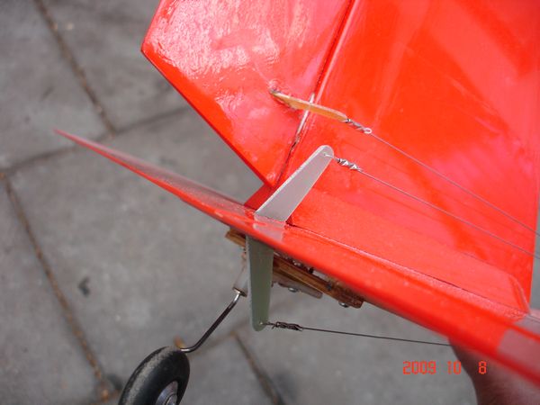

I an setting up a pull-pull rudder on a Phoenix Extra 330S, and have never done a pull-pull set-up before. The instructions say to use crimping pliers once you feed the cable through the crimp connector. I don't have crimping pliers, but should be able to make the connection with needle nose pliers. My question is whether or not I should solder the crimp connections? This would give me more confidence in the connection, but I wonder if the heat would weaken the cable near the connection. I really don't think it would, but I'd really appreciate some input from somebody with experience with this type of connection. Thank you in advance for your helpful response.

You never solder a crimp connectror!
Just use a cutting plier and carefully crimp two or three times on each connector tubing.

I , as jaka, use wire cutters with the cut edge ground flat just enough not to cut.

Yes, a pair of Dykes (cutting pliers) work well. You do not even have to dull the edge, just go easy on the force you use. If this is your first pull-pull system here are two very important things to watch out for. First, make sure you do not have any negative Ackerman induced in the setup, positive is okay as long as it is not excessive. Second, do not have the lines to tight, just enough to have no slack at neutral position. If you do not know what Ackerman is, you can Google it or do a search for it here on the forums. It is the relative placement of the attach points on the servo arms/control horns relative to the pivot point of the servo and moveable surfaces and how it effects line tension as the surface is moved off center.

I don't have crimping pliers either. I used to use the side-cutters on pliers VERY carefully and it worked fine. Now I use round-jaw pliers and put in the three crimps that combatpigg mentioned. I also crimp slightly diagonally to make each crimp slightly longer. No failures or cables broken at crimps but I don't honestly know if the diagonal is a good idea or not. No problems though. I don't do anything additional - no glue or solder or anything else.
