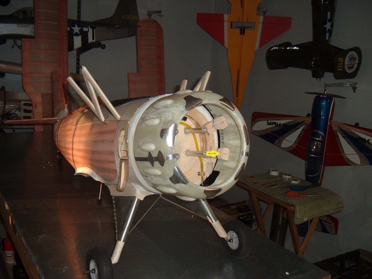

Im am looking for ways to mount my cowl of my corsair with a Saito .72. I want to mount it without screwing it in from the side of the cowl if anyone has any ideas let me know.

I use magnets, here is a sample from my Waco. The fuse side and the cowl side both have magnets, very strong. I did the Corsair 60 size and giant the same way.
