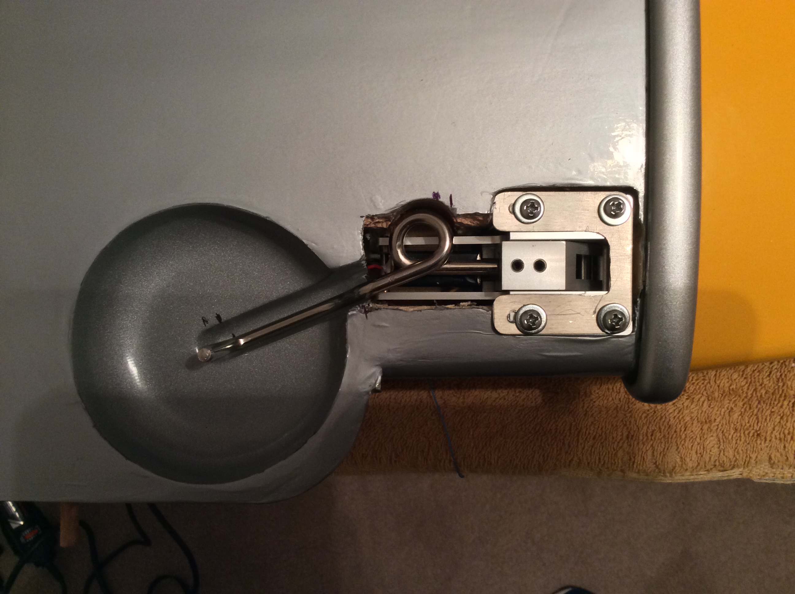

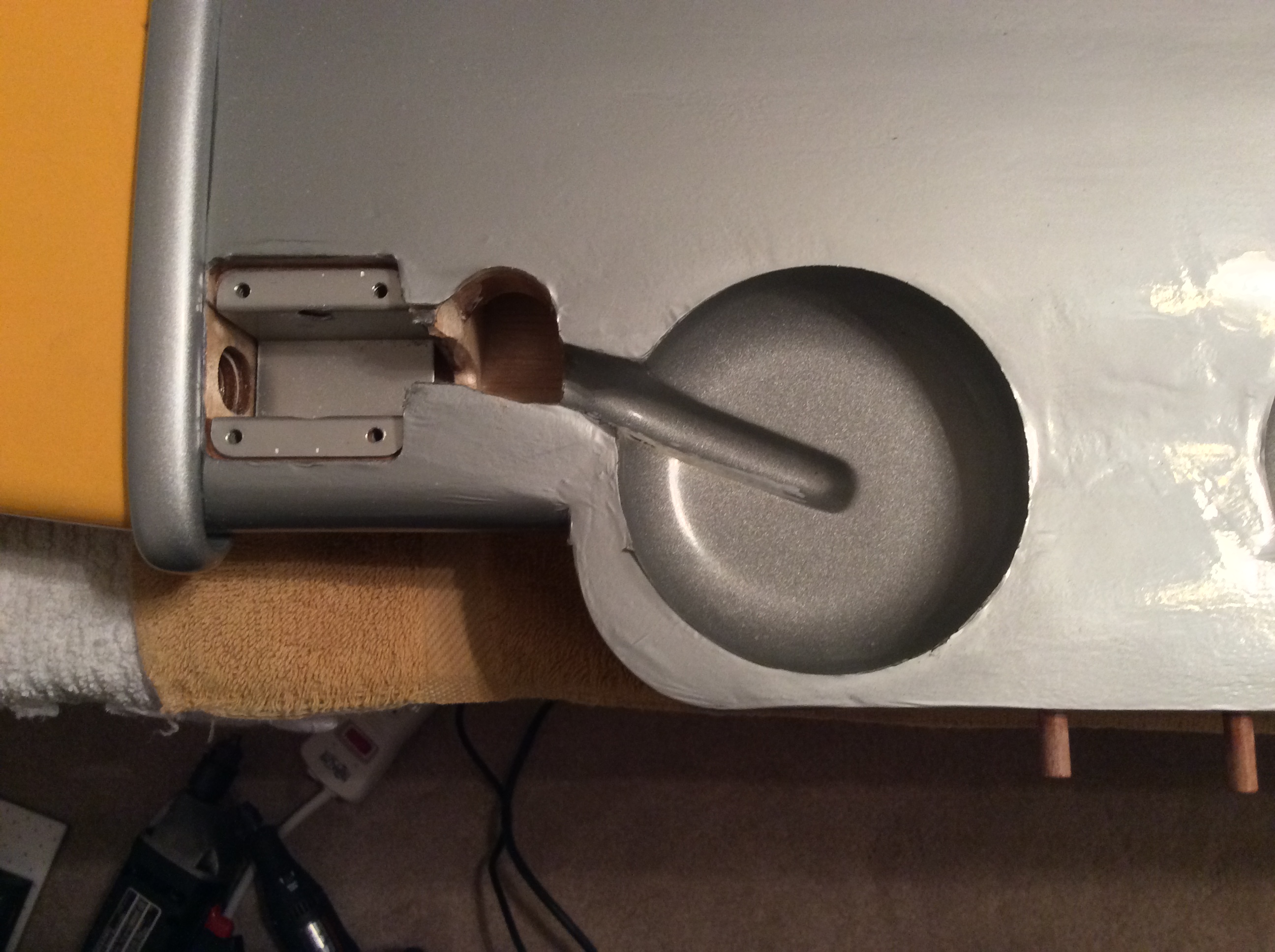

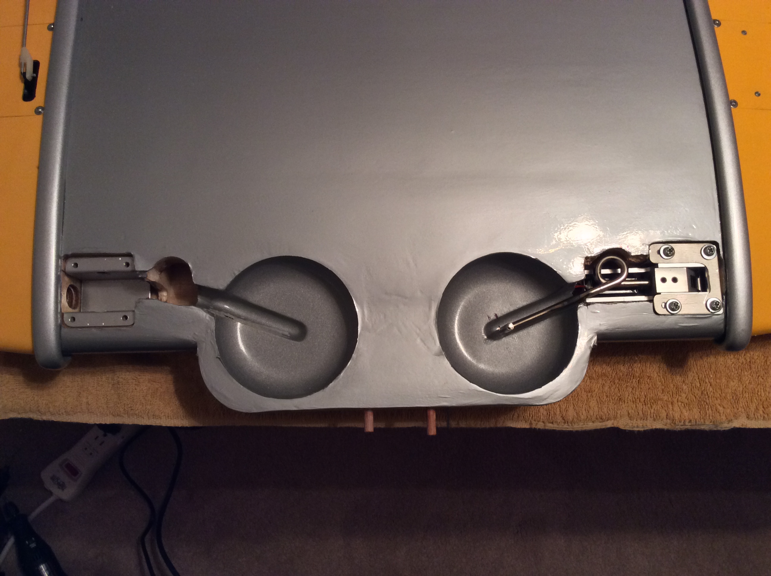

I am installing E-Flite 60-120 90-degree retracts in my Top Flite AT-6 ARF instead of the mechanical retracts which came with the ARF. Here are some photos which show both the "surgery" I needed to perform to fit the E-Flites, as well as the use of Tom Treese's metal inserts for increased strength and stability.
