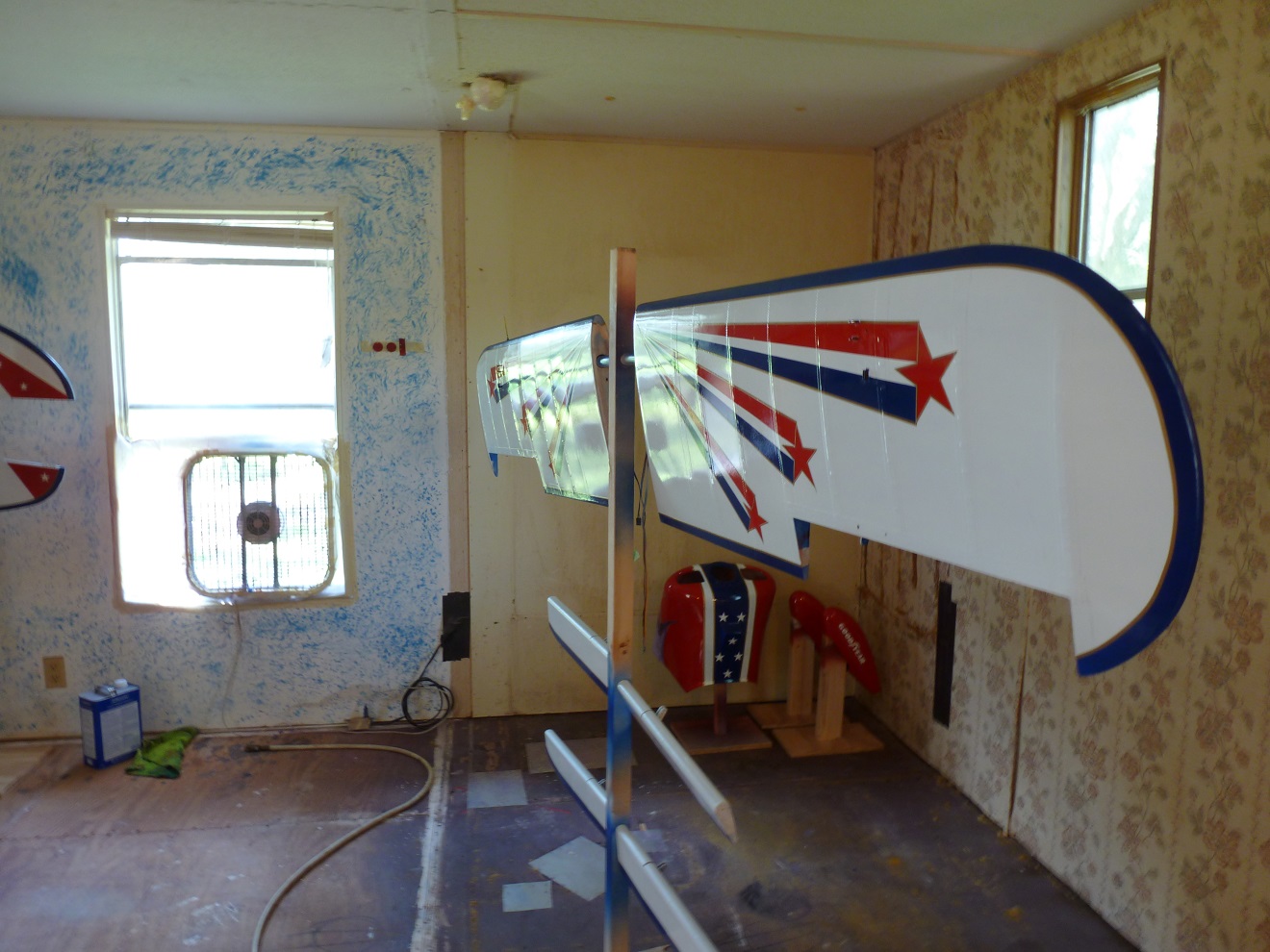

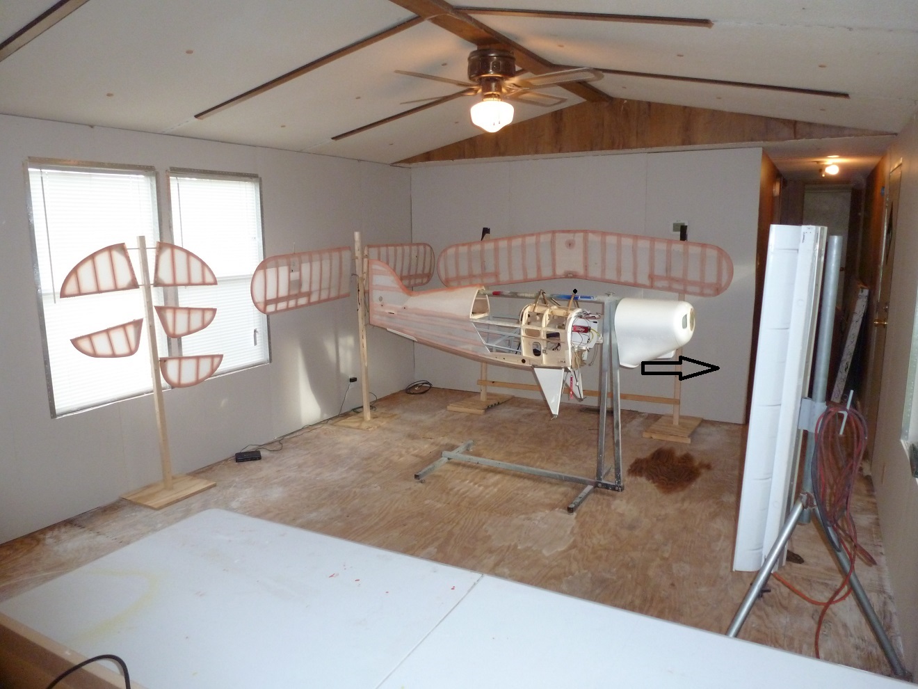

I use a backlight to the surface to better see the shine as it sprays. A window can be used as in the first pic or rig up a light to do the same job, a shop light mounted vertically works real well like seen sitting in the second pic. A straight on view usually ends up to wet before our eyes see it.
