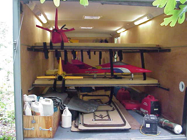

and.....another

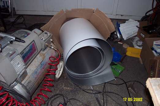

[If I had it to do over again I would have used sheet metal siding instead of wood]
Your trailer is looking real good, you've done a great job. as for the wood finish, You can still fix that if you wish.
My trailer is made of plywood also, but I am covering it with prepainted aluminum that I purchase from the home renovation center. I start from the back and on forward by overlapping a bit. The way I attach it, Is to use aluminum pop rivets.
Since I'm in the process of doing it now, I can take a few photos and show you how and the finish.

I beleive it would add about 10 lbs for your size of trailer.
I will be taken pictures either later or tomorow.
Old 05-17-2002 | 11:41 PM
  #61
Forgues Research's Avatar
My Feedback: (7)
Posts: 3,453
From: Glen Robertson, ON, CANADA
Default photos
Here are 3 in row photos, I can take more if you wish

alright thanks I got the idea now. Next I need to find out where I can find it at.

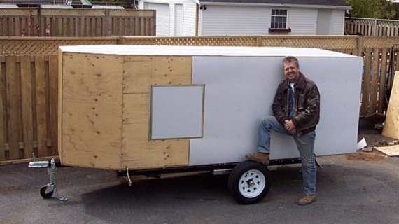

Here is the trailer, not finished but with the box on top of the mechanics.

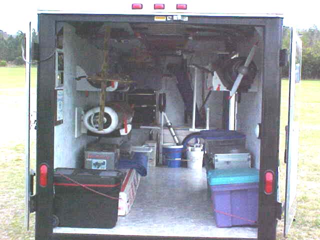

If you want to see trailers, the place to be is Joe Nall. Hundreds and hundreds.
I just returned and from receiving many positive comments, feel this is the best way to effectively utilize the space inside your trailer.
Mine is a Wells Cargo (the best, but pricey) 6X12 single axle. I tow it easily throughout Florida and the SE with a small V6 pickup or a minivan.
I fabricate former cutouts (from the A/C plans) onto 5/8" plywood cradles, which are securily bolted (NOT SCREWED) to heavy-duty shelf brackets. The brackets are bolted and/or screwed into the steel vertical framework of the trailer.
Of course heavy padding is absolutely necessary in the cradle.
This system allows me to easily transport 4 giant warbirds (like a Meister P-47 - huge!) yet still have the floor open to walk into or place additional equipment /planes.
The wings are supported in the traditional fashion-horizontal rails across the width of the trailer.
Forget about bungee's. Not only do they weaken, they are extremely dangerous. I remember a story of one snapping back into the face of some unfortunate individual and him losing an eye. Purchased several yards of velcro and loop it through electrical conduit hangers ( cowboy clamps for those in the trade) taht get clamped onto the rails.
Good Luck,
Nick

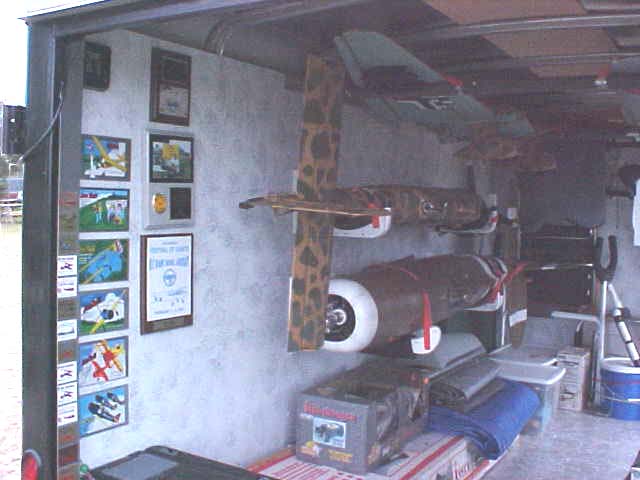

Pic
