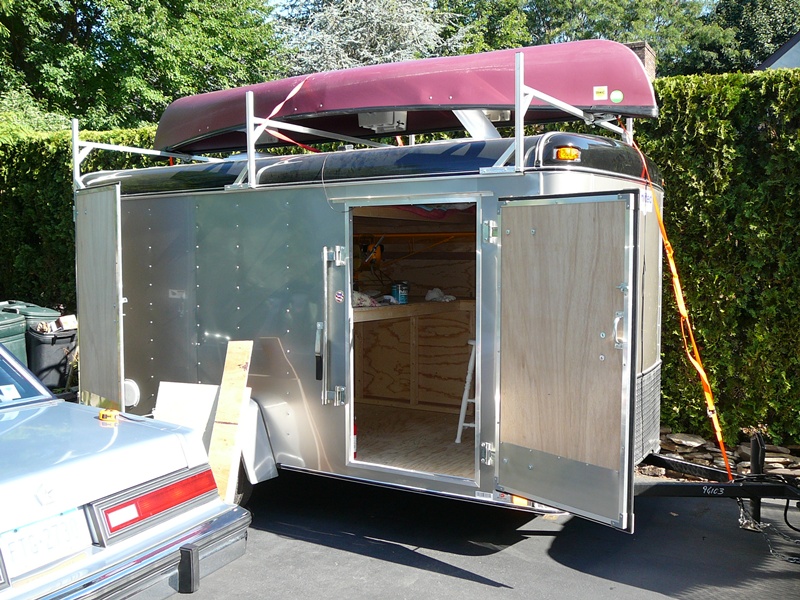

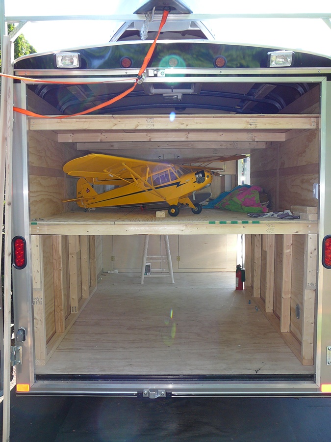

Here's my new 6x12 trailer, trying to reduce tongue weight now, will put spare tire on roof rack at rear end, that should help.

Silver, very nice.
The canoe, is that for float flying?

Canoe is, and all of this was the result of seaplane flying.canoe.trolling motor.batteries....then fishing poles........and even some float flying. I did finally find a scale at a KMART that goes to 400 pounds so I can get a good tongue weight.
This is a UNITED TRAILER....6x12.....ordered it special with some extra vents....rear flood lites, led lites and roof rack.$2999..torsion axle

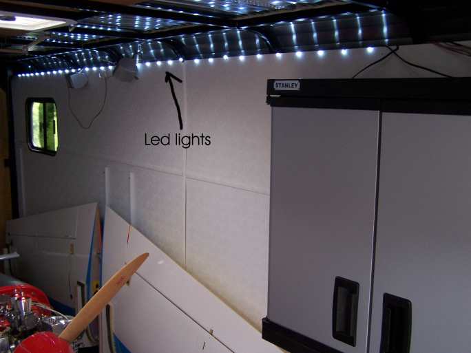

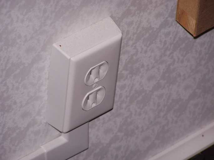

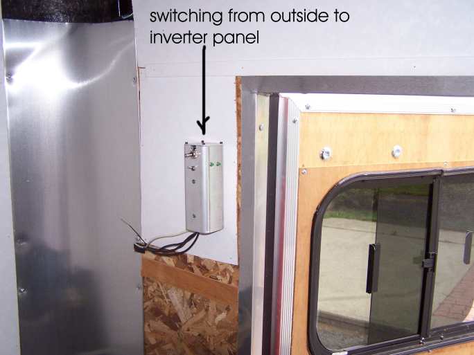

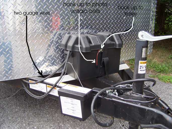

Depending on the current draw from your AC power of 110 volts, 30 amp battery side is a bit small, don't forget, 30 from the 12 volts source, will yield only 3 amps on the 110 side...
I have a deep discharge battery on the tongue of my trailer, with a 1750 watts inverter inside the trailer. The wires from the battery to the inverter are number 2 guage from a welding shop with a 120 amp fuse on the battery to protect the wires going inside.
if you draw just 10 amps from the 110 AC you will draw about 100 amps from the battery...
To keep everything charged up, I hook to my vehicle while driving , when stationary, I have a bank of photo voltaic cells of 600 ma to keep things up.
I can take pictures if some would like
As for interior lighting, I went with 135 white christmas led lights, , those are about the lowest current consumption I can get, and it looks cool
you can also install an outside receptcicle to plug an extension to feed the 110 inside the trailer , again easy to do
Hope this helps

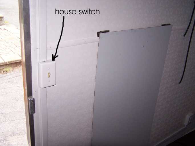

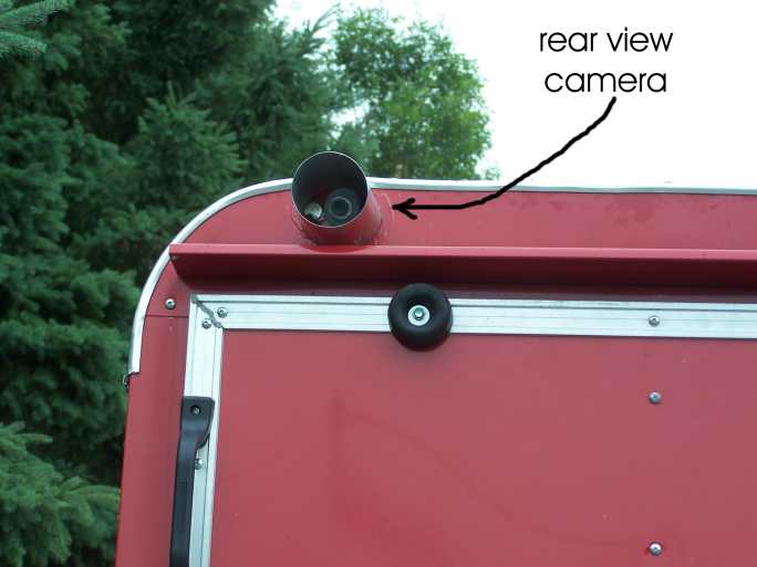

Here is some photos of my set up which of course is always in progress, not finished yet with my tiny bathroom with shower and toilette.

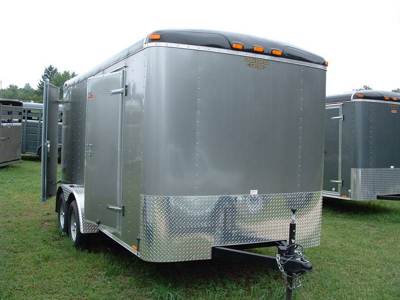

Does anyone have the spring suspension tandem? Are you happy with it?
I have found both trailers but there is about 1,000.00 difference in them (enough to pick up a small Honda generator)
This picture is a 7 x 14 tandem torsion.

I had a single axle spring setup and now have a tandem spring axle 18 foot, it is extremely smooth compared to the single axle.
Although, the torsion would probably be smoother, mine does the job perfectly..
But I do slow down on rough terrain.
