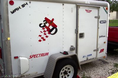

WELL GUYS THIS IS MY WELLS CARGO 6 X 10 I STILL HAVE SOME WORK TO DO BUT COMEING ALONG.

Jaybird, that trailer looks tiny in the pictures.

SORRY about that Marty I didnt know how to size the pics so Ill redo them. I didnt mean to sound smart about leaving the planes in the trailers but I live in Florida and unless you have AC 24 7 your mono cote will be history!!! Im just starting out on rc about a year now,and going to the field with planes in the back of a truck is a real pain we get alot of rain. Cant use a topper cause Im a commercial fisherman and need my truck open for stone crab traps,bait fish ,ice etc so a top would not work for me. I found this 6x10 wells cargo with tor and brakes for $1,250 and couldnt pass it up.After looking at the other trailers I am going to go with the side racks. I have heavy fish net one foot from the roof that will also hold wings nicely also 110 hookup with outside and inside plug ,generater on front when I need it Marine 12 volt bat for rechargeing planes at the feild. I never leave my planes charge overnight in the trailer fires can happen when you least expect them I dont take the chance..It does look small but not when you go in I can put my 27%yak 54,60 twist,60 cub,40 nexstar,filton byp,and two other electrics with all my gear very easly. Unless your really big into going all over the states etc and staying over a smaller trailer is the best for me.these pics come out better. HAY Im just glad I got a trailer LOL

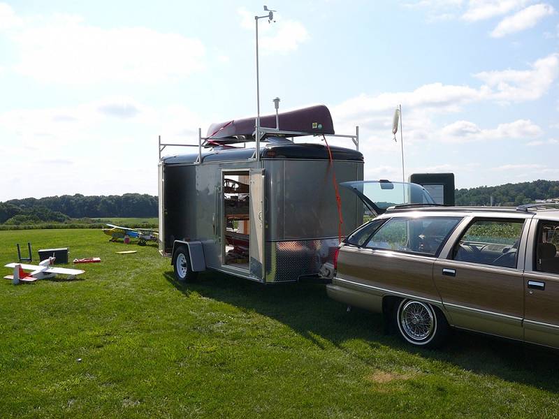

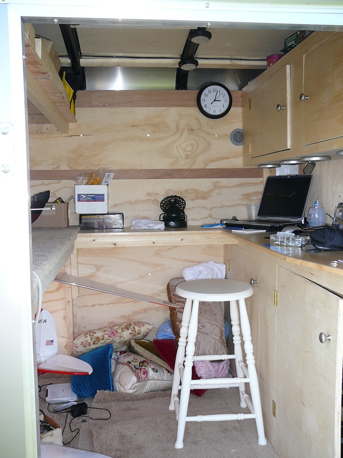

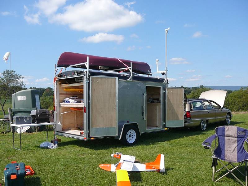

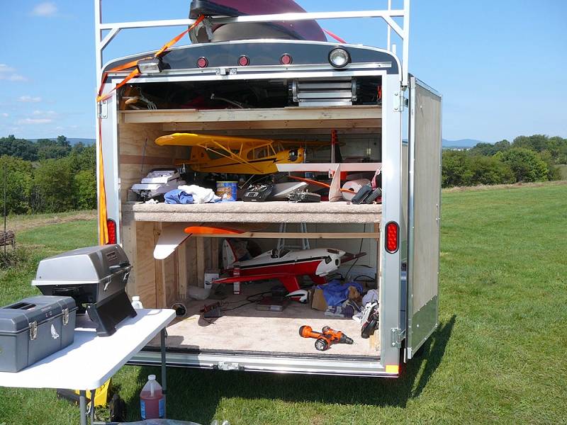

My 6x12' United Trailer, I can put almost 10 models in her plus coolers. She has a 3000lb gross and I figure I'm close to that. The tongue weight is of big concern, I'm running about 420lbs. That should be ok given the 10-15%rule, the car handles well with that weight. It's pretty hard to keep the weight out of the front trailer section with cabinets and batteries. I did add my spare tire to rear roof rack to help shift a aft moment on the cg. I have a counter top area which is great for eating, fixing stuff and kids can keep busy with drawing and such on it.
Laptop with a ATT aircard gives me internet service so I can order replacement parts right after the crash. Added tons of LED AA powered lites from KMART and a extra spot lite on side. I'm running 3 deep cycle marine 12 volt batteries in paralell to a 1400watt inverter.

Wow, that's great! I like the weather station, what is the other pole for, internet?

The weather station I bought at WAL MART for $80, smaller siren looking pipe is the temp/humidity senor. Works very well. This whole trailer deal started out of getting the seaplane flying bug. The guys fly on Tuesdays and I loved it so much I wanted to fly otehr days and you need a way to egt your model when it quits way out which it always does. That led to a canoe and trolling motor and batteries and fishing rods and models all in the back of a Chevy wagon.
The trailer also enables me to take my 2 girls along, they stay busy for hours playing inside the trailer. They can lay and watch dvd's. do their homework and just play. I usually go to the field for 10-12 hours so it's nice to have a place to sit. The interent access is nice also for weather radar maps in the summer. The nice part is when I leave the house I can go flying, seaplane flying, rc boating or all of the above. It was a well worth while investment.
I eventually plan to go to some fly in's next year in the state, the trailer gives me an option of sleeping over for weekend events.

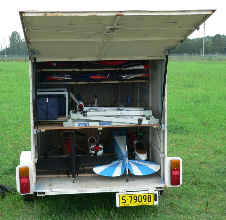

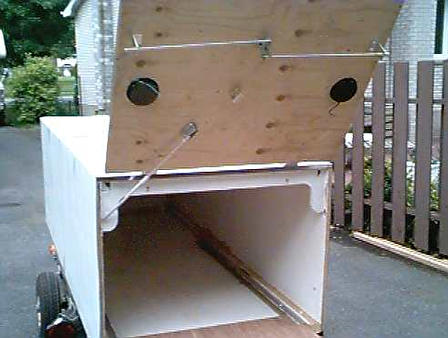

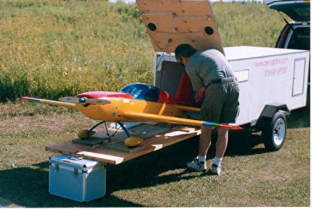

We are getting a new (to us) car and chances are it will be a sedan , we currently have a station wagon. Now I was thinking of a small box type traller approx. 4` x 4` x 7` long as I want to carry about 3 x 40 size planes.Now has any one made a tralier with slide out racks for wings and fuz, I was thinking of double doors at the back. Also would some one like to post pics of the suspension of their smaller traliers so I can get an idea of whats what. I have built normal box traliers before but the suspension is way to stiff ( I think ) tia. cheers the pope

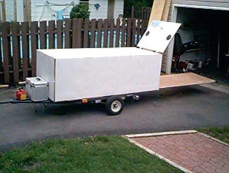

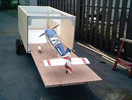

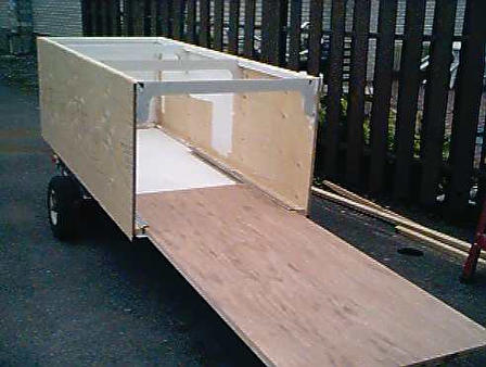

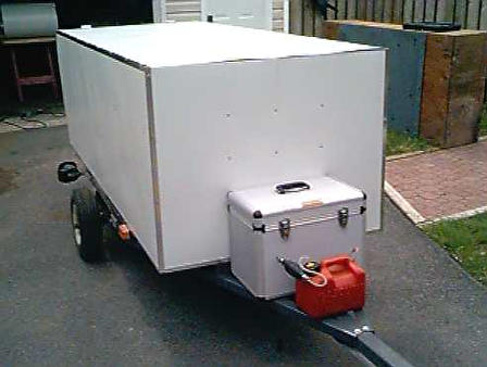

Yes I have made one, I will have to find the pictures as I dont have it anymore,
I use a Luan door as a sliding second floor...
For the suspension, these little trailers come with two leaf springs, and I removed one to make it softer and it worked .
Also I made the trailer box with 3/4" plywood t weigh it down and soften the ride.
Hope this helps

Thanks for the pics Roger, what size wheels are they? I didnt want to go to small as the new car would have 15" wheels and i hate the look of a tralier that drags its a*rse but yours looks reasonably good. Also is there anybody else with under floor pics of small traliers ?Thanks. Cheers the pope

The wheels are 13 inches so it goes quite nicely

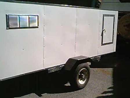

Hi Pope,
I , like you was looking for a smaller trailer. The one pictured is 8 ft Long, 4 ft wide and 5 ft high. When I purchased it there were no fittings inside and would be easily able to have a slide out system. I have seen one of these built on a 6 x 4 trailer here in Sydney.
The way I have fitted it out I am able to carry a 35% aircraft and a Helicopter on the bottom, with three normal sized aircraft in the centre and all the wings above this.
We also carry the field box and the necessary pop up Gazebo and deck chairs etc.
I tow this with either a Camry, Camry Wagon or a Celica with no problems.
The wheels are 13'' Holden. The complete trailer rides very well and it allows me to be completely self sufficient with the added advantage that the complete trailer fits easily into the workshop and the aircraft are stored full time in the trailer, even the charging before flight is done with the aircraft located in the trailer.
Any further information feel free to ask.
