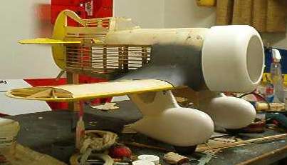

Enclosed is a picture of a Gee Bee Z I'm building.
Just the looks of this airplane makes it one of my favorites.
I always admired the resources of scale model builders and was wondering what type of ideas are here for fabricating a set of wing and tail braces for this airplane.
The designer recommends small eye hooks and elastic cord.
I like that idea for simplicity but am not having any luck finding suitably sized hardware.
Fuctionality is not necessary. Very light weight is. This is a 40 sized airplane.
All ideas would be appreciated.

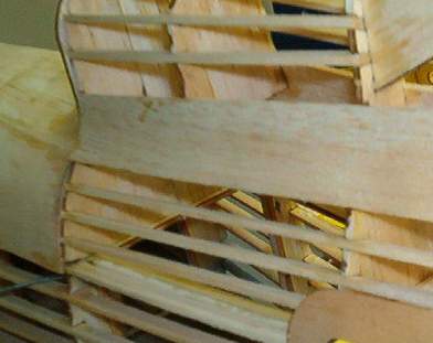

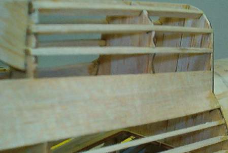

Just the solution from F5 and back, the big plankning with two 3x12mm long twisting from F5B (I think, cancopy) to the end.
Old 10-14-2003 | 05:22 PM
Zpat's Avatar
Posts: 604
From: Lima, OH,
Default RE: Scale Gee Bee Z question.
Enclosed are pictures of F5 aft.
The filler wood is 1/16 x 1" balsa.

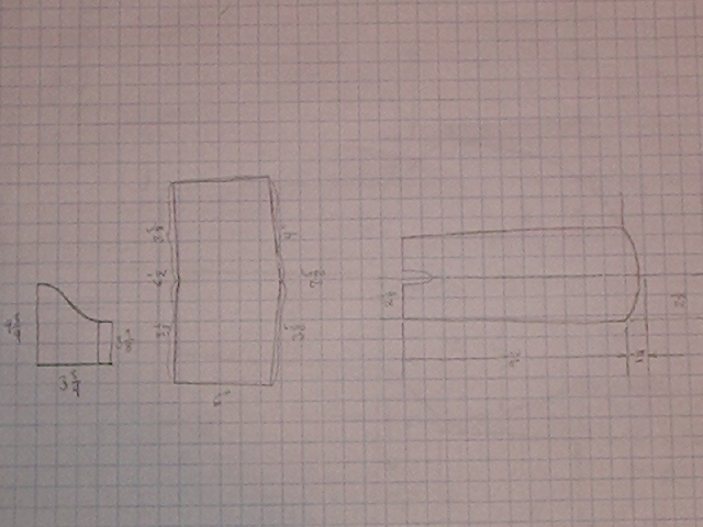

I need some guidance in covering this fuselage.
I usually don't have any problems with covering but this fuselage has me perplexed.
Can someone give me an idea as to covering the fuselage?
Old 10-28-2003 | 11:36 PM
Posts: 279
From: OH

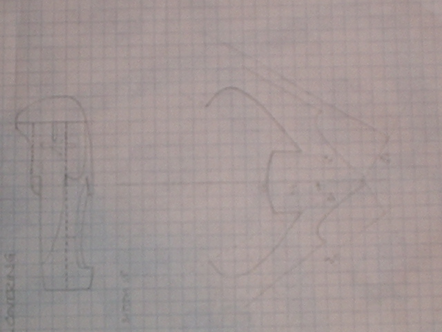

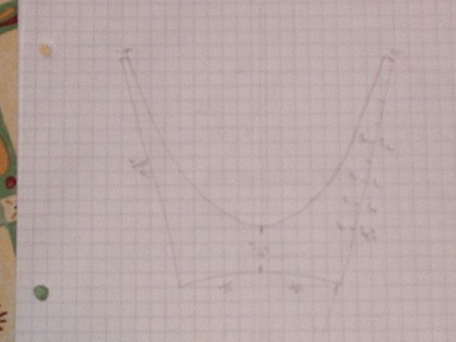

Covering was a bit of a challenge for me (this is my first plane).
I tried to cover with as few pieces as possible, starting from the bottom up, from the back forward, as I thought the seams between pieces would be more apparent - they're really nearly invisible (I used MonoKote).
It worked out quite well for the most part. I only have a small pair of wrinkles on either side of the hood.
Here are my sketches. After I made the sketches, I added dimensions by measuring the plane with a sewing tape measure, then made templates out of newspaper to try it on for size. Since you want overlap in most cases, there are few critical dimensions.
You can mess with the brightness and such to get them to show up better...

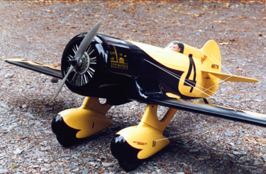

I used the ABS in the kit and it worked out well.
If I had any questions, Adrian Page responded to my e-mails in a very timely manner.
Here's a picture to help with the details.
